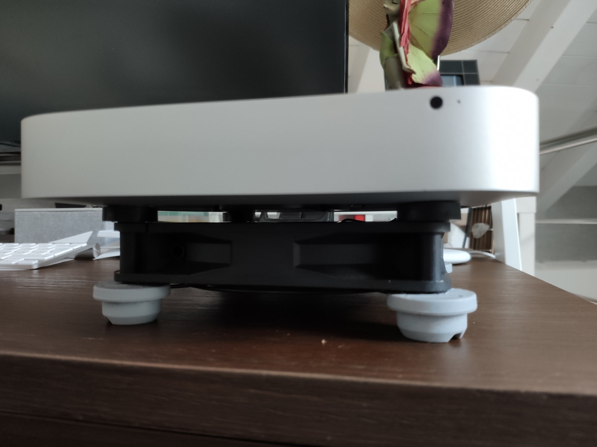

Hi guys,
here my two cents about cooling solution. I started to have some problem after display change. I bought for work a LG 34" ultrawide display with 3440x1440 resolution to replace my old 24" full hd display.
The "mini" manage it without problem (by DP at 50hz) even if officially it can't manage this resolution in technical spech. the only issue was the rising of the temperature. So i decided to start my intervention
This is a "work in progress" project.
Used materials for the first step:
- Mac mini 2012
- thermal paste Artic mx4
The original paste was dried an cracked, by the way, it has 8 years, so IMHO it's normal.
After replacement, immediately i found an improvement in termal management, but is still under pressure.
Second step:
remove the bottom cover and place the mini over a cheap cooling base for laptop (trust ziva).
Interesting results: during cinebench20, in both cases, it never throttle, but in standard configuration the internal fan runs at maximum speed (5500 rpm), and the temperature rise until 95-98°C.
Without bottom cover and the little wind, it was able to stay at 90 °C but with the fan at 4500-4800 rpm

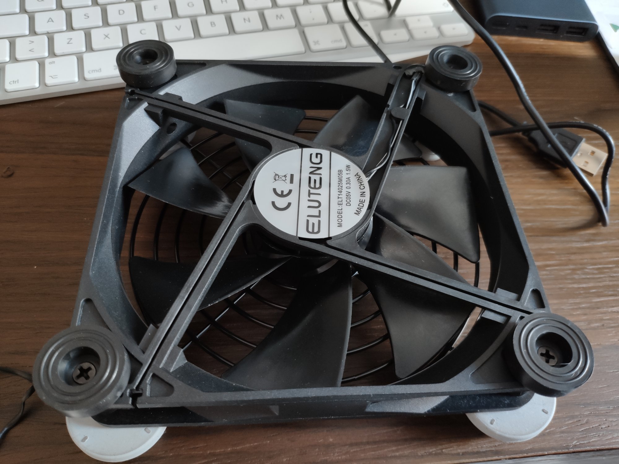

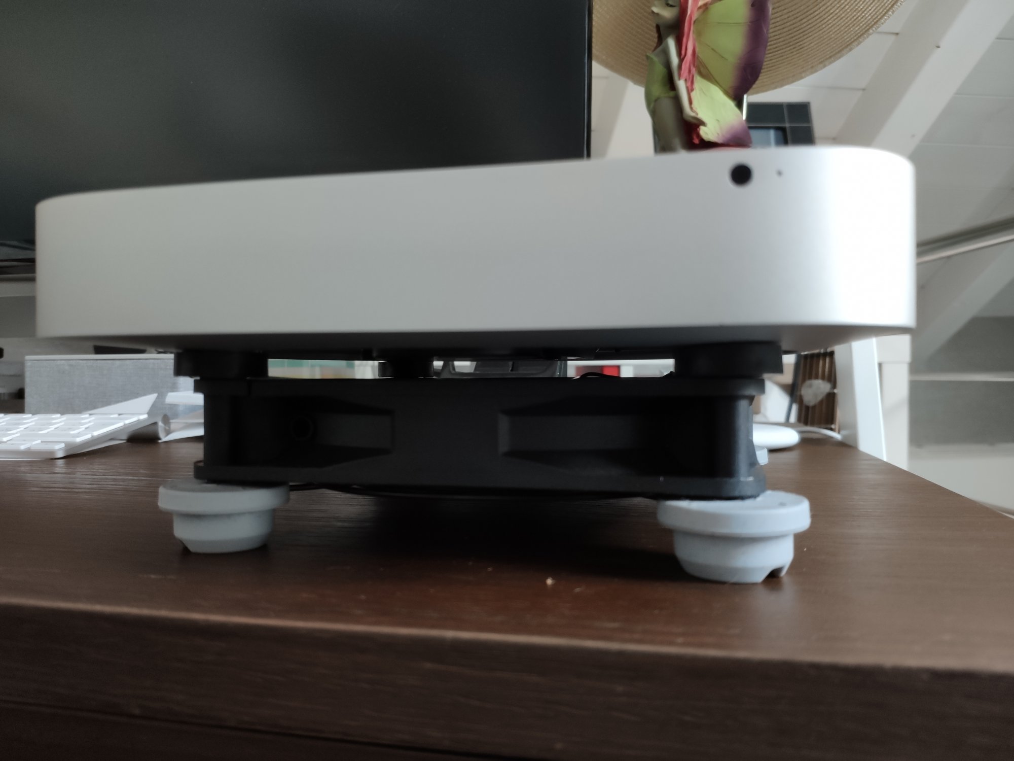

WIth this good results, and seeing the "Speedo" professional solution, i decided to improve the fan power.

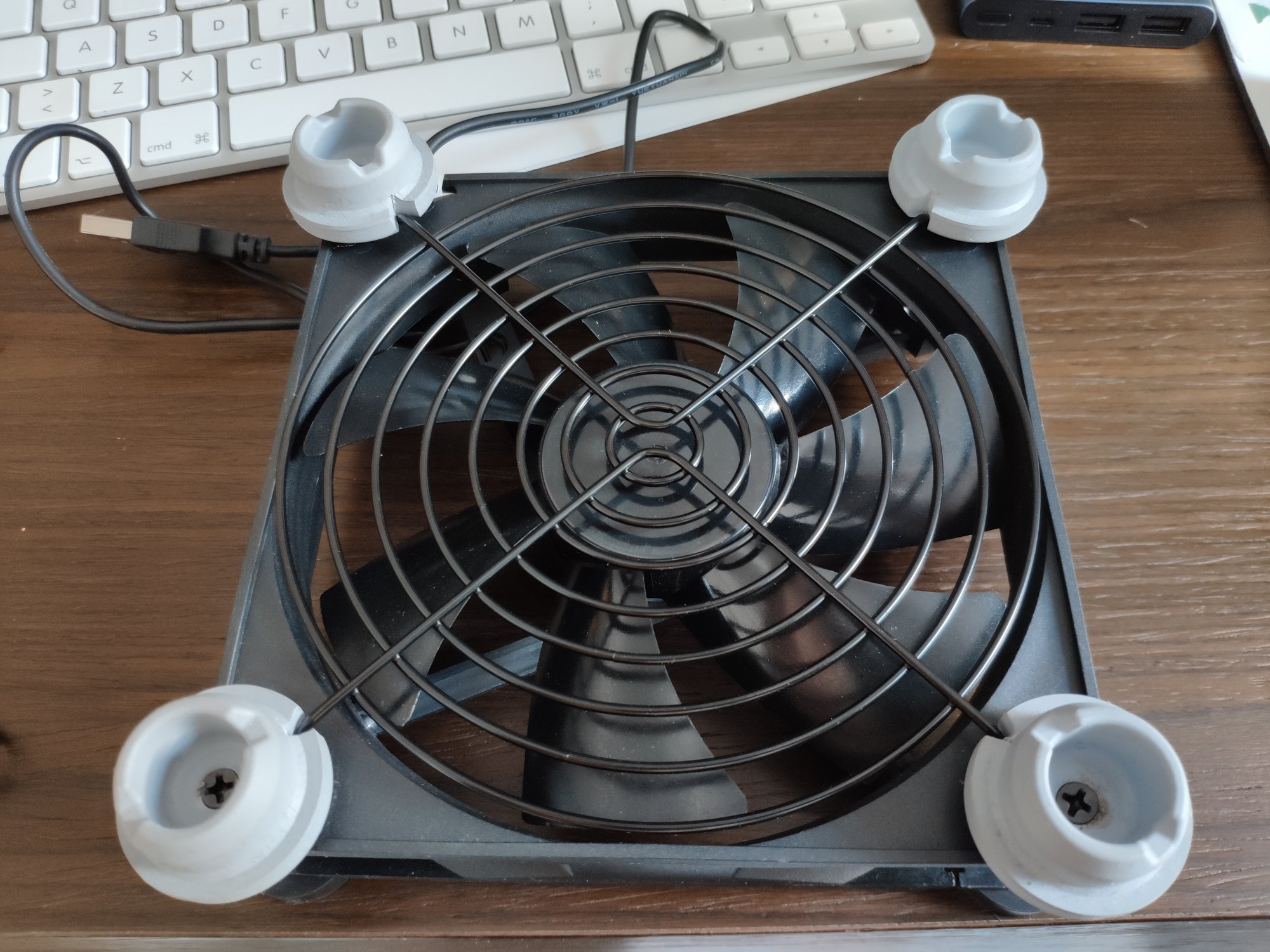

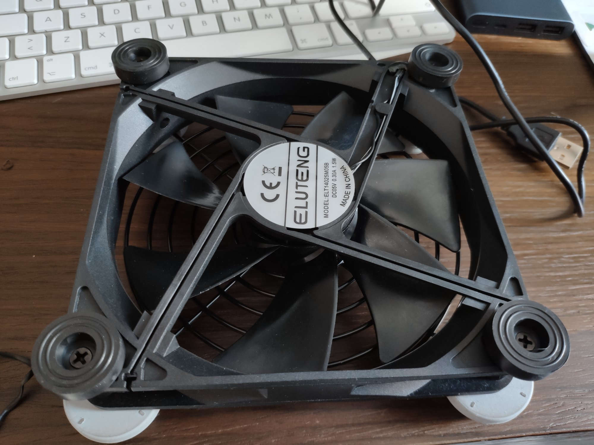

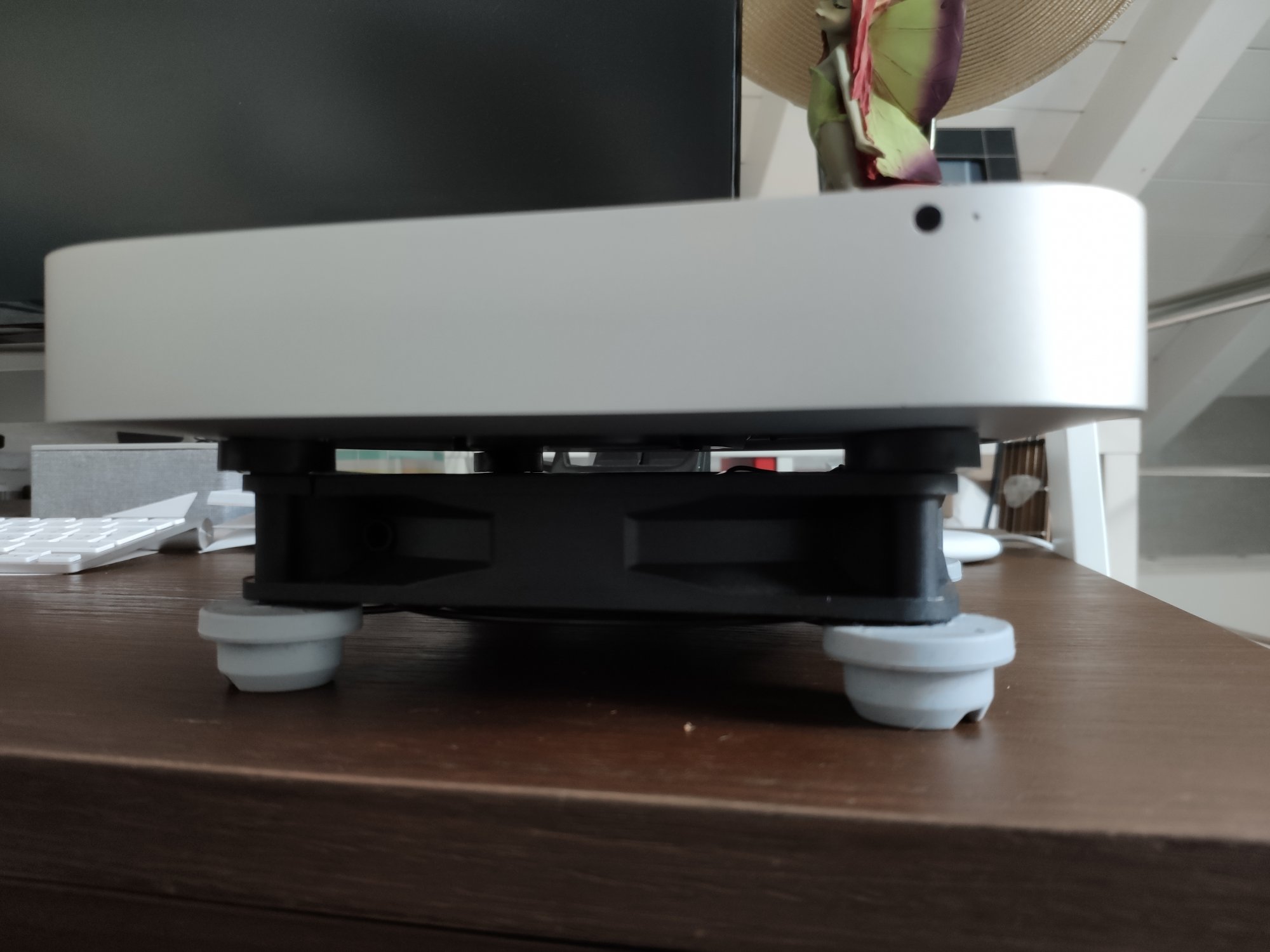

Third step, material used:
-USB fan of 140mm
-some rubber stoppers
I can't compare the results in cinebench 20 because now summer has come and in the room I have 29 °C (instead 20-22).

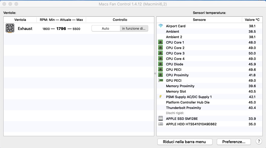

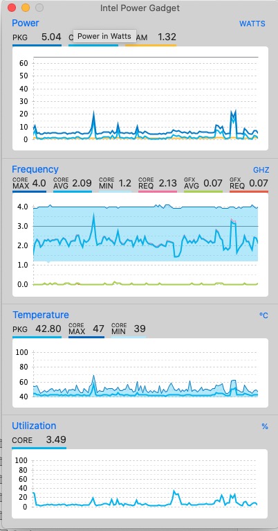

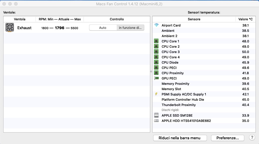

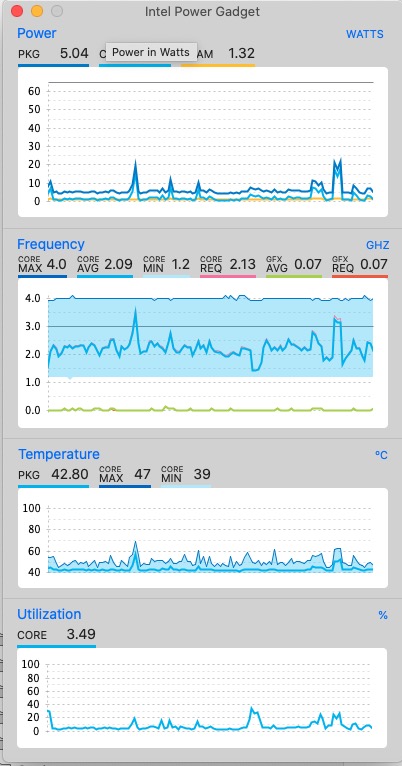

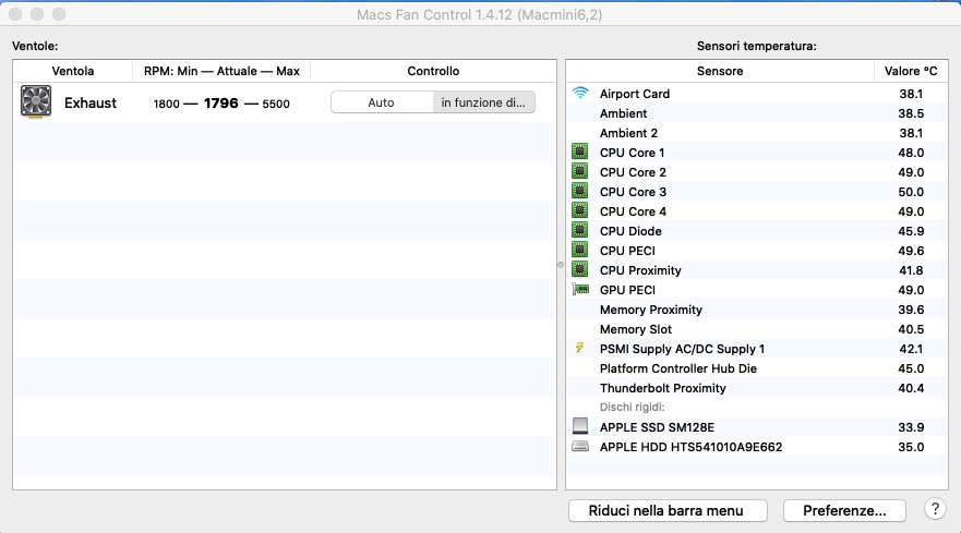

By the way, with this solution, I can hold the CPU at 47°C with web browsing (firefox), Whatsapp desktop, email (thunderbird). The fan stay at minimum rpm (1800).
fans control has been set to start at 65°c with a maximum target at 90° (CPU PECI)
Currently, I'm quite satisfied, but I still have the last step to improve: built a kind of "case" to hide the fan that looks like a base for mini. I'm also thinking about whether to include a small USB port hub and SD card reader in it so that they are available in front.
Stay tuned for the news.

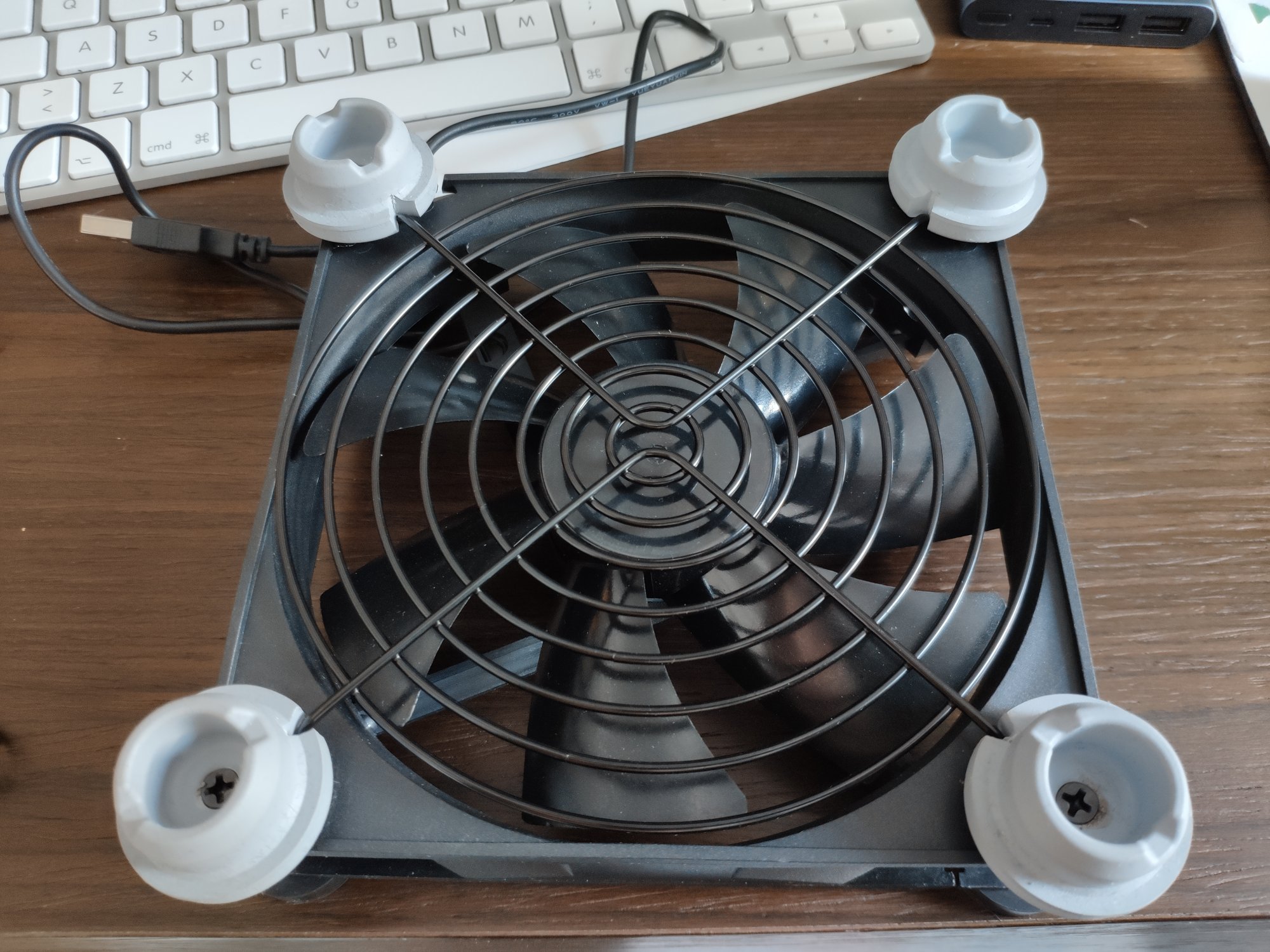

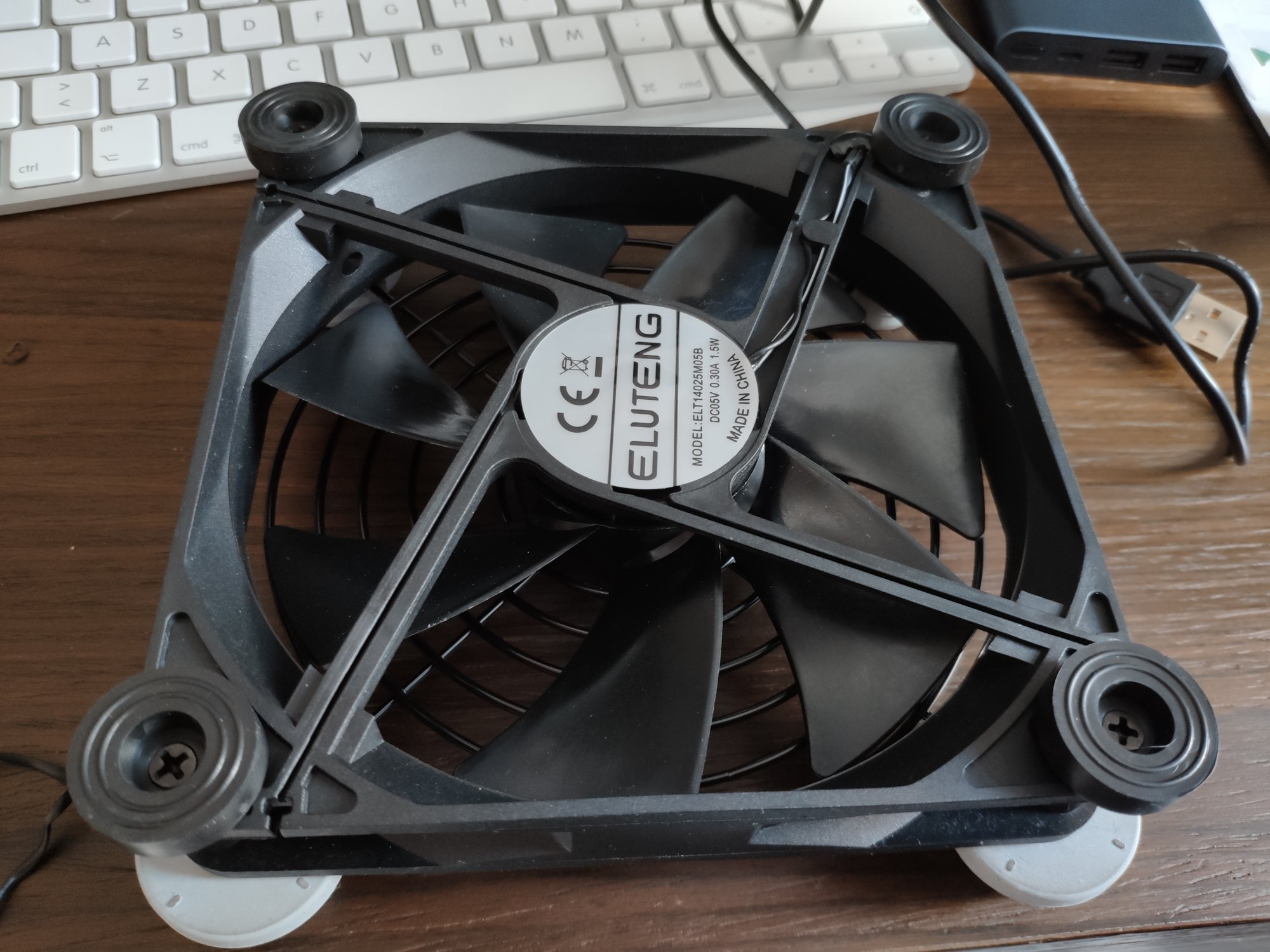

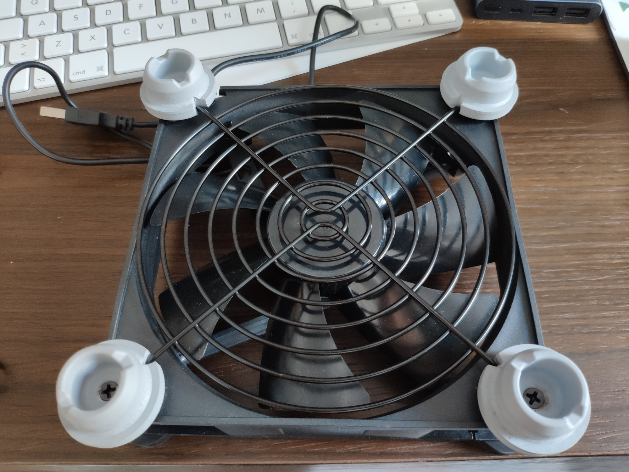

-USB fan of 140mm
View attachment 928310View attachment 928314

Sure: the fan is this one bought on amazon (italy... But I think that could be available world wide)
Thermal paste:
The other parts (rubber stoppers and feets) were junk that I had AT home.

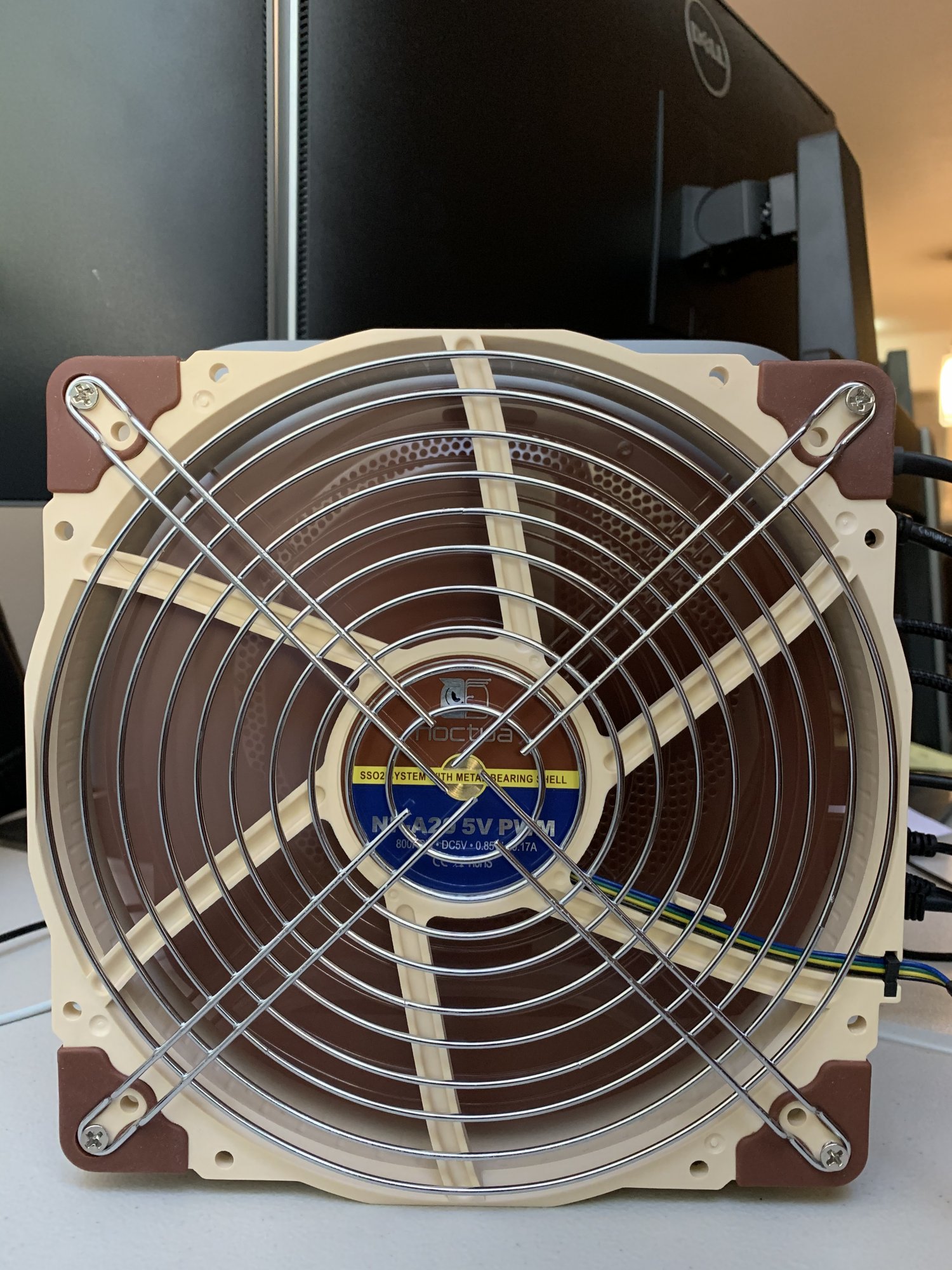

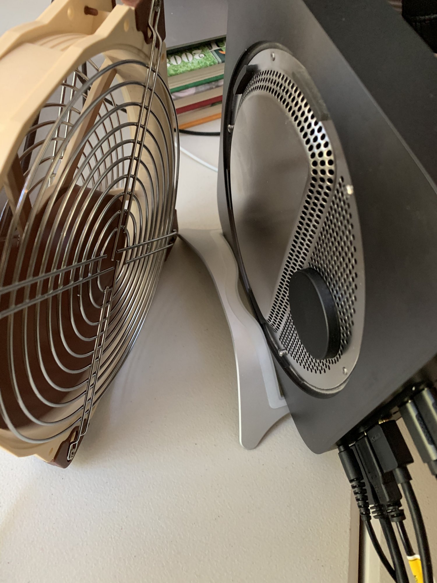

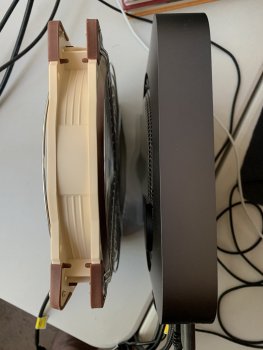

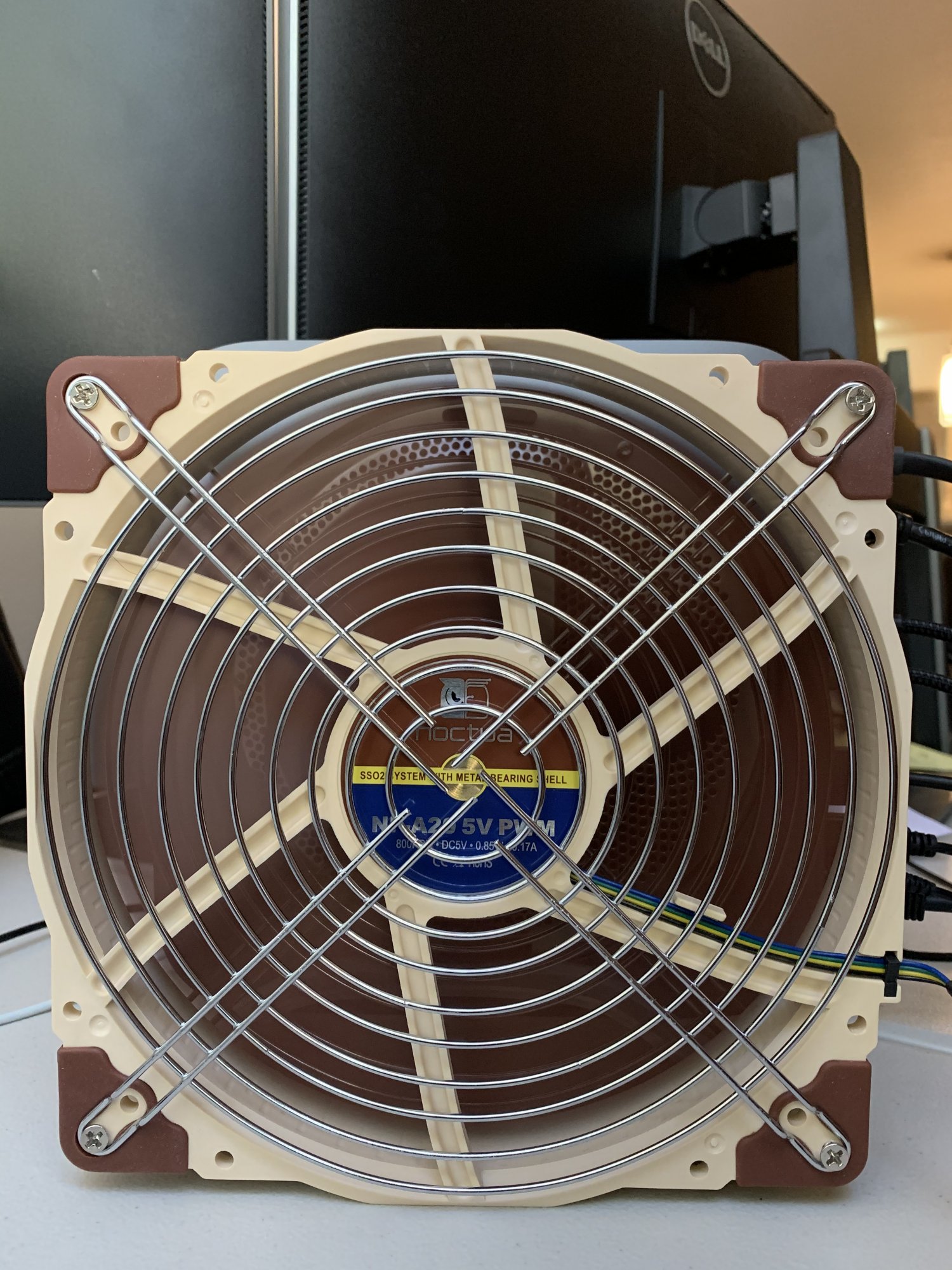

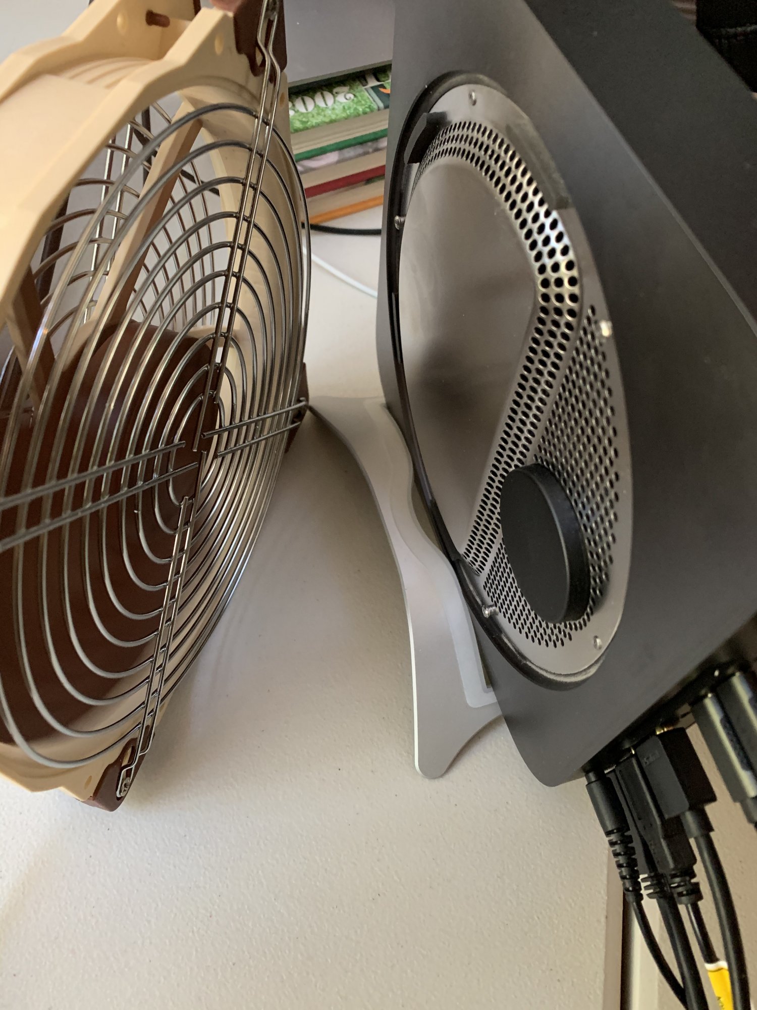

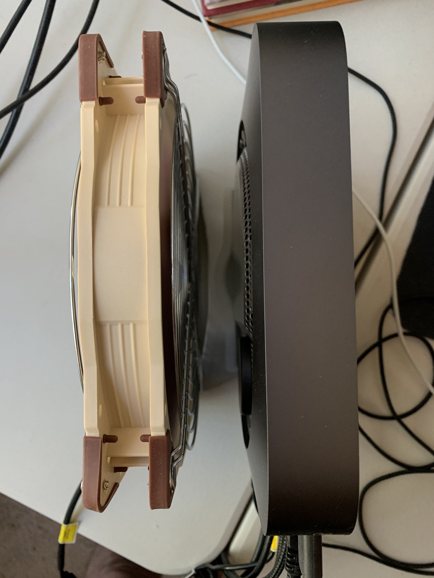

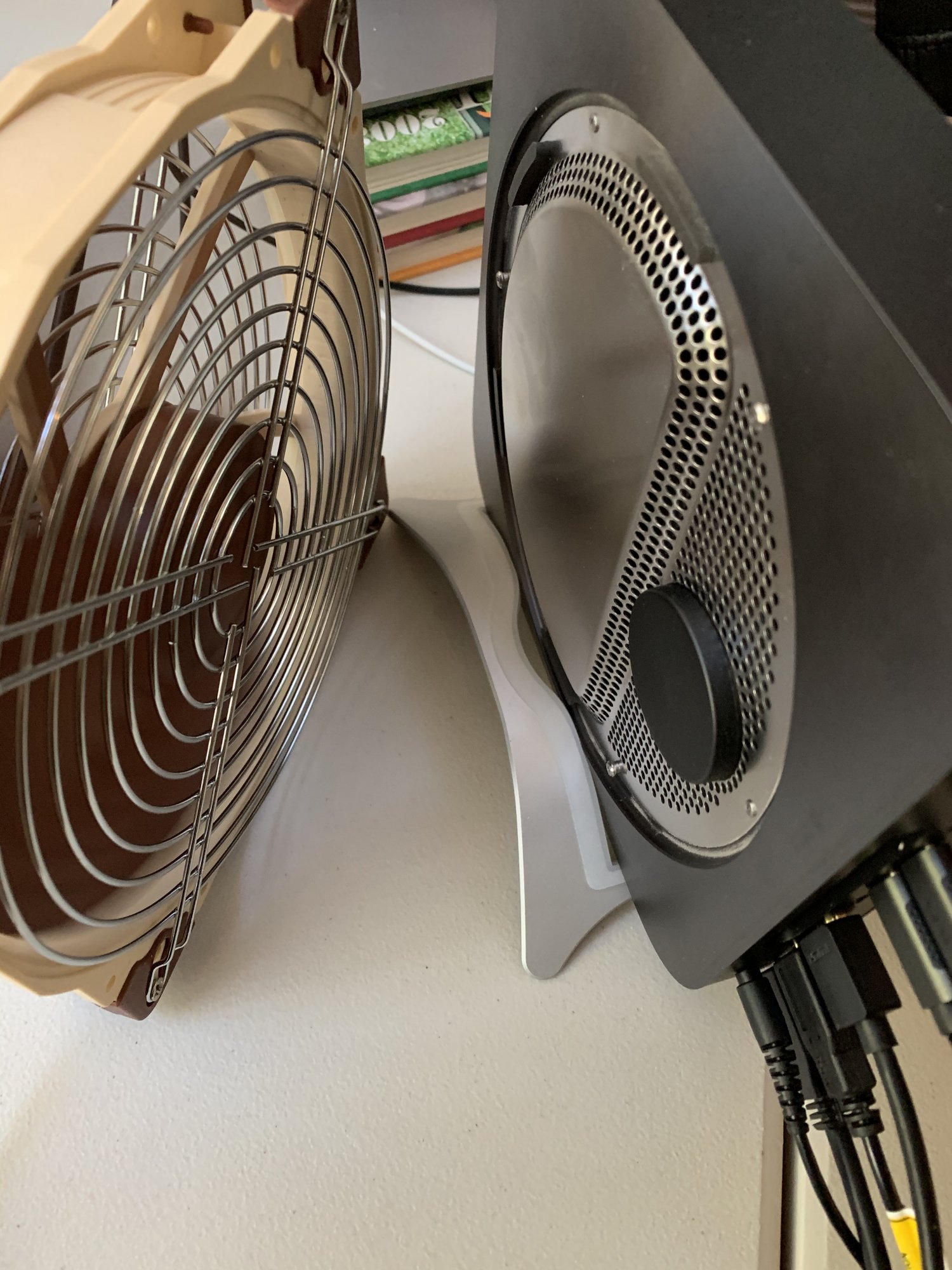

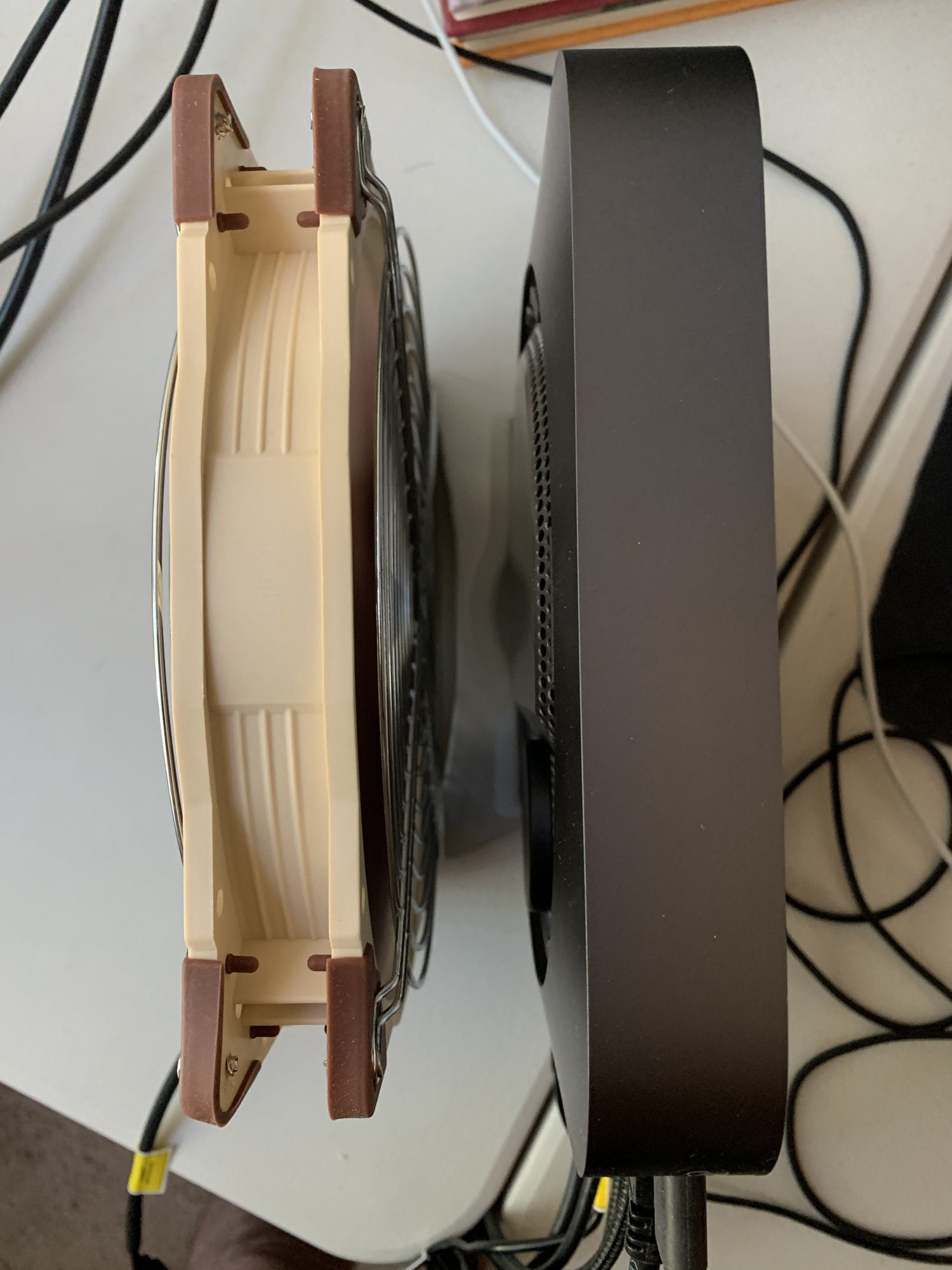

I'm using a 400mm Noctua fan directing air toward the Mac mini with the black cover removed. I do not have a dust problem. My macmini is cool to touch and the internals stay at 43 C.

I suppose one could argue either way. I recently switched from the Mini flat on top of the fan to placing the Mini on its edge with the fan beside it blowing away.
Beautiful! I love Noctua fans! I had no idea they made one that big 🙂
Your third pic, the air is drawn from the mini instead of blowing towards the mini.
During a HD upgrade on Mac Mini 2011, accidentally broke off the fan from the logic board (ugh). All I want to do is use the Mini as Plex server, with the files residing on an external. Has anyone tried to use only an external fan, with the bottom cover off, to cool the Mini? I don't want to sink a ton more money into this, but not sure if this will keep the mini cool enough to function.
Yes a big 120mm or 140mm fan outside is able to move more airflow than the small mac mini fan, so it should work better than the original fan with the plastic bottom off for 2011

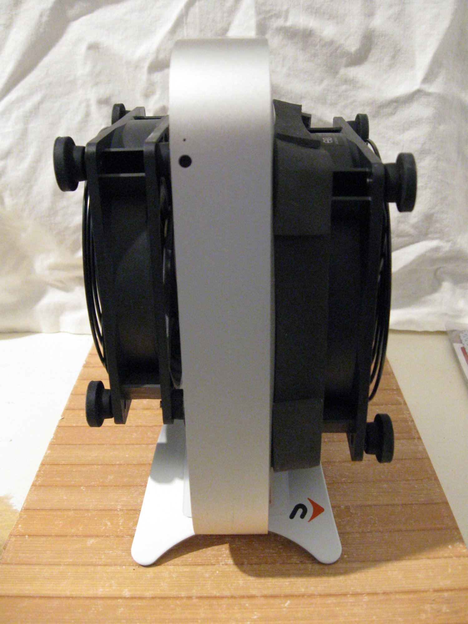

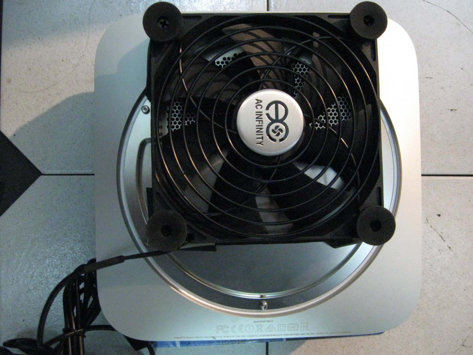

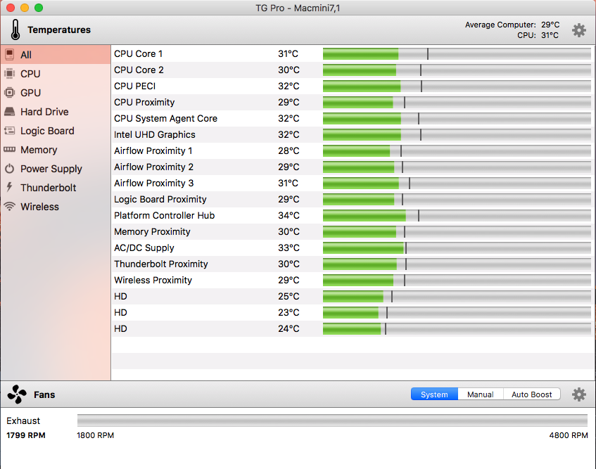

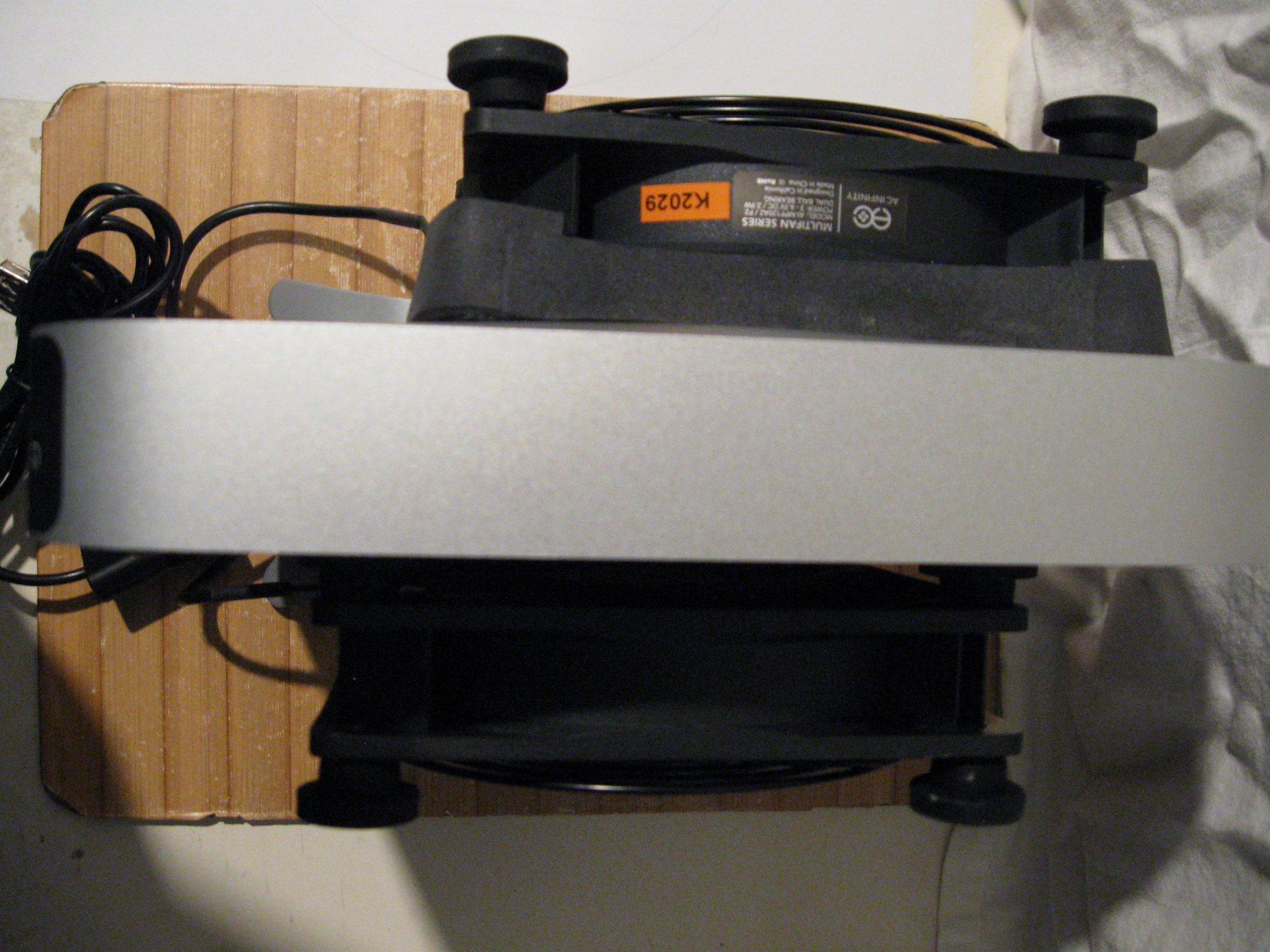

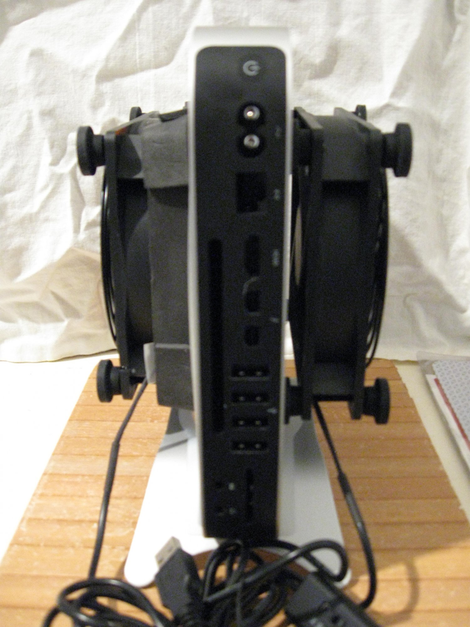

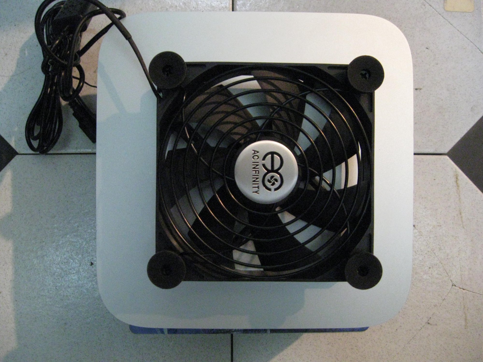

My cooling solution for my mac mini (late 2014) 2.6GHz 16GB with split 121 GB SSD and 1 TB HDD, running Big Sur 11.2.2 from the SSD (manufactured second half of 2017), may be 'overkill' to some.
I have used a paired set of 120 mm 5V USB with (Off-Low-Med-High speed control) fans plugged into one of the USB ports:
AC Infinity MULTIFAN S7, Quiet Dual 120mm USB Fan (from Amazon)
having a fan on each side of the mac mini blowing towards the case. I have taken the plastic base off the mac mini and positioned the fan carefully to blow air into the case (i.e. offset from the centre of the bottom face), whereas the fan on the top face is centred on the Apple logo. See attached photos; Using TG Pro the max. temperature recorded in idling mode for CPU core 1 is 43°C and the average is 31°C (average for computer is 29°C) at a room tempertaure of 22°C with the AC Infinity fans running at Medium Speed.
To minimize dust entry into the case, I have placed a 120 mm square of cooker/hob extractor hood filter mat held in place by hanging from the top edge of the fan frame with Scotch Tape for easy removal for cleaning (when the fan is on it holds the filter mat in place close against the fan frame).
The fans are held in place on the case using nano gel tape pieces under the silcone rubber feet, which I have left in place on the fan outer frame-faces so that I can place the mac mini horizontally in either position depending on which position gives the better cooling temperatures.
To help channel the air only through the perforated back-plate, I have sealed the edges of the fan against the case as the photos show to avoid air pressure losses throgh the open sides.
Also by placing the mac mini on its side due to space limitations using the following stand:
Newertech NuStand Alloy for Mac Mini (from Amazon)
also helps with cooling by giving the fans 'easy access' to air.
The ball-bearing fans are quiet-running at medium speed and obviously quieter at low speed, and being 120 mm they still move good volumes even at low speed, maintaining good cooling with the same ide temperatures at the low speed setting as posted for the medium speed setting......with the case fan running at its minimum 1799/1800 rrpm......🙂
I hope this simple solution gives anyone with mac mini cooling problems some ideas....... 🙂

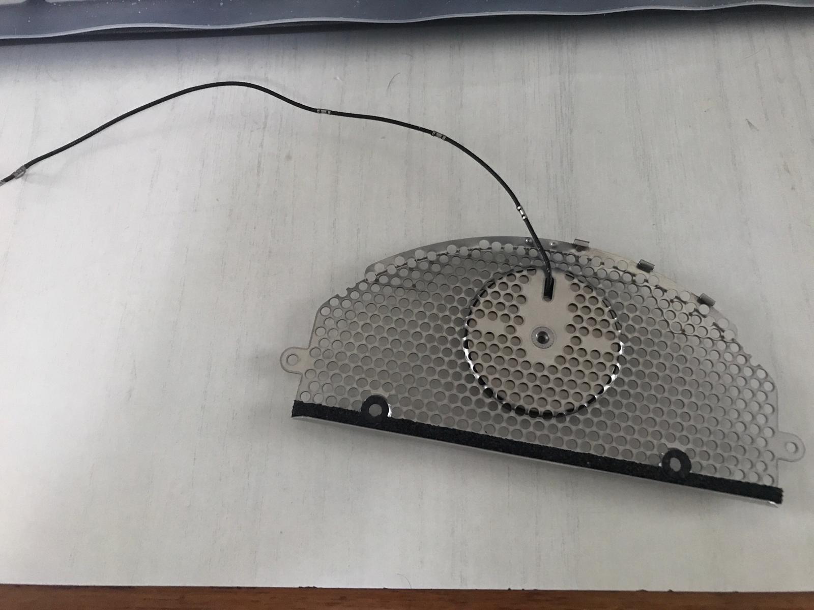

anyone tried to convert the antennae to something less obstructive?
I did, i used a faulty 2012 case to house the 2014 mini and transferred the antenna over.
On another 2014, i took out the bottom plate completely and used 1 and 3 with the internal antenna. The bottom plate is for 5ghz antenna. 2 is for bluetooth which i don't use on that machine.

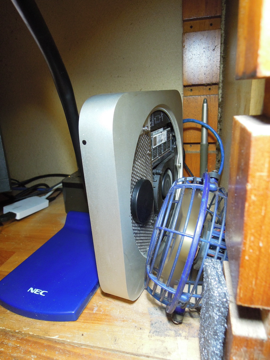

I went for a simple cooling solution for my late 2012 Core i5 16gb RAM. 480gb. Internal Sandisk Ultra 3D SSD.
In my Mac Mini the case is a virtual heatsink. heat builds up internally & is absorbed by the case which is theoretically cooled by the internal fan but . . . where does this heat go ?
Cooling the exterior of the Mac Mini case will undoubtedly yield cooler operational temps but I wanted more.
I removed the large, bottom rubber grommet.
Purchased a very cheap ( ¥1,000 ) and small external PC fan ( externally powered ).
Situated the Mac Mini vertically. Located the PC fan as you can see in the enclosed pic.
Right now = 2 am
iStat Menus Vers. 15. Ambient temp is 22°C Mac Mini CPU Die = 37°C
I blow out any internally accumulated dust in the Mac Mini about every 4 weeks.
I reside in Japan, Summer here often gets up to 40°C. From May 1st, daily outside temps gradually increase to peaks in mid-September.
I feel confident that my Mac Mini will operate well within my specified operational temps this summer.
Note : I spent quite a lot of time learning how to cool my 4,1>5,1 Mac Pro and have
employed that experience to my Mac Mini.

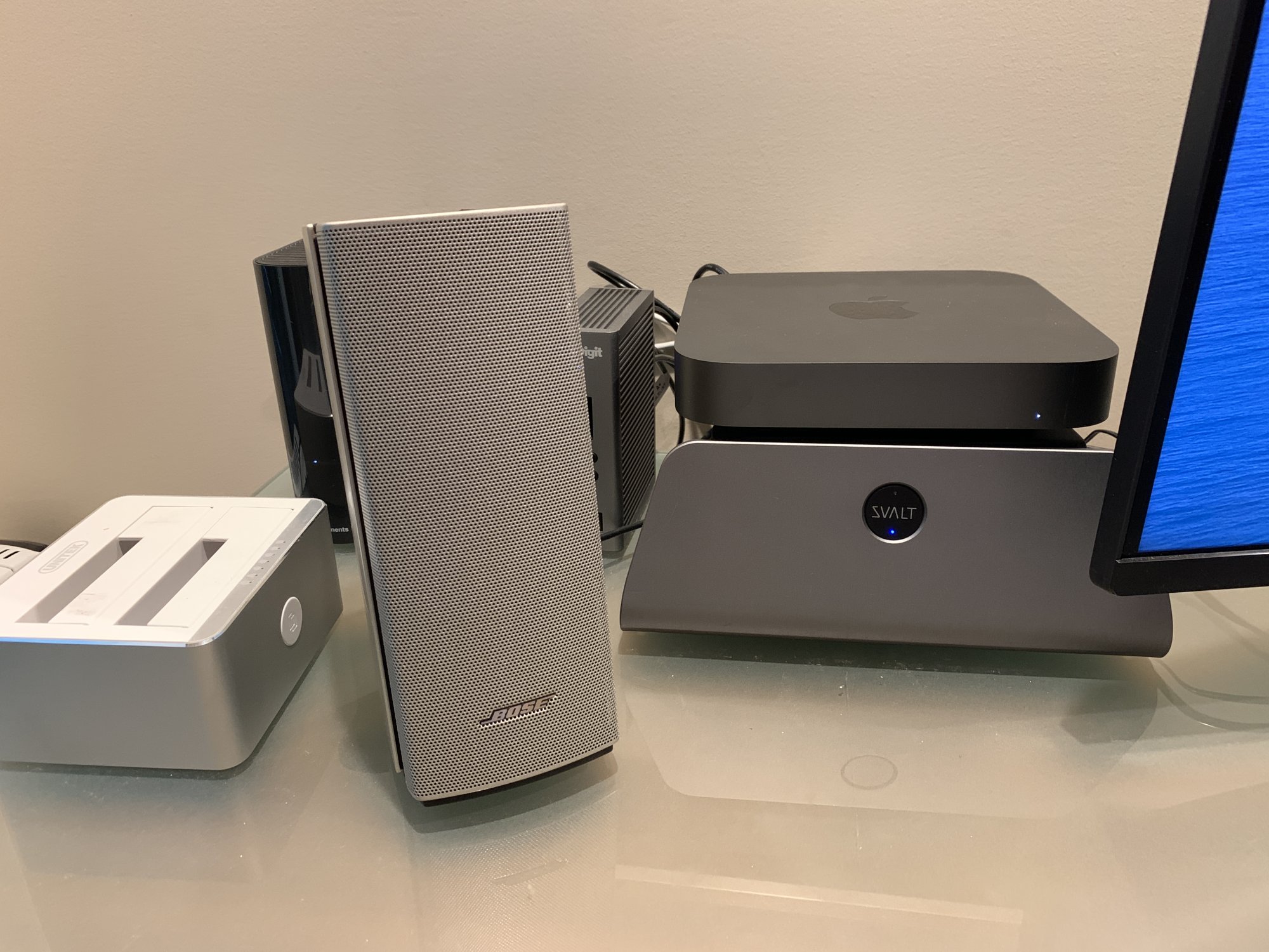

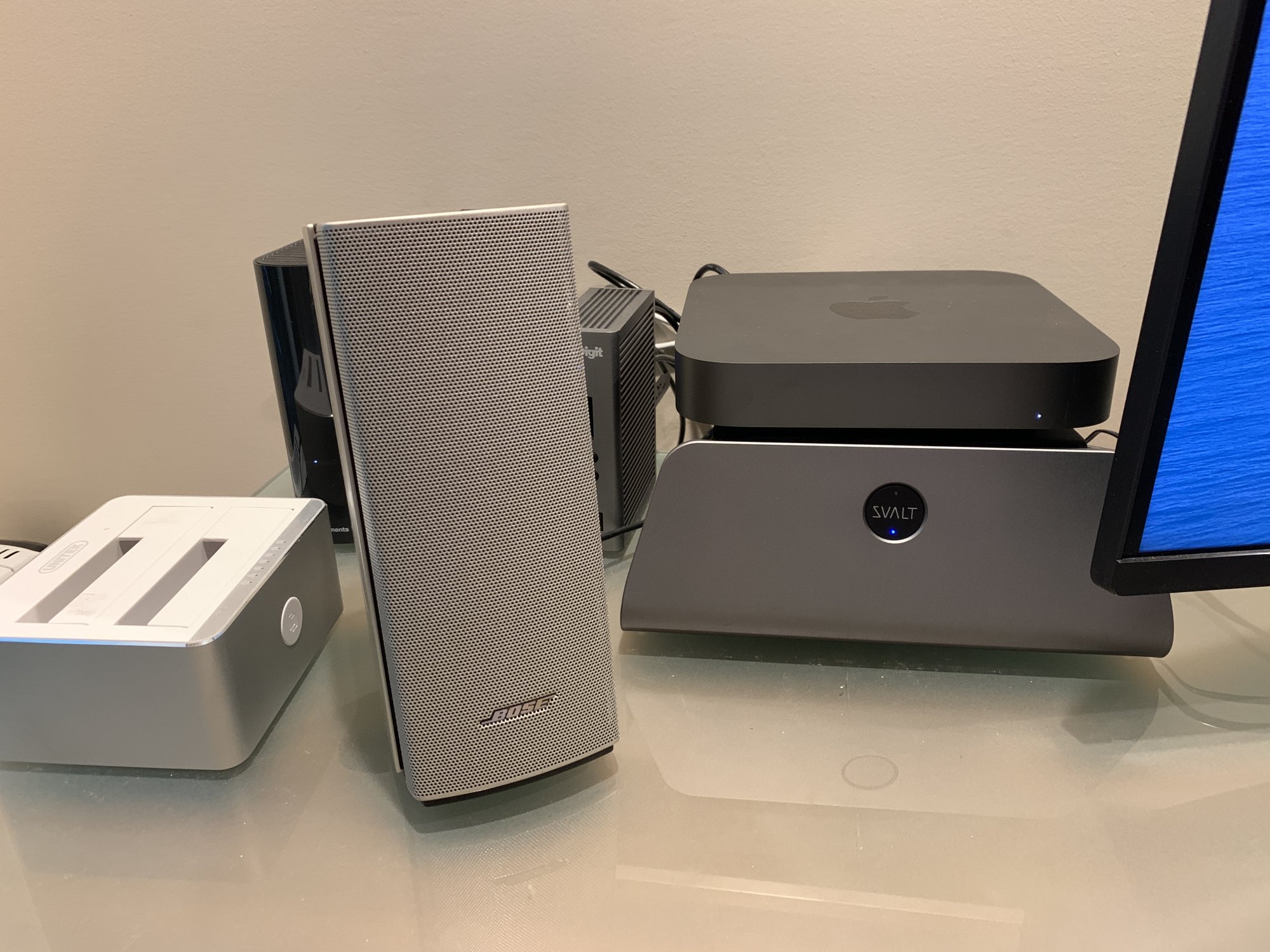

I have the SVALT S Mini, only received a few days ago:
While not a cheap solution, the quality, looks, & performance are fantastic, my 2018 Mini is now running super cool.View attachment 892756View attachment 892757
