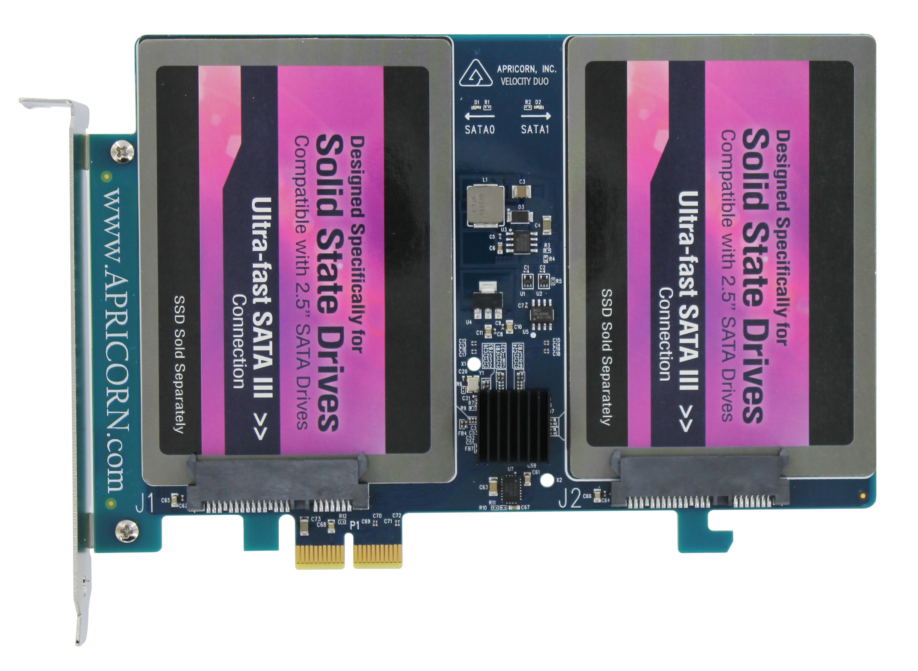

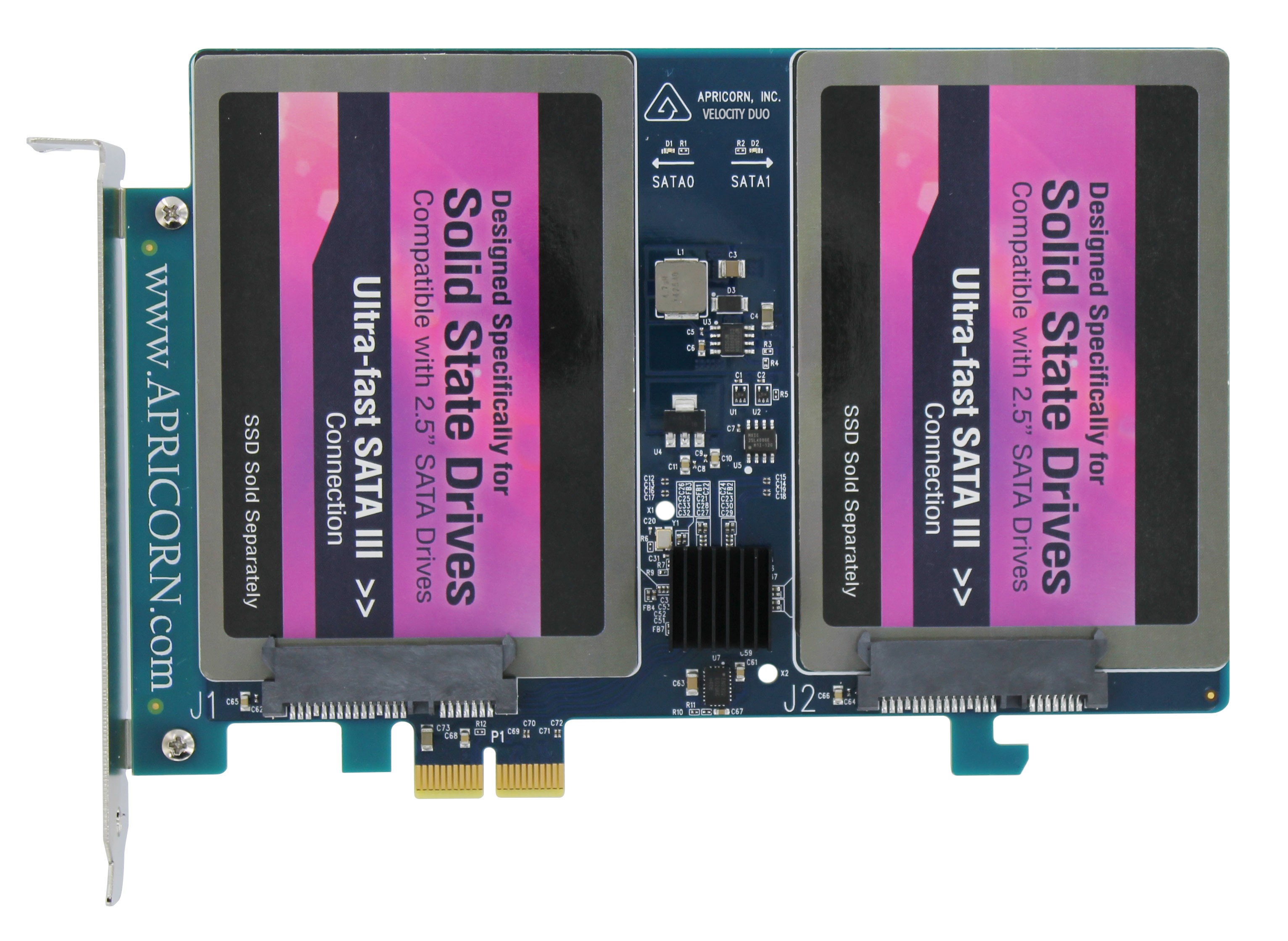

SDAVE, say you put an 850 EVO on an Apricom Velocity Duo x2. You have another SATA III port with it, right? Where do you hang a drive that you plug into that port?

I had a Samsung 830 Pro on my Velo x2 (I moved this drive over from a 2011 MacBooK Pro). For the second port I took out the bottom SuperDrive (I never used either) and just put it in there. Ran a SATA wire and a SATA power splitter (I had these already but theyre cheap) and just arranged the cable. No problems. I recommend getting the Velo X2 and a 1TB SSD. Then in the future you can get another SSD if you want. Use the HDD bays for files like movies and mp3s as they don't require speed.
The Duo x2 mounts and powers two drives and plugs into one PCIe slot.
