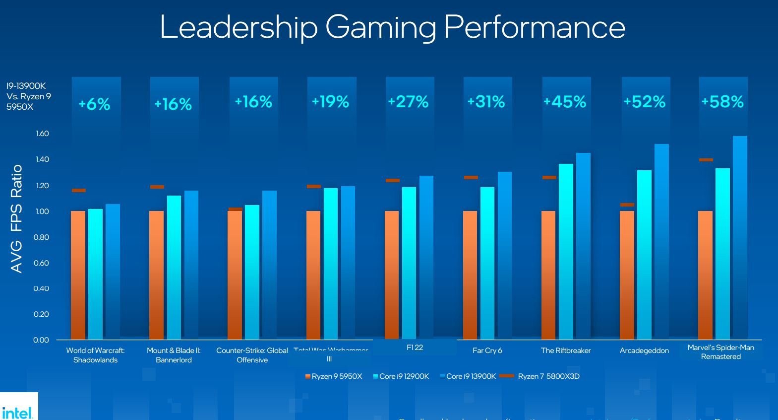

I'm very happy to be alive and seeing Intel being an underdog for the 3rd time in the past 20 years:
Intel 13th gen is a laughing stock. Isn't it?
At what power consumption? If it's still 10nm (Intel 7) then it's worrying but if Intel outsource to TSMC then they could potentially take the crown from AMD.

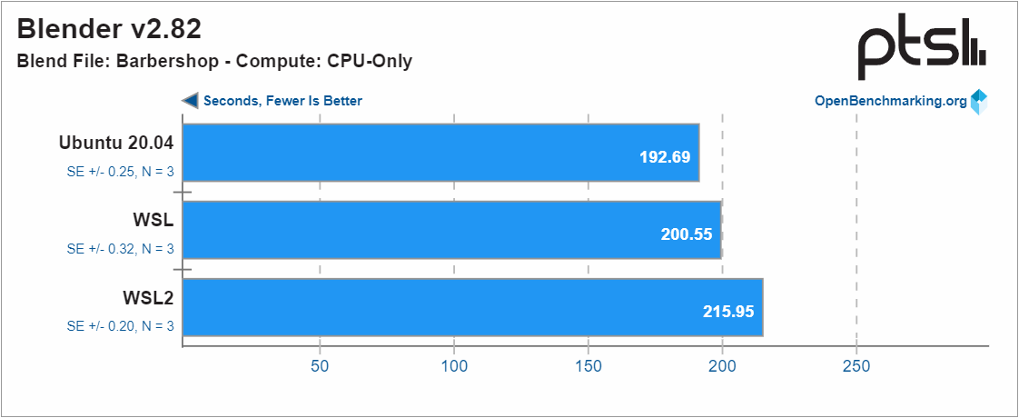

Geekbench is a decent cross-platform estimator of amortized burst CPU performance across a series of different workloads. SPEC is the same but for sustained performance and a bit more series.
The benchmark might be cross-platform, but Anandtech's methodoly might not be. Who benchmarks a CPU on WSL instead of Windows or Linux?
The tooling is probably developed for unix, so targeting Linux makes sense. Again, running CPU work should make no difference from running from Windows directly.

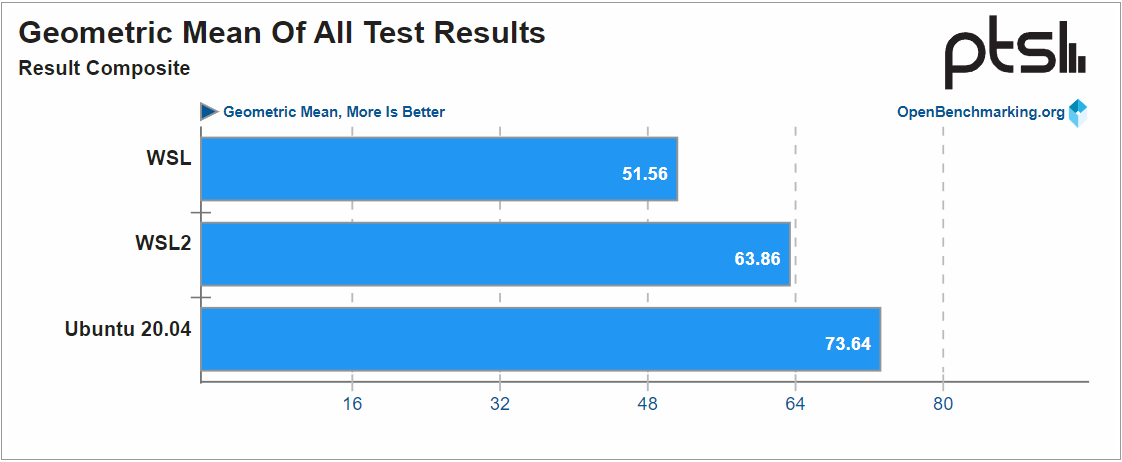

Geekbench is garbage though compared to real workloads.
Fortunately, Phoronix already did the comparison so I don't have to.
Except that Geekbench is not garbage and is a far greater predictor of general CPU performance than something like Blender.

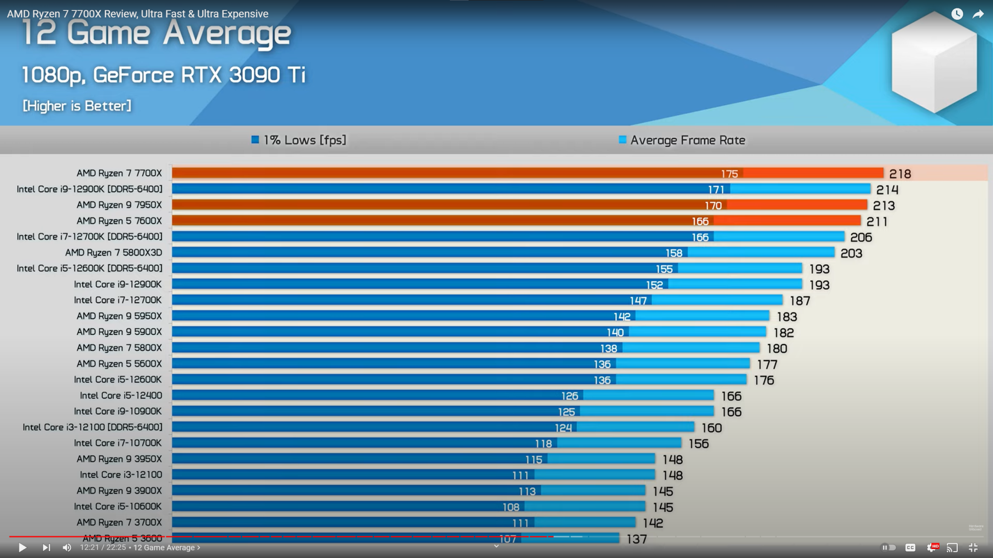

mi7chy
macrumors G4
Oct 24, 2014
10,619
11,293
While the 7950x is the king of productivity the 7700x is the king of gaming at $300 less ($399 vs $699). A fat cache 7700x3D and 7950x3D would be the GOAT.

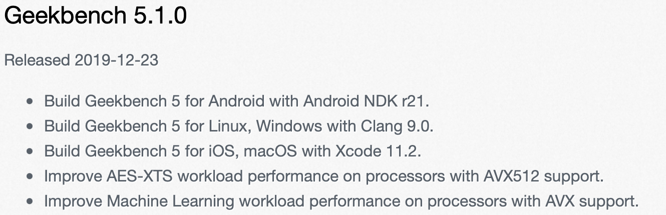

Gerdi
macrumors 6502
Apr 25, 2020
449
301
I don't know. But: As I understand it, NEON is the SIMD equivalent for ARMv8. I searched Primate Lab's GB Release Notes for "AVX", and found this:
Doing the same search for "NEON" I got no hits.
That is because NEON crypto support was already in at the release of Geekbench 5.1.0.
In any case, Spec CPU does allow auto-vectorization for SIMD in the rate benchmarks but no hand-optimized SIMD of course.
Reactions: theorist9
theorist9
macrumors 68040
May 28, 2015
3,880
3,059
Sorry, not following--those release notes go back to GB 5.0 and don't mention NEON. And the release notes for 5.1.0 don't mention NEON:
In addition a Google search of the entire primatelabs.com website for NEON doesn't turn up anything (at least that I could see):
site:primatelabs.com neon
[Emoticon was not intentional!]
...other than this from 2013:
Could you please provide a link?
Also, how much accleration does NEON provide compared to AVX512?
