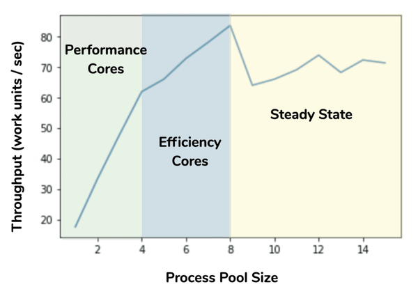

Something like this? The developers of Anaconda performed a benchmark on M1 and got this graph:
It's on some kind of support forum. I don't know where since it's a few months ago to see the progress of a possible future software in my course.
The results given by that user have 8 cores sometimes regressing.

I had read that one P core performs like between two and four E cores. For example, the Anaconda graph above shows that one P core performs like three E cores. The graph shows that four P cores can achieve 60 and the eight cores reach 80. So, each P core adds 60/4=15 and each E core adds 20/4=5.
Apple has shown that a hybrid architecture with P/E cores has advantages and that's why AMD will use it next time.
