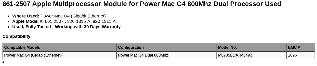

Currently, I have not seen someone confirm a Gigabit Ethernet CPU working in a Digital Audio. I have seen Gigabit Ethernet G4 CPU's around on eBay and some are even dual CPUs. This one I'm looking at here being at dual 800Mhz.
eBay Link
This reportedly being compatible with the PowerMac G4 Gigabit Ethernet.
I've looked around and I've seen Quicksilver CPUs in a Digital Audio PowerMac before but no mention of the Gigabit Ethernet model.
The current CPU in my PowerMac G4 Digital Audio is the 466Mhz single G4 CPU.
I have not seen anyone confirm compatibility of using a Gigabit Ethernet CPU in a Digital Audio PowerMac G4 yet.
The questions I have here:
Is this CPU compatible with my PowerMac G4 Digital Audio?

Yes; it can work in a DA. Maybe; performance would depend on what your current CPU is and what software you want to run.
There are threads around here and over at 68kmla on swapping CPUs from different towers. For a dual 800 in a DA, you basically need to power it and cool it. So it is not a simple drop-in upgrade, but it can work with a little effort.

I think there is some confusion here about CPUs and the tower models that they came in. The dual 800MHz CPU in your first post is from a quicksilver, not a gigE. There are sites where these series of apple G4 towers are described and compared, but the main difference for the purpose of this discussion is the bus speed (100 vs 133MHz), and the position of the CPU and socket on the logic board. To a large extent these series of CPUs are all interchangeable. The main exception is the dual 450/500MHz from a gigE, which will not physically fit the DA or quicksilver.
MicroTecture
macrumors member
Aug 25, 2020
62
21
Odd how the listing mentions a gigE. Well, I guess this would be an option I can look at for the time being (dual 800MHZ CPU mentioned in my first post).

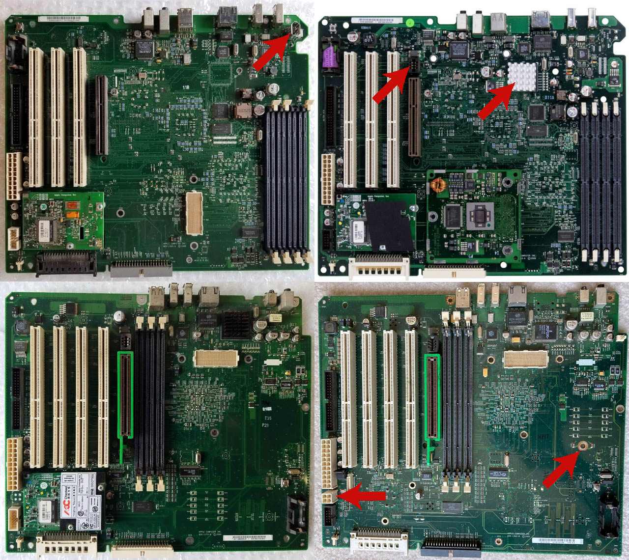

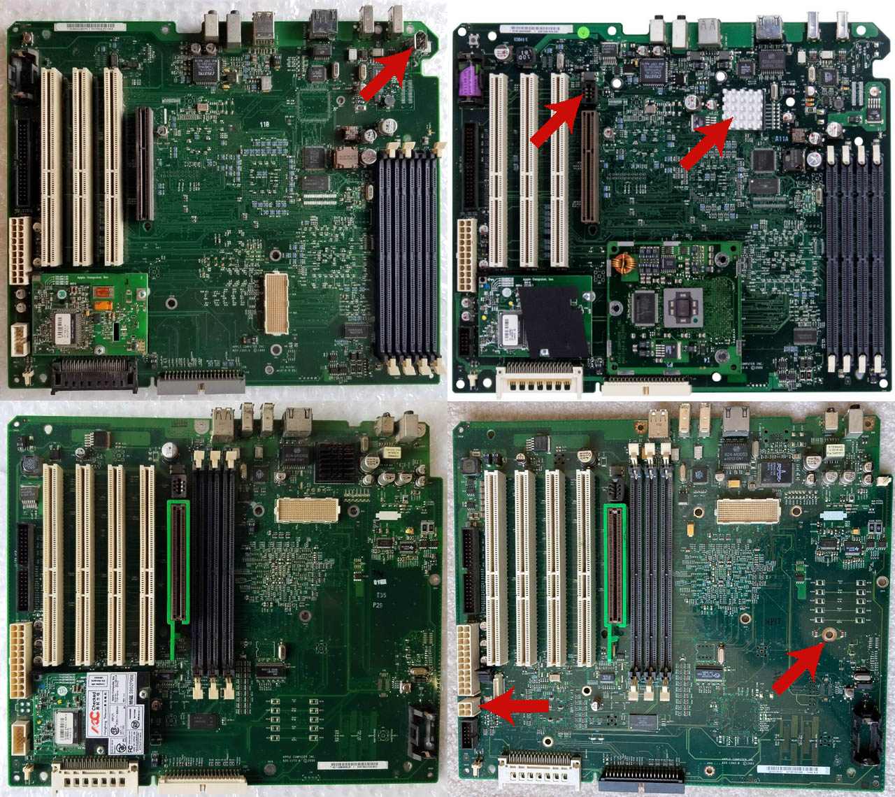

So to try and clear things up a bit I stole some pictures from ebay and made a little ID guide. This is not comprehensive, but it covers the basics:
AGP Graphics:
100MHz bus, 4 RAM slots, internal firewire port, some of these early ones do not support dual CPUs
Gigabit Ethernet:
100MHz bus, 4 RAM slots, has the gigabit chip populated, has 28v added for ADC monitors
Digital Audio:
133MHz bus, 3 RAM slots, CPU is rotated 90˚ vs earlier models
Quicksilver:
133MHz bus, 3 RAM slots, extra 12v power to logic board and "4th hole" to route this power to the CPU
AGP Graphics:
Gigabit Ethernet:
Digital Audio:
Quicksilver:
With this, I should find CPUs based on which machine it came out of and basically which appear would fit correctly is what I'm seeing. Thanks for the ID guide by the way!
Would you recommend the “gigE” (you said it was a QS CPU and after checking around, you are right) CPU I mentioned on the first post to get me started with a dual CPU G4 on the DA? I would imagine the existing heatsink would need to be swapped for something else for better cooling, correct?

There are already various places online that describe the differences in specifications between these similar computer models. For example:
As I mentioned above, the CPUs for these models are mostly interchangeable if you're willing to make some simple modifications. If you in fact have a DA, then the way to get dual CPUs using Apple OEM boards is to use either the dual 533MHz CPU out of a DA, or the dual 800/1000 out of a Quicksilver. The dual 450/500 out of a gigE will not fit.
For this series of computers there are maybe a dozen different heatsinks that were used. Some of them can be swapped around to some extent but the easiest solution is to get the heatsink that originally came with the CPU.
The dual 800 and dual 1000 CPUs use a lot of power and I would suggest using one of the OEM heatsinks with at least one good fan. If you make a custom heatsink then there are probably hundreds of options.
Of course there were also a number of different aftermarket CPUs from Sonnet, Powerlogix, NewerTech, OWC, FastMac, etc.
