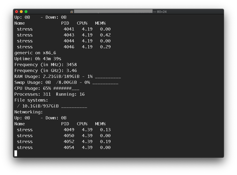

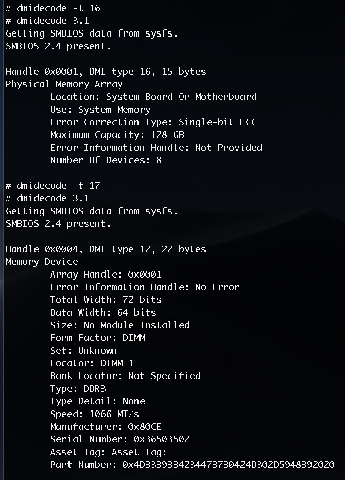

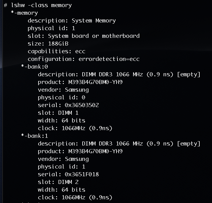

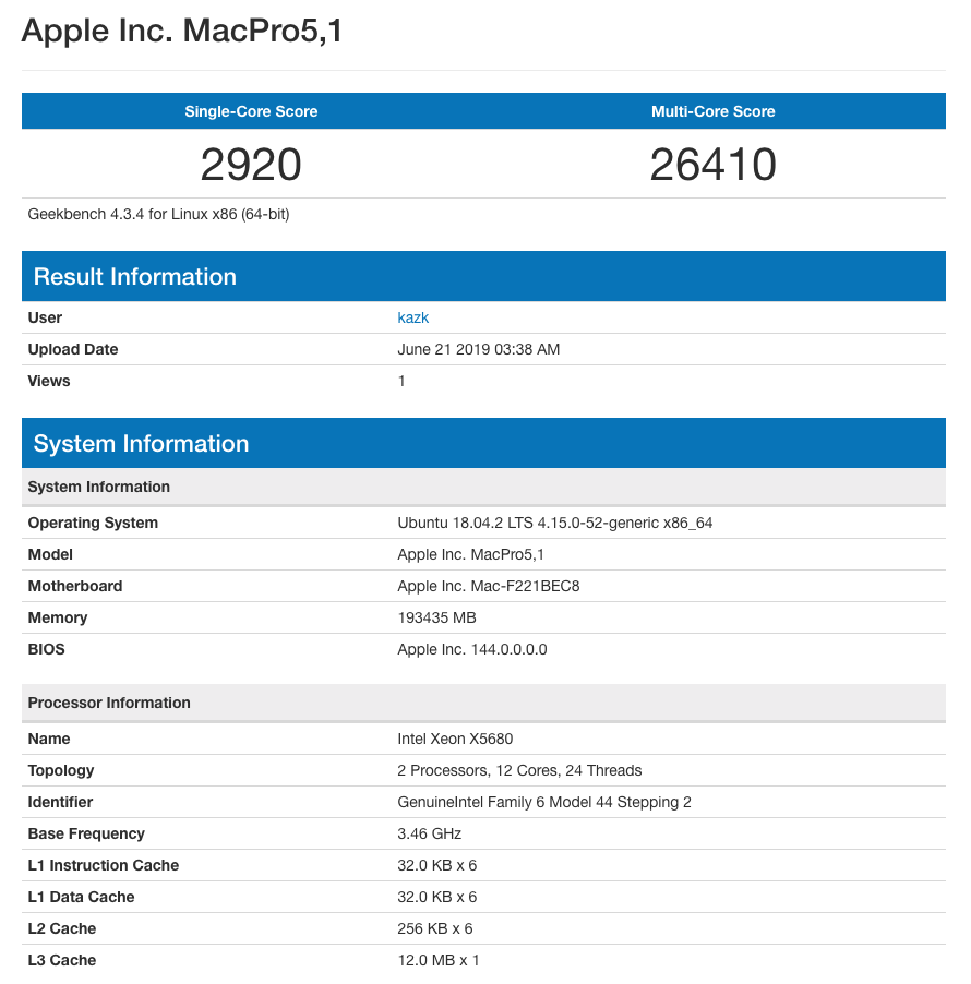

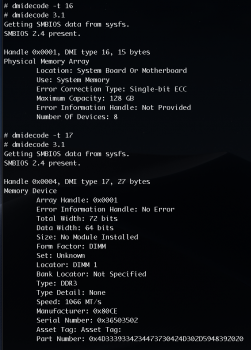

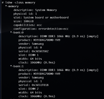

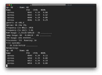

Last night, I installed Ubuntu Server 18.04.2 LTS to 1TB NVMe SSD in one of my MacPro5,1 with X5680 dual CPU tray and 192GB (6x32GB) memory which runs 1066MHz.
I tried stress test, and it was pretty stable.
For video card, currently it has GT120, but I plan to replace it by Titan X (or GTX 1080Ti) later.
Screenshot 2019-06-20 20.39.20.png Screenshot 2019-06-20 20.42.28.png Screenshot 2019-06-20 20.42.53.png Screenshot 2019-06-20 21.15.24 copy.png

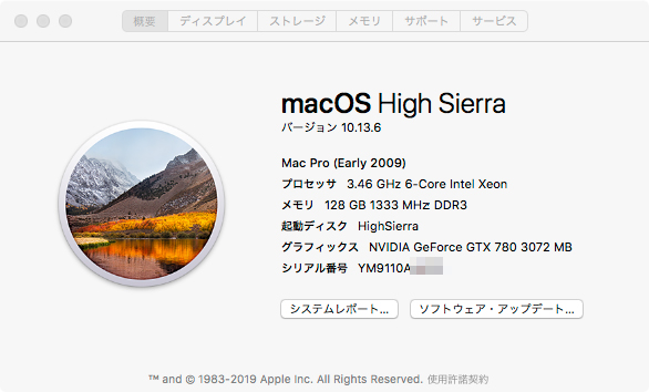

Hello, everyone.
Today, I installed 4 x 32 GB RAM on a 6 core MacPro 5.1 and succeeded in booting up macOS.
All the steps are on my blog. (I'm Japanese so the page is in Japanese. Please translate it.)
In a nutshell, I put the boot loader in two stages and start it by telling a fake memory configuration from Clover to macOS.
I don't have a 12 core MacPro 5.1.
I would like you to try if you can do the same with the 12 core model.
You may be able to start MacOS with 256 GB of RAM which is as good as iMac Pro.

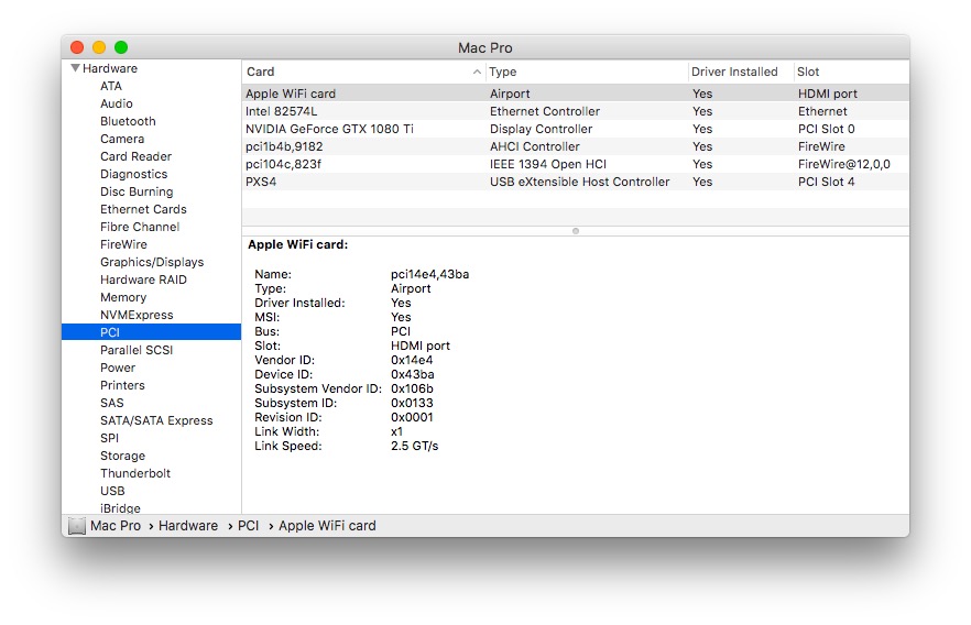

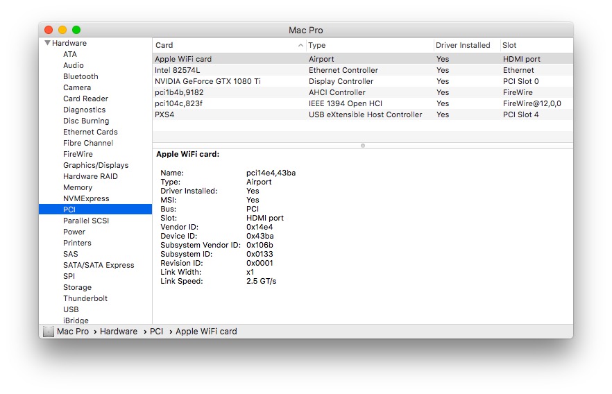

Thanks for the sharing.
Just want to make sure you know the risk that Clover may corrupt the cMP's firmware. And at least, all PCIe info will be messed up.
This is what it looks like when using Clover on my 5,1. I am OK with that for some tests. But not quite comfortable to keep the cMP like this for everyday use.
My MacPro also does not display PCI information correctly.:(:(:(
sleep mode does not work properly. (The screen does not appear.):(:(:(
I hope my discovery will be a good idea for you.:)
Clover can do a lot of things. e.g. Force the SMBIOS to recognise as other Mac, such as iMac Pro to get native Catalina support, or native hwaccel support.
But the risk level of messing up PCIe info or BootROM is unknown. May be you should work with Tsialex to monitor the BootROM's healthy level.
The wrong PCIe info shouldn't damage anything, but in worst case, just a crash.
However, corrupted BootROM can brick a cMP. We better monitor it.
If end up evidence shows Clover actually quite safe, no adverse effect in real world. Then we will have another very powerful tool to use on cMP.

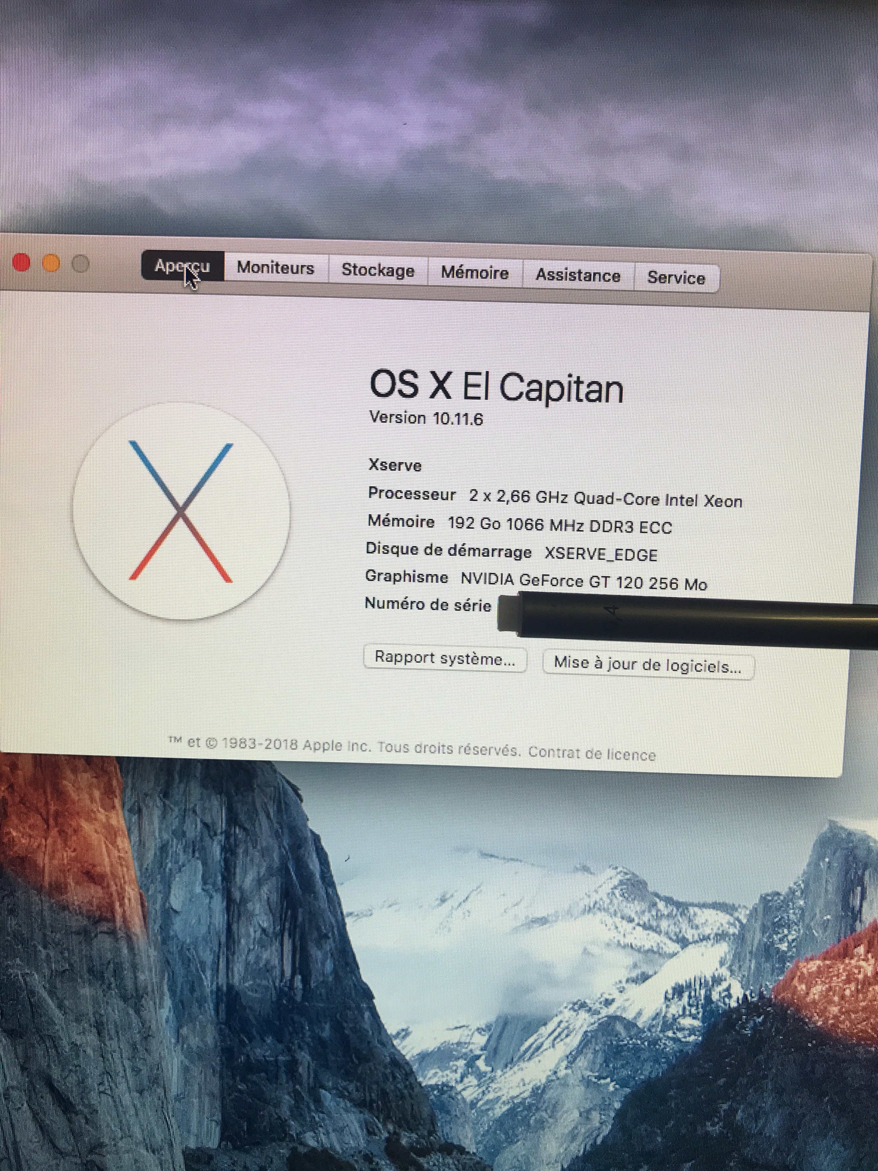

Anyone ever try installing 32GB ECC RDIMM 1866MHz in MP4,1 or 5,1 ?
its been known that the Xserve can run with 192GB for a while now, but its still very cool to see tho :)
its one of the ways we ruled out just a generic OS X not liking more than 128GB of RAM thing when trying to figure out the cMP issues,
it would be very interesting to try 32GB RAM sticks in an Xserve3,1 tho :)
Reactions: VaZ and h9826790

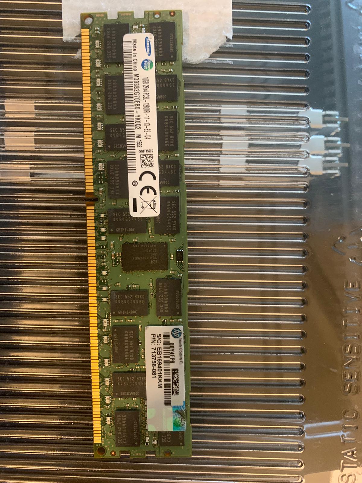

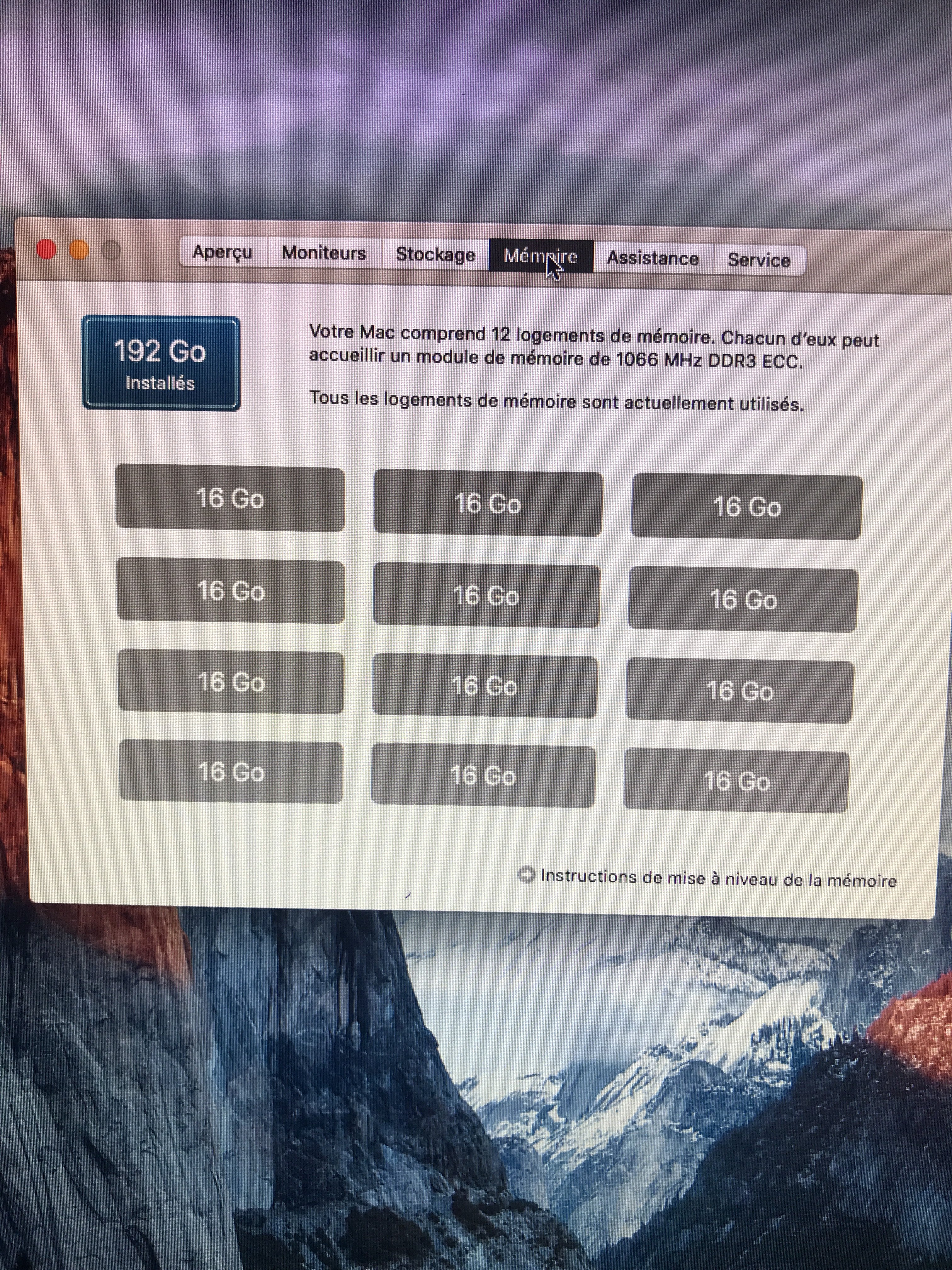

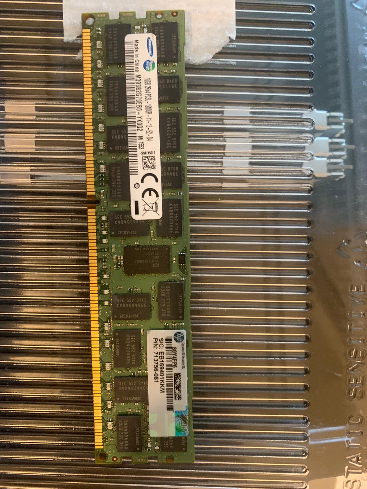

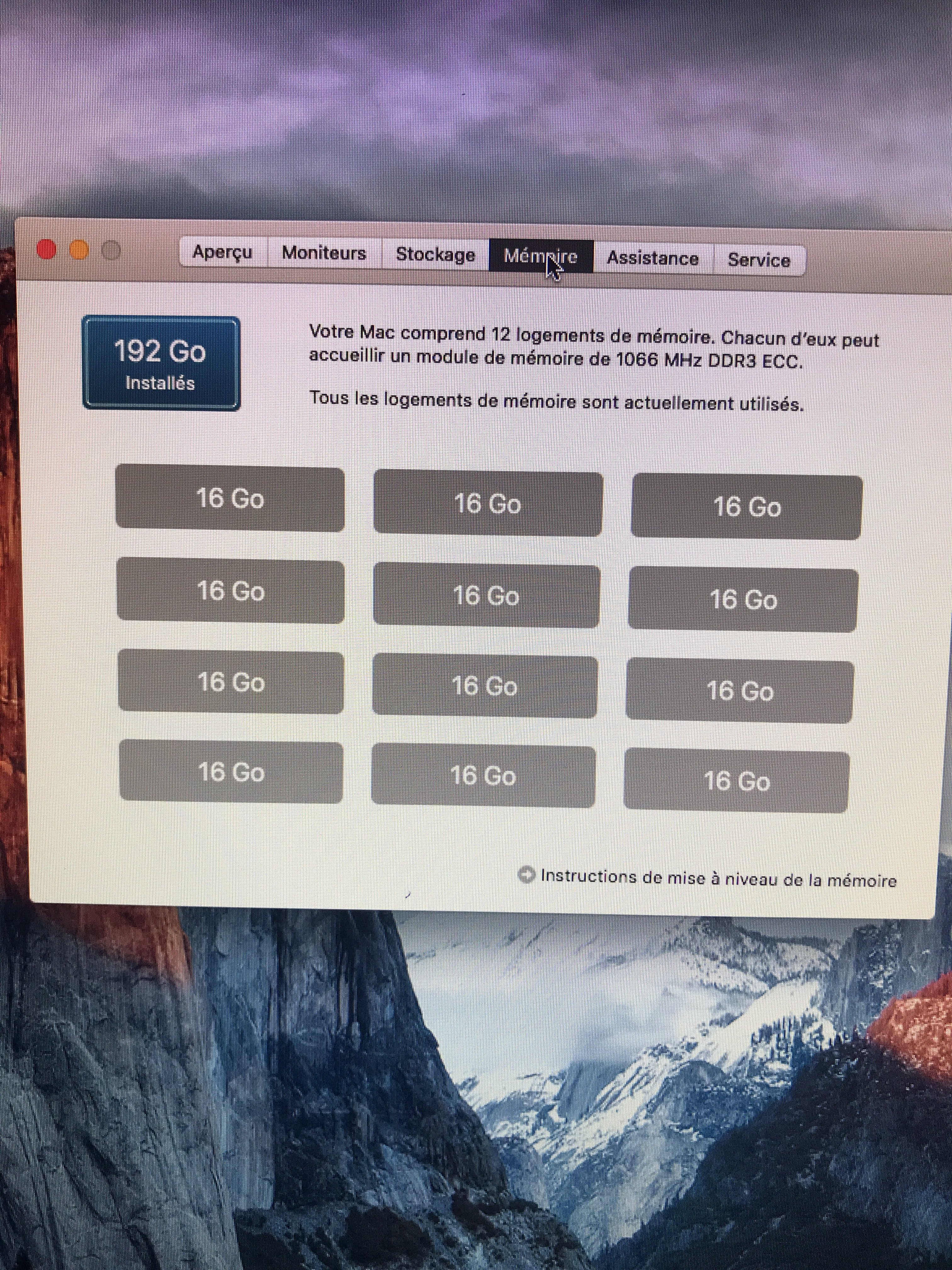

working on it!
those are 1866 samsung ram and they apparently dont go down to 800 mzh when fully poulated...
will try to mount w5590 to see if it still can keep with power demand
Reactions: LightBulbFun
ohh fun times ahead! :)

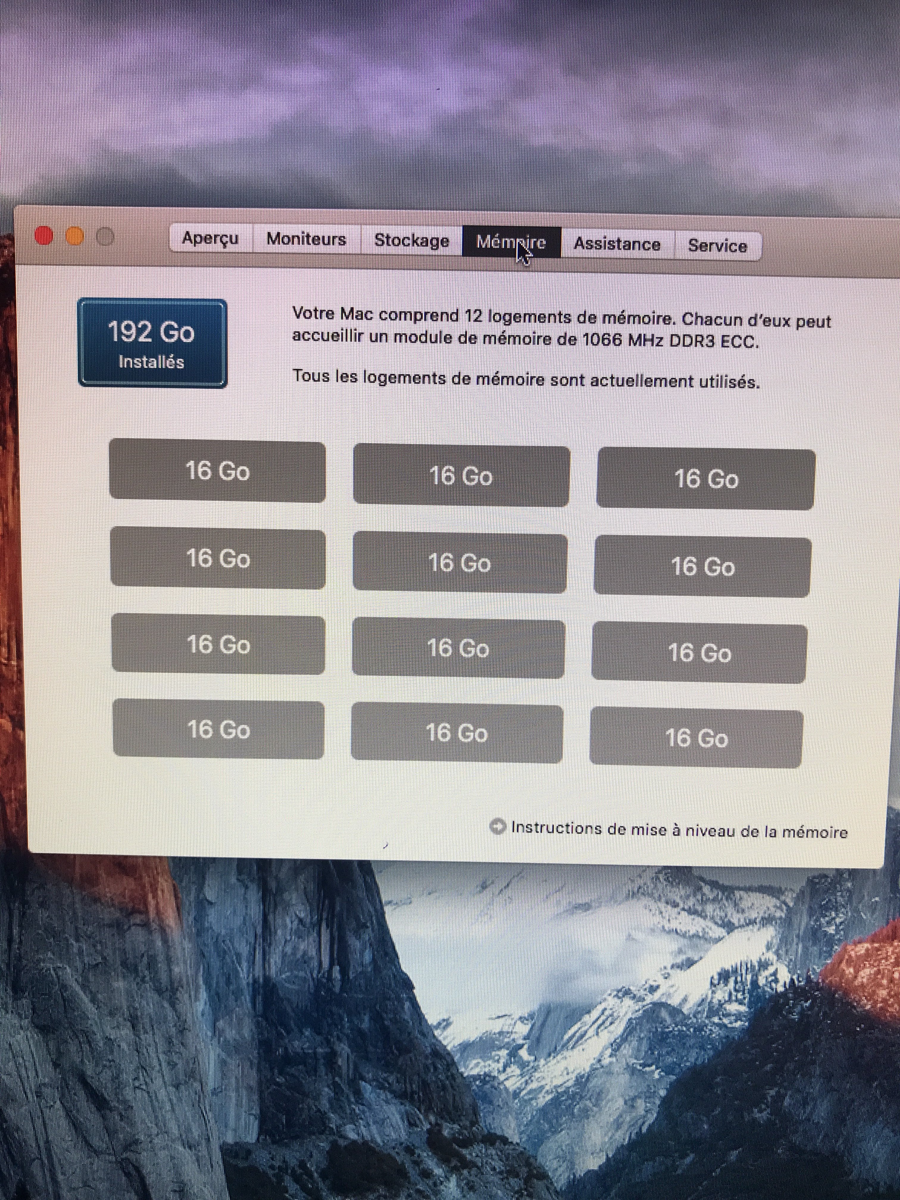

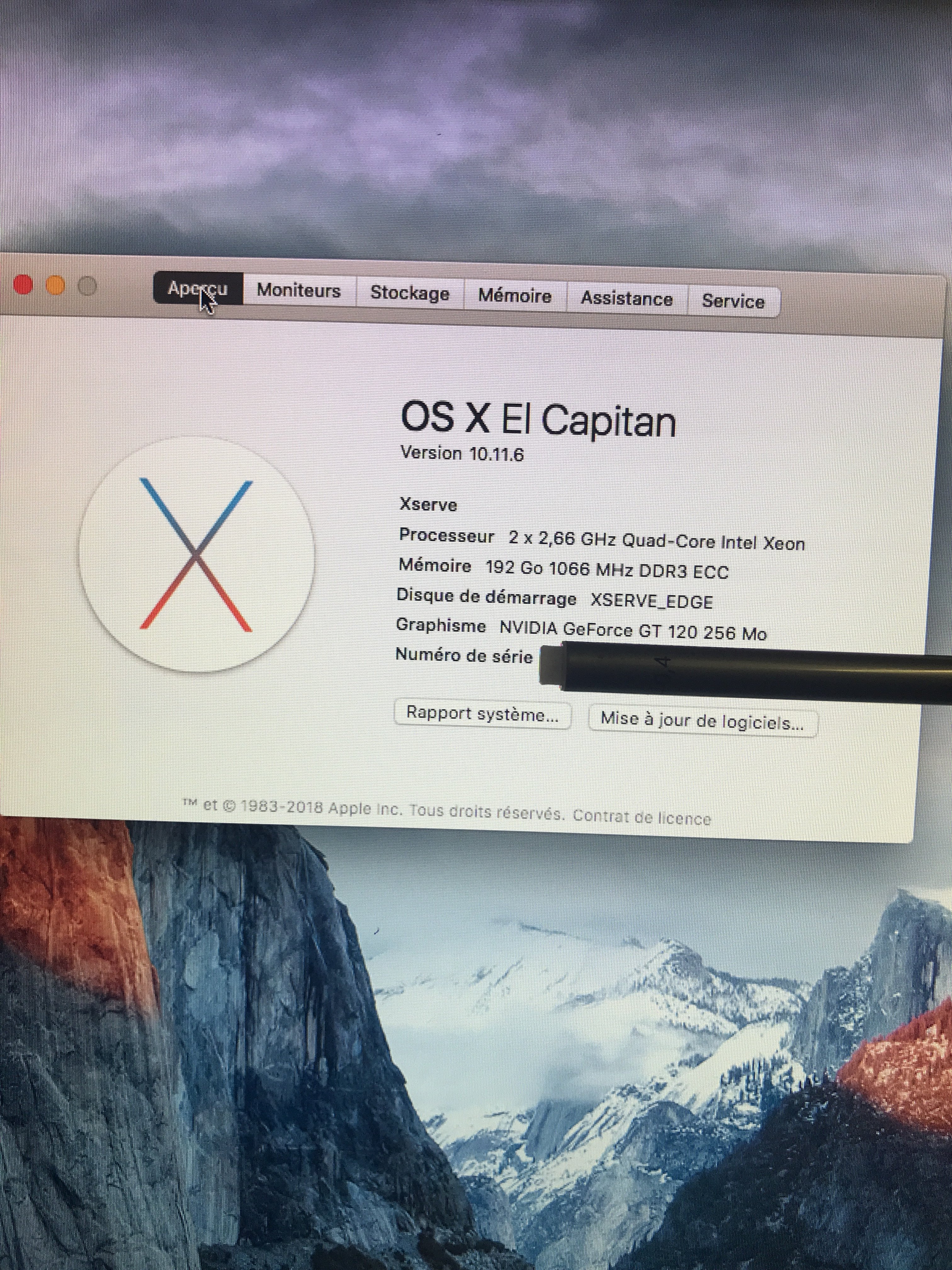

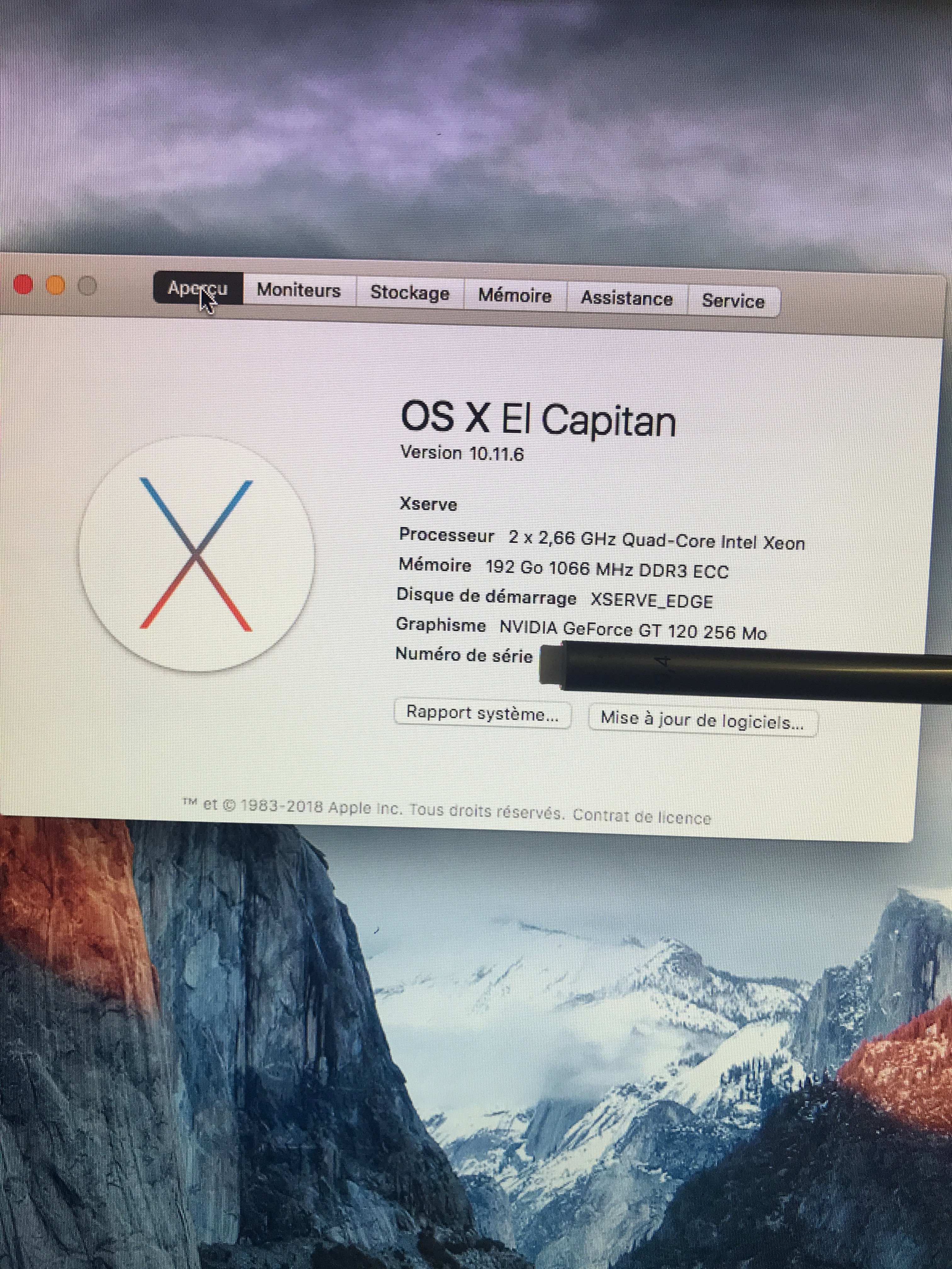

out of curiosity what RAM sticks are you using with your 192GB Xserve configuration? also are you on B06 firmware or the B09 firmware (I do wonder if with the right CPUs like W5590s if 1333Mhz RAM runs at 1333Mhz on the B09 firmware like it does with the MP4,1 B08 Firmware IIRC)
(I wonder if 10.5.8 Leopard still boots with 192GB :D )
Nice can you try some newer osx versions and see if it reads all 192GB?
el capitan is the latest version i can instal on a xserve without patching.
This is my main data backup server with 96tb of backup so i dont want to make it unreliable.
until someone build a firmaware updater to bring the cMP 5.1 v.1.44 fw function to it I will just go up to 8x 3,33mhz
and thats it.
this machine is just a file server and a media encoder. it has a cyclone pcie expender on one slot and a nvidia tesla
s2070 4gpu 1 u chassis (upgraded with rx580) on the other so it is pretty much all it has to give.
until we can put 2 x5690 it doesn’t need mojave.
[doublepost=1563855455][/doublepost]04DE88DE-AEBE-4AF1-9073-98ABBA804B93.jpeg
using those in conjuction with some micron ones but same HP sku

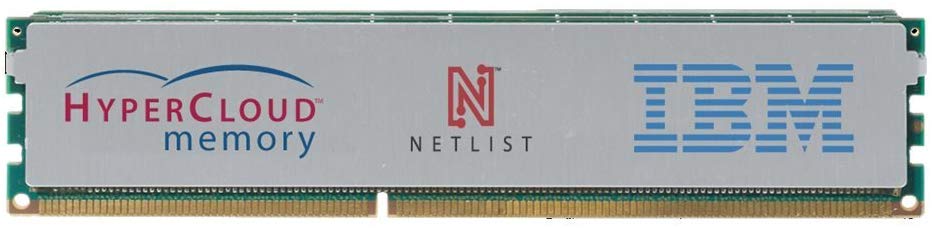

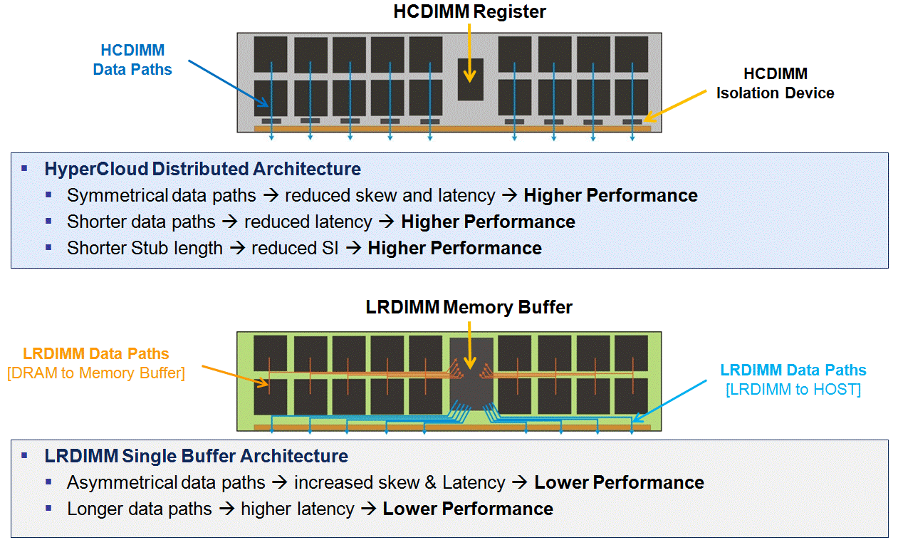

im still waiting for someone to try HCDIMM in the MP5,1
LRDIMMS are old garbage tech when populating slots with reduced speeds down to 800MHz even..while HCDIMM stays at 1333MHz populating all 8 slots in theory.
Its what ddr4 eventually adopted √√
Anyone got a hold of any for testing ?
