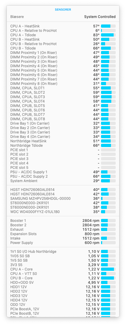

I haven't had any issues with ♨️🔥 as far as I can tell 🙏🏻

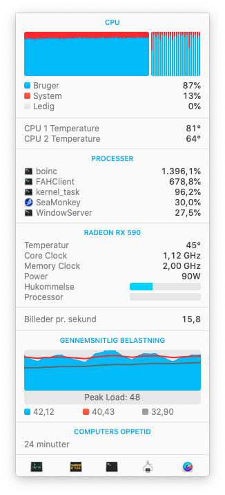

AFAIK you're the first person that got the 32GB DIMMs working perfectly , kudos!
As mentioned by @RAMtheSSD too, i was curious about Temps .
Looking at the Temps , i wonder if the screenshot was taken at idle ?
Delta CPU A is 26degrees, delta CPU B is 16 degrees.
I would consider a repaste of the CPU heatsinks .
Delta NB is 15degrees , imo the limit , personally in case of a repaste CPUs, i would repaste the NB heatsink too , and (if not done already) replace the rivets.
DIMMs slot 1-4 are 55-59 degrees and much higher than slot 5-8 (41-44).
Although ambient T is 29degrees, this is IMO still high (if at idle) , but could be related to bad Delta CPU A.
PSU S2 ( the one that seems to heat up more depending on GPU powerdraw and CPU load ) is 66degrees.
The PSU fan is set to 600 (fixed i guess), i would recommend to set this fan depending on PSU supply 2 Temp or on default to avoid further decreasing expected life time of (especially the capacitors in) the PSU.
These are just some thoughts a bit off topic, but with best intentions :)

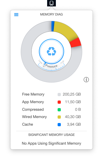

My cMP is 🤓always🤓 running at 💯 CPU as I'm contributing to both
They both throttle down when other processes needs the CPUs
As to the fans, I haven't messed around with any settings at all.
As to the CPU 🌡 I had been wondering about the differences & had considered a re-paste ; but being unsure about my own skills in that regard, I've held off doing it. I bought my cMP from a reseller in 🇬🇧 w/ the CPU upgrade installed.

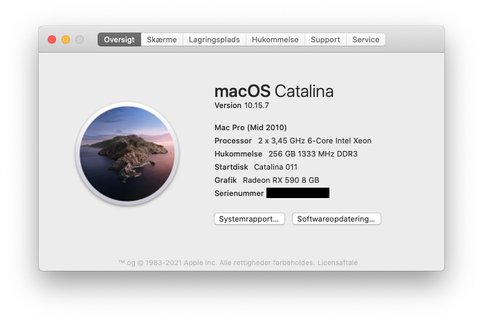

@KeesMacPro : Thanks for the kudos 👍🏻🤓
But the real kudos should go to @h9826790 for his work in https://forums.macrumors.com/thread...n.2180095/page-53?post=28255048#post-28255048 and the OpenCore team 🤓👍🏻 I've just used some 💰💸

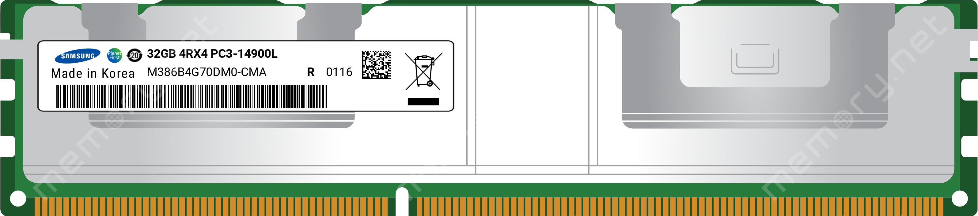

i need some help from you experts:
I have a 4,1>5,1 dual X5550 2.66, it came with 4x 2Gb sticks and booted up fine.
Now I am trying to use some known good 32Gb ram sticks that I already have (tested on other machine) but they are 1866mhz Samsung (M386B4G70DM0-CMA4) and they dont work on this 4,1>5,1. I read @edgerider in post #138https://forums.macrumors.com/thread...a-cmp-anyone-tried-this.2046693/post-27562852
that samsung 1866 should work?
Test1: 4x 2Gb + 1x 32Gb: El Capitan booted up OK and recognized only the 4x2Gb = 8Gb. The slot where I put 32Gb will show empty.
Test2: 1x 32Gb: machine turn on with blinking power led
Test3: 8x 32Gb: machine turn on with blinking power led
Test4: 3x 2Gb + 1x 32Gb: recognize only the 6Gb.
Any idea?

woah it was a long time ago in my xserve and with 16gb if I recal correctly (dont quote me on this) dont think the issue is the frequency here, as stated below if you want to go over 16gb per stick, you need to use a trick to let the machine know what it is because it only knows 16gb stick...
remenber that back in the day 32 gb didnt exist, let alone that 16gb where like a grand pièce...
But from recent developments on this thread (see above), others are able to boot up with 32Gb sticks..
Kon_Kipa can get 160Gb working with a 4,1>5,1 so a flashed 4,1 should not be the issue.
I wonder if the problems come from:
A) my CPU: Can X5550 support these? But if Kon_Kipa can get 32Gb stick working with his E5520, then I suppose the X5550 can do so too?
B) The ram type and timing? Is there a way to change the timing on the SPD on these sticks?

I suspect it is the ram and they are too fast and dont support lower speed in SPD table?
@BjarneDM when you have full 8x32Gb in there.. what is the clock speed of the memory?!
@protocold

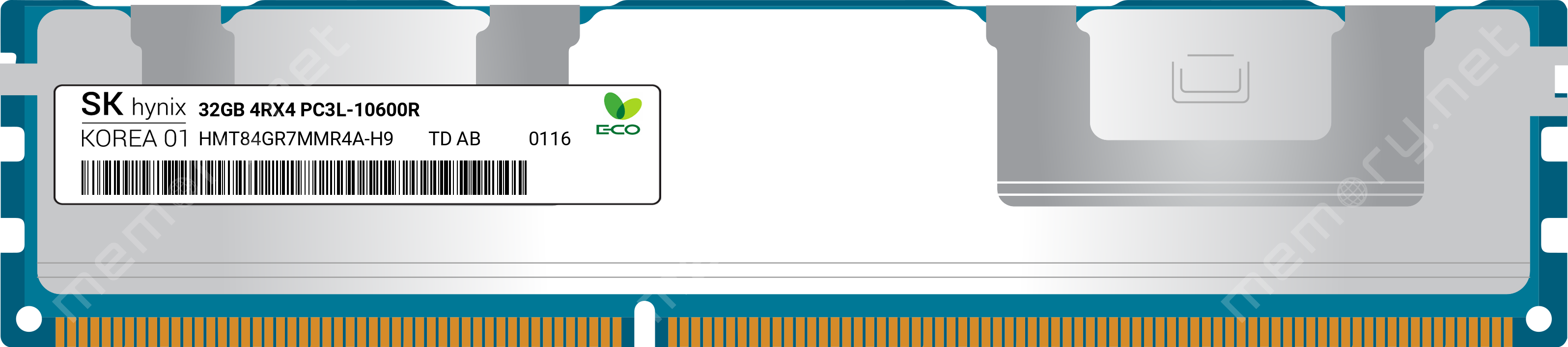

When comparing your and my memory sticks, we have :
there're two differences :
  1. clock speed : 1866 <-> 1333
  2. type : lrdimm <-> rdimm
(1) ought not to be an issue : https://www.ifixit.com/Answers/View/528682/Can+I+use+PC3L+12800S+RAM+in+place+of+PC3+10600S+RAM
(2) this is the issue as far as I can see : from https://en.wikipedia.org/wiki/Registered_memory "Both FB-DIMMs and LR-DIMMs are designed primarily to minimize the load that a memory module presents to the memory bus. They are not compatible with R-DIMMs, and motherboards that require them usually will not accept any other kind of memory modules."
The motherboard in a cMB can accept -either- ddr3 udimm -or- ddr3 rdimm. 16GB sticks exist in both specifications; 32GB only in rdimm. You can't mix udimm & rdimm. & it looks as if 32GB is the max size for rdimm - higher capacity is lrdimm.
The clock speed of the memory in my cMP is 1333 because that's the specification of both the motherboard & the memory sticks. Generally, the memory will run at the minimum of the clock specification of the motherboard and the memory sticks.
But whether it's (1) -or- (2) is irrelevant : if Linux can't see the sticks & you've also got red lights on the motherboard - the 32 GB lrdim's you've got don't work in a cMP 👎🏻
On the other hand you've saved me some 💰 as my next experiment would have been to try 64 GB lrdimms. If your 32 GB lrdimms don't work, then 64 GB lrdimms also won't work 🤓😢😭
