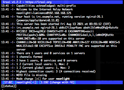

Not exactly. The goal, described in the opening post, was to ultimately get irssi running on the PowerPC Mac running Snow Leopard 10A96.
What I have done since the other day is the following:
  1. I made a list of all the source code tarballs I compiled from scratch last week (back when I was still working with the first compile-build of Macports2.7.1, and I also added to that list all the source code tarballs I couldn’t compile.
  2. Next, I used Macports on another PowerPC Mac running Leopard (and thus, Darwin9) to run “port pkg [portname_of_tarball_from_#1]” on each item in that list. I chose overkill to err on the side of the precautionary principle.
  3. Then, I installed each of those, individually, on the PowerPC Mac running Darwin10/10A96. I installed each of the three items you listed in addition to everything I had built — or tried to build — in #1.
  4. Because I learnt earlier how the current irssi_1.2.3 is having basic functionality issues across all my PowerPC Macs — at least, as installed via Macports (on Darwin8, Darwin9, and Darwin10 PowerPC Macs, with Darwin10 install failing following a “port mpkg irssi” made on the Darwin9 Mac) — I manually compiled its predecessor, irssi_1.2.2, on the Darwin10 PPC earlier today.
So in short:
The only method I can see which affords a reasonable ability to build anything more substantial than standalone “noarch” ports on Snow Leopard for PowerPC (Darwin10) is to first use Macports on a PowerPC Mac running Leopard to generate .pkg installs for each individual component required to build a target-something/application. This isn’t what I wanted ideally, but the Macports team never foresaw the possibility of PowerPC Macs successfully running a version of Snow Leopard and, thus, never made ports available for use on Darwin10/PPC.
Sure, that something could also be installed from a .pkg generated by a Leopard Macports instance, but given the problems of using the port pkg of irssi_1.2.3 — the ultimate thing I wanted to build here — I chose to configure and make that application manually on the SL-PPC Mac so that I could rule out that aforementioned flaw in a pre-made port or a buggy version being the culprit.
And so, as connected to an ngircd instance on another Mac in my LAN, minutes ago:
Where I’m from, that’s good enough for now.
