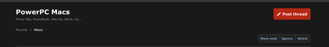

It seems I cant make a new topics
You can.
Use the “Post thread” button (in red) on the forum index page.
Reactions: Amethyst1
