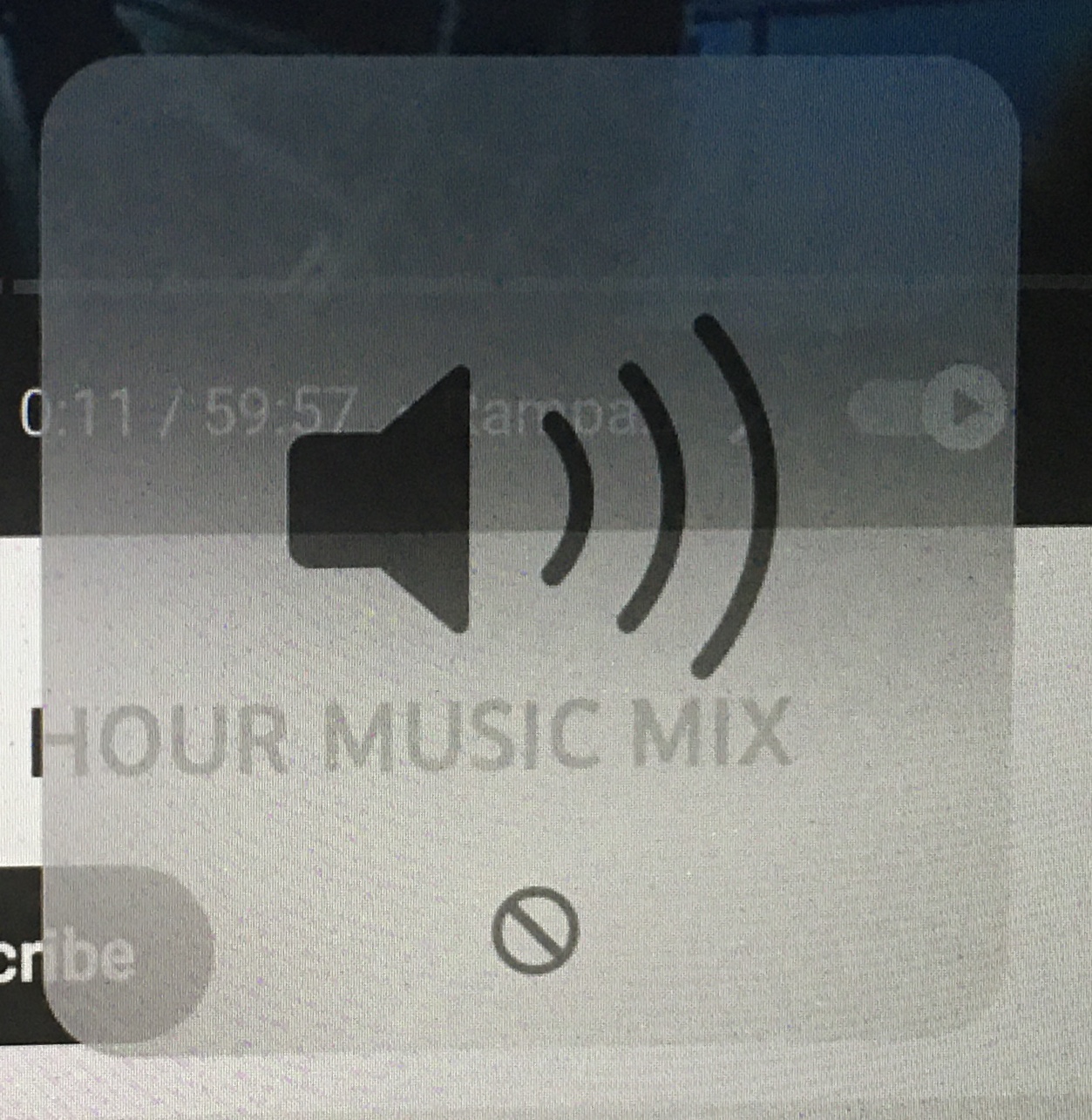

I get this icon when I try to raise the sound. Of course there’s no sound heard at all. Its as if the MacBook don’t have any speakers. It’s a 12" Retina Early 2015 MacBook.

Does it mean something if not being in any of the two?

in the Audio MIDI I can’t see them either.
one is supposed to see interfaces not speakers. and yes - one can "delete" interface ( though not supposedly easy to do for the built in )
depends on what shows in audio and midi ( and or sound panels in settings) though most likely speakers itself are fine. A bit more likely an incorrect sound output selected ( say HDMI if you have it plugged in, or some spyware software issue )
also - try to find system profiler / system information app ( macOS version dependant) - under hardware there is an Audio line - the contents should be telling.
a bit more likely - a burnt audio chip/some electronics - have happened before - like when audio out is plugged to external speakers - is more model dependant - run a diagnostics.
more likely still there is a debris in the sound out port so that the plug "thinks" its an optics ( spdif) plugged in - try plugging in/out headphones couple dozen times with a visor though try not to break smthing.
even more likely than those - there is some permissions / kext issue - like some software installed - like which has an audio extension which is selected though not authorised yet - does the startup chime sound - try resetting pram ( again - model dependant) - after the 3rd or 4th cycle is should sound regardless of setting set previously.
more - try SMC reset ( or AS M1 M2/ T1 / T2 equivalent) (successful diagnostics is supposed to do just that once you hit shut down there )
Other that that - its hardware problem - usually irreversible and a main logic board is going to be replaced- if not under warranty - find some suitable external USB audio interface...
