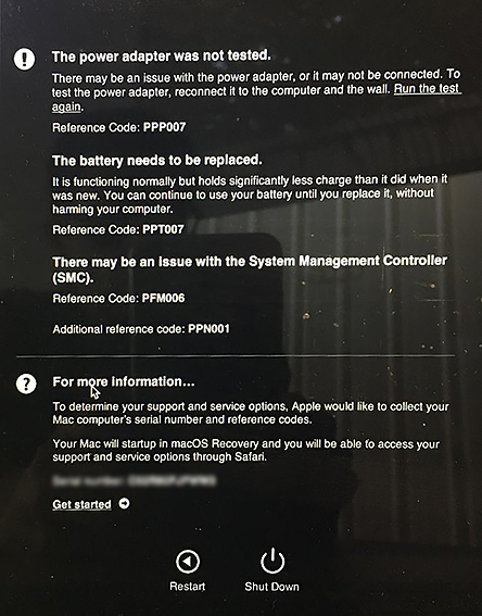

#BrianBaughn Ive done the Diagnostic Test

But, looking into those reference codes that you found after running diagnostics - PFM006 and PPN001 - are pointing to possible hardware problems. Other mentions on the 'net about those codes sometimes find that the battery may need to be replaced (and your test also reported that the battery is holding significantly less charge than when it was new. If you have not inspected the battery recently for swelling, that might be a good plan to check that ASAP.
I would also suggest that you could try an alternate app that offers some form of diagnostic, such as TG Pro, with the theory that you would have a second "opinion" on what is happening.

That battery that’s been tested now, is the new battery that I replaced the swollen one! You believe there’s an issue with the new one? 😳
