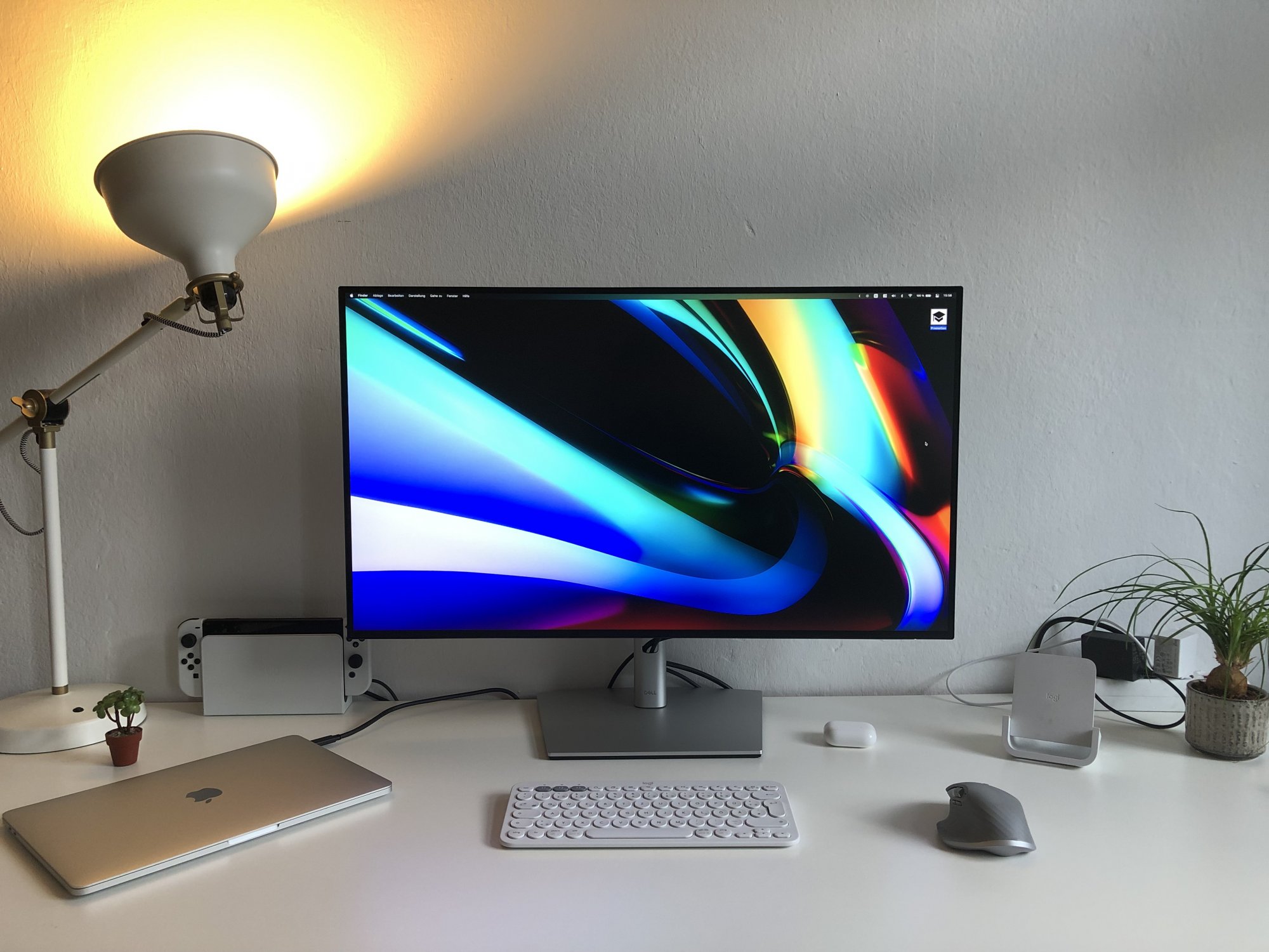

My Dell U3223QE arrived this morning already!
First impressions:
- colours and blacks looks beautiful (the package included a report of the factory calibration)
- build quality and design look great on first appearance (much better than the LG 32UN880 I had previously tried out); no dead/ bright pixels spotted

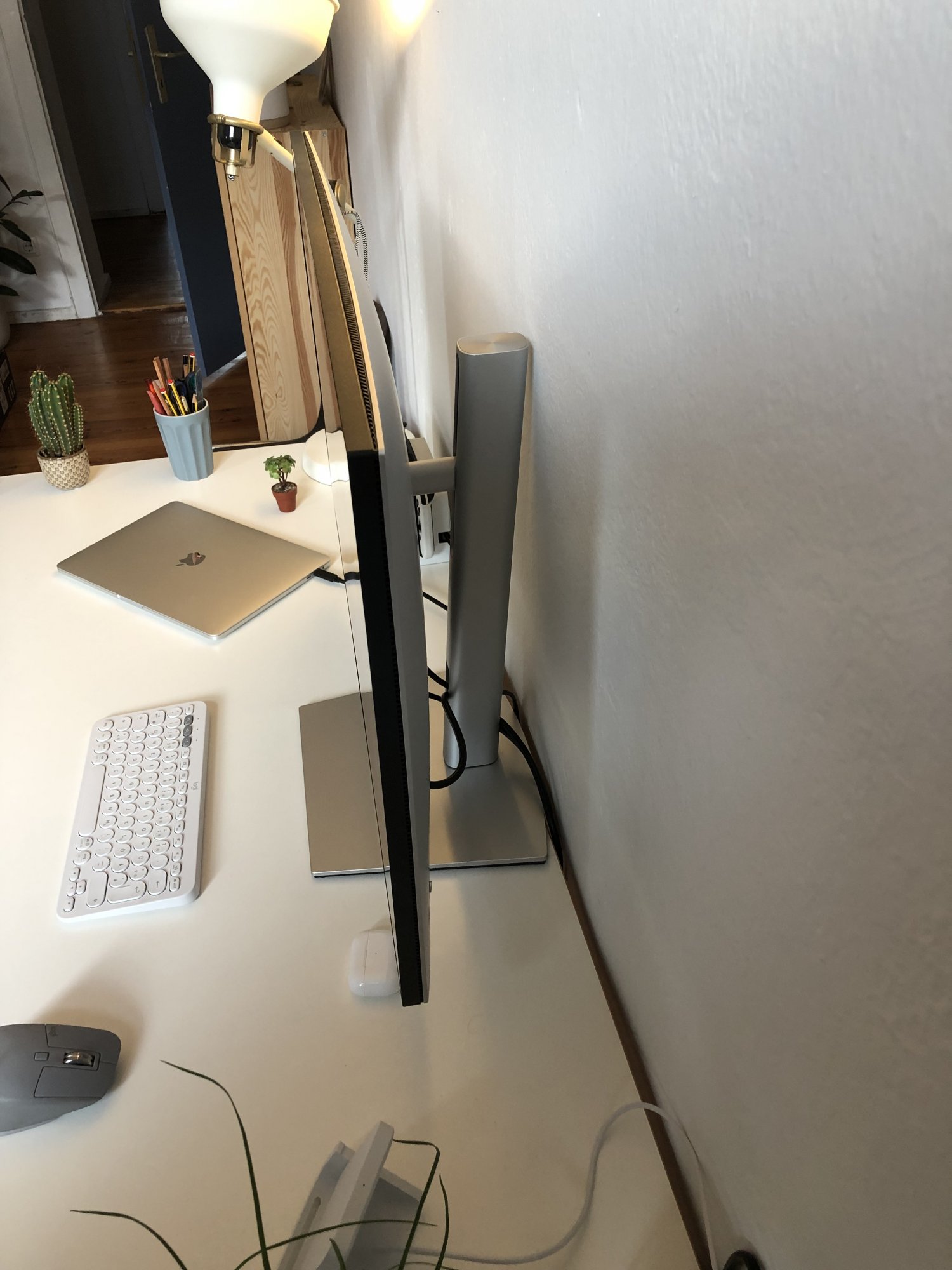

- the stand is quite heavy and deep (actually a bit deeper than I'd want, but still fine)
- I have it set to "looks like 2560x1440" which is perfect for my eyes; screen size seems perfect as well, very glad I opted for the larger one (sitting around 70-80 cm away from the screen)
- performance on my 2018 13" MBP (8 GB Ram) seems fine using the scaled resolution; no noticeable lag, though I haven't pushed the system properly yet
Will post more details once I've spent a few days with it :)
