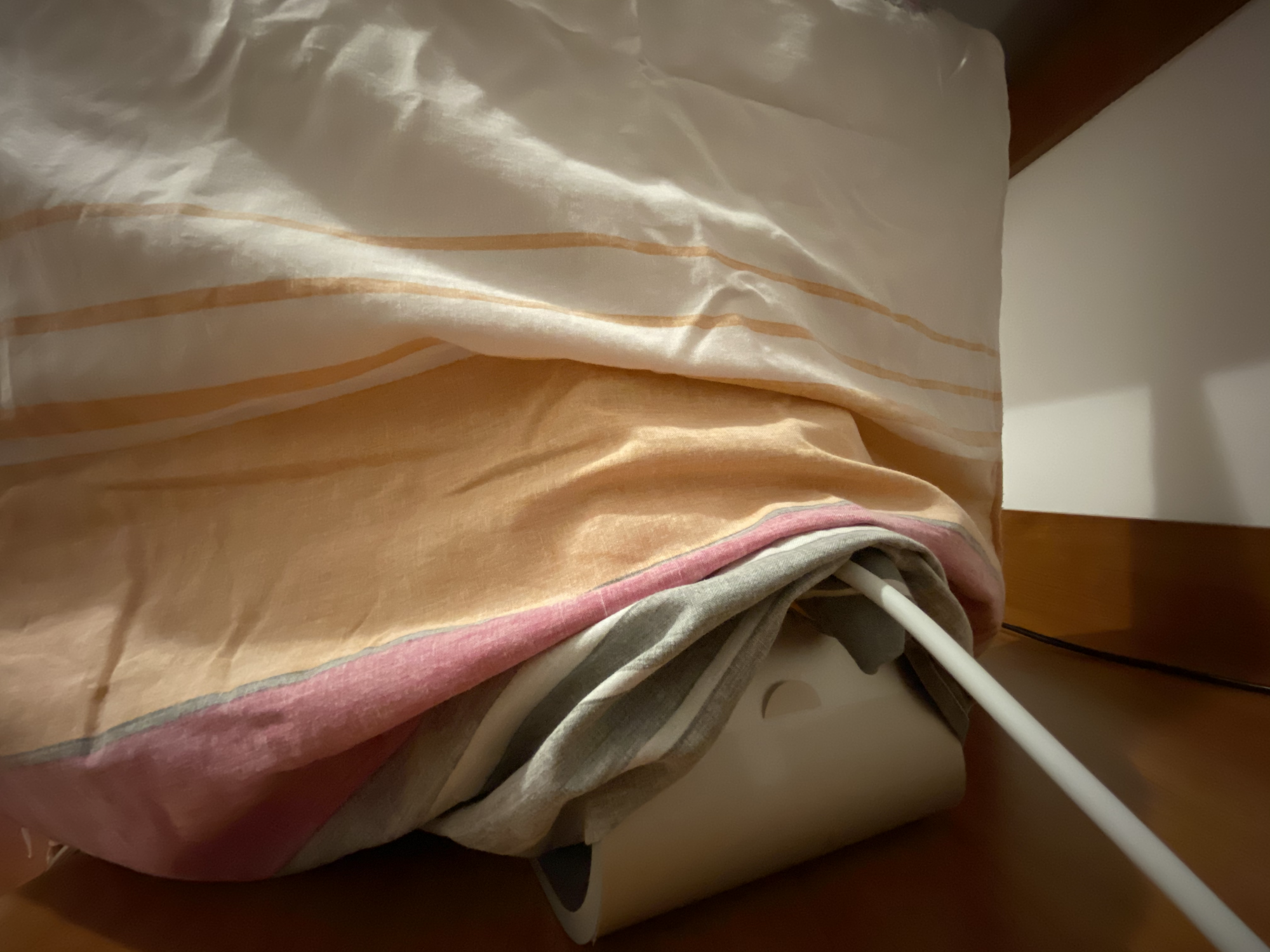

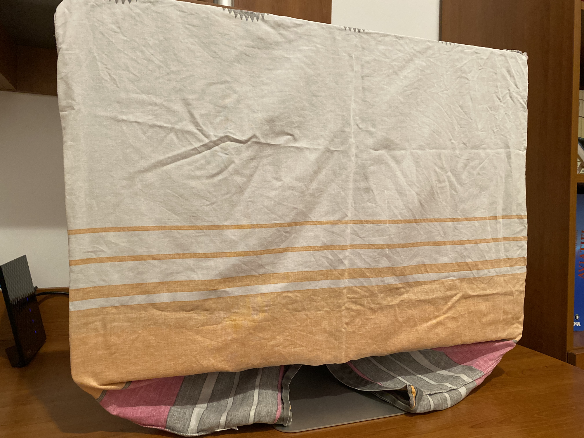

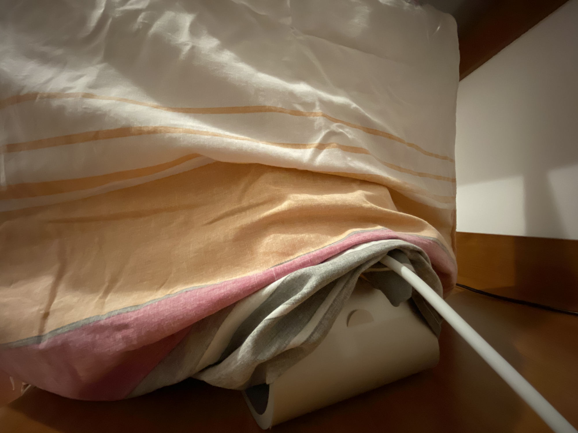

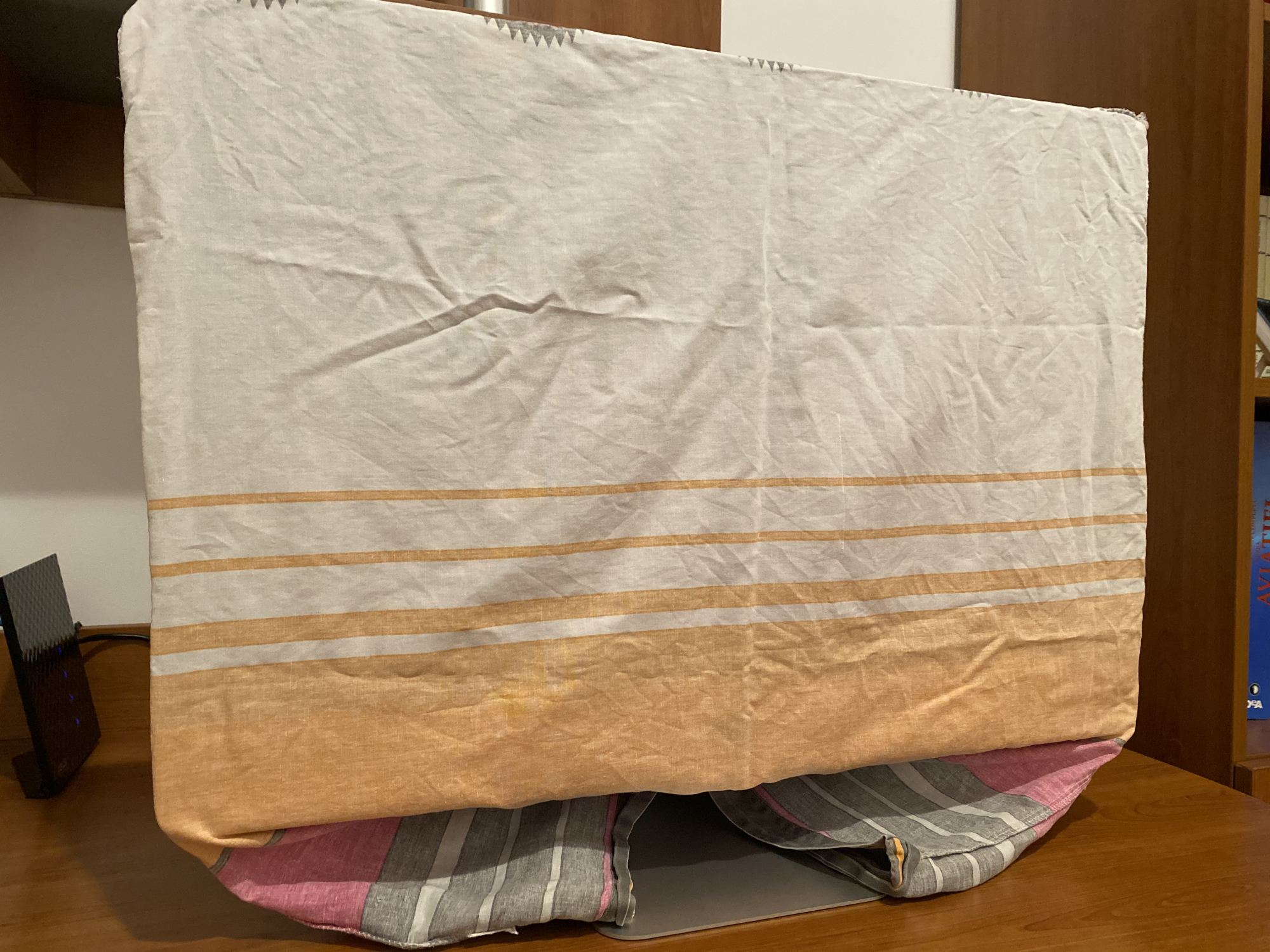

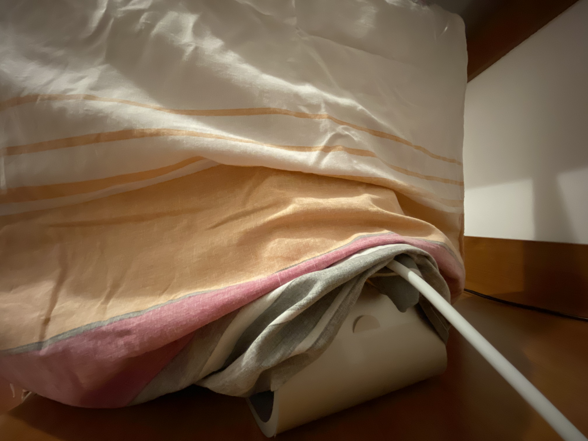

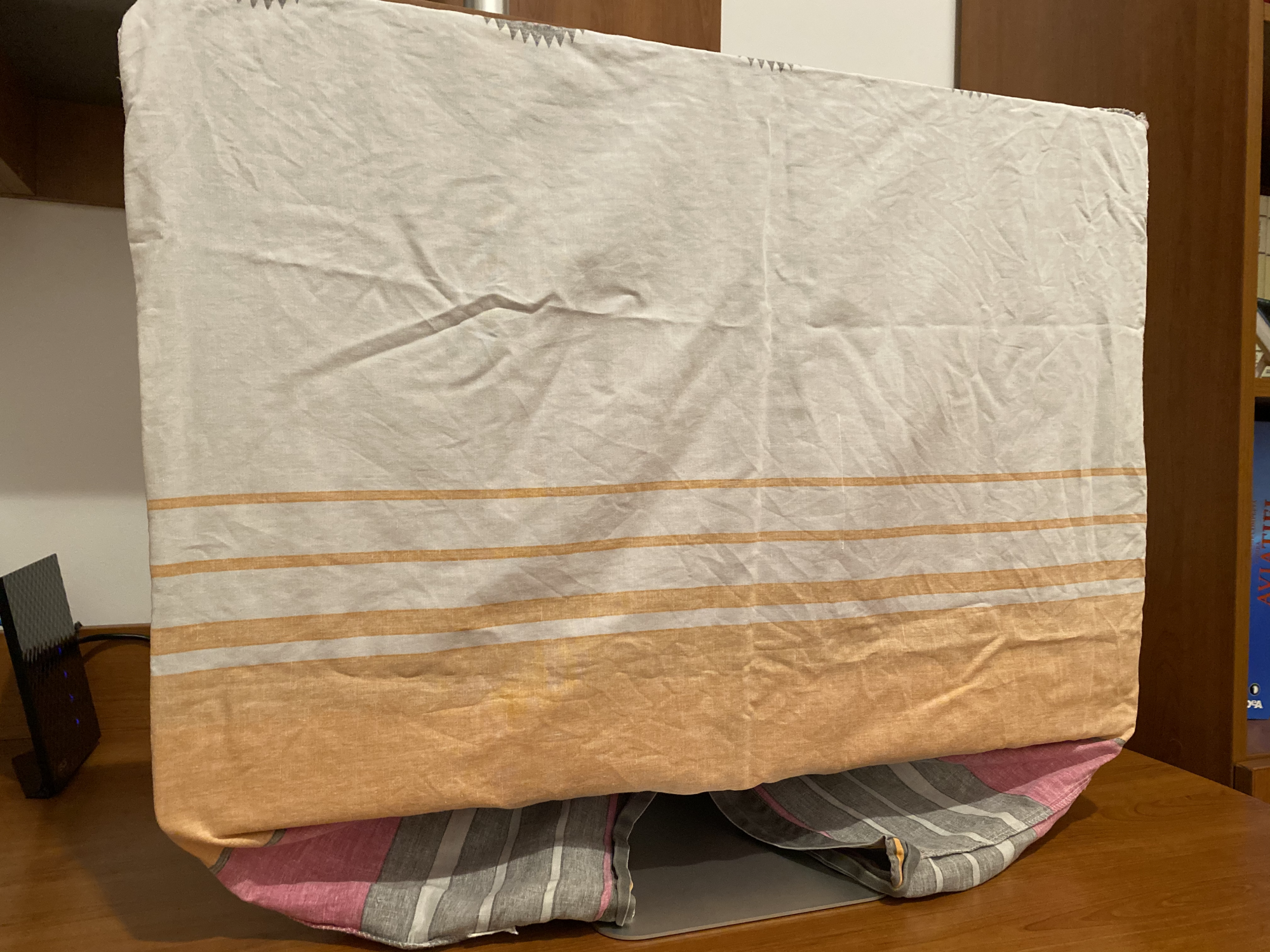

I always use a pillow cover after shutting down my iMac and run the vacuum cleaner once a month on the BOTTOM vents ONLY. Besides, I use a damp cloth almost every other time I power up the machine to keep my desk as free of dust as possible.
I applied this "recipe" ever since I received my 2020 iMac last September and I am yet to see any clouding or unwanted spots on my screen. There is only some super slight vignetting effect in the lower corners of the screen, but I noticed this ever since I received the iMac and it didn't get worse nor it disappeared. It doesn't bother me at all as the vignetting is incredibly faint and one needs a bright background to be able to see it.
Attaching some pics to show how my iMac looks like with the pillow cover. Note that I am taking advantage of the hole at the back to position the cover in such a way that the lower vents are completely covered.

That is terribly ugly.
There are premade products with the same function. Or you can just ask you friend who can sew to make one for you.
Reactions: costica1234
Yep, I know it's super ugly, but the pillow cover does the job and it was... free 🙂. I've seen a slick iMac cover for like $30 here in Romania, but I'm not sure if it's worth it. Might consider it down the road, though.
Yeah, please don't show that to Jony Ive 🙂
Effective, though
Thank goodness I don't have his number 🤣🤣.
