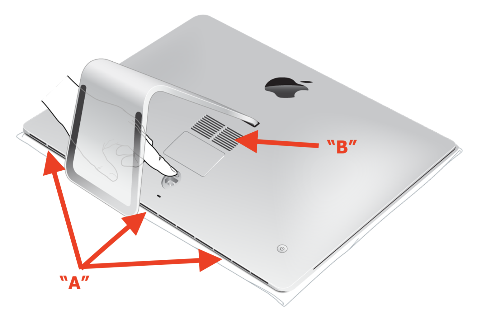

I only use the Vacuum on the back exhaust vent ("B")
I use the Vacuum and Compressed Air on the bottom intake vent ("A")

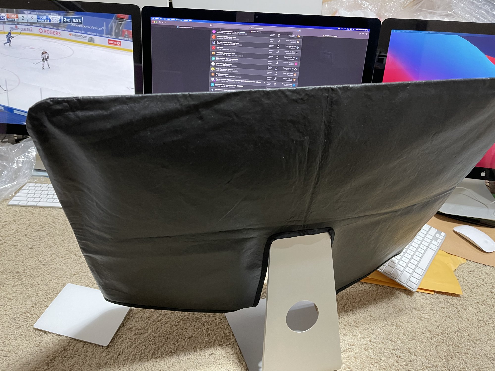

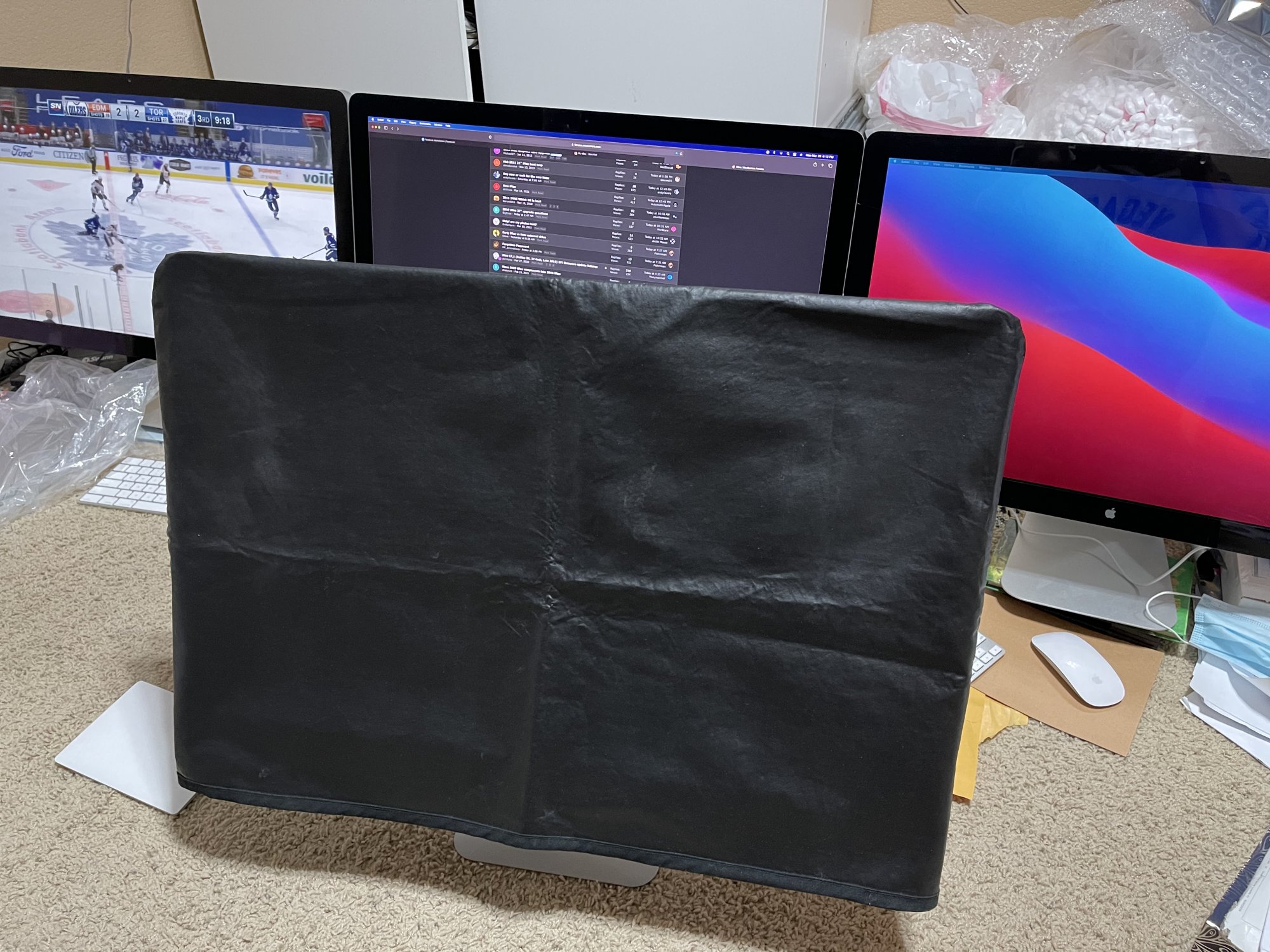

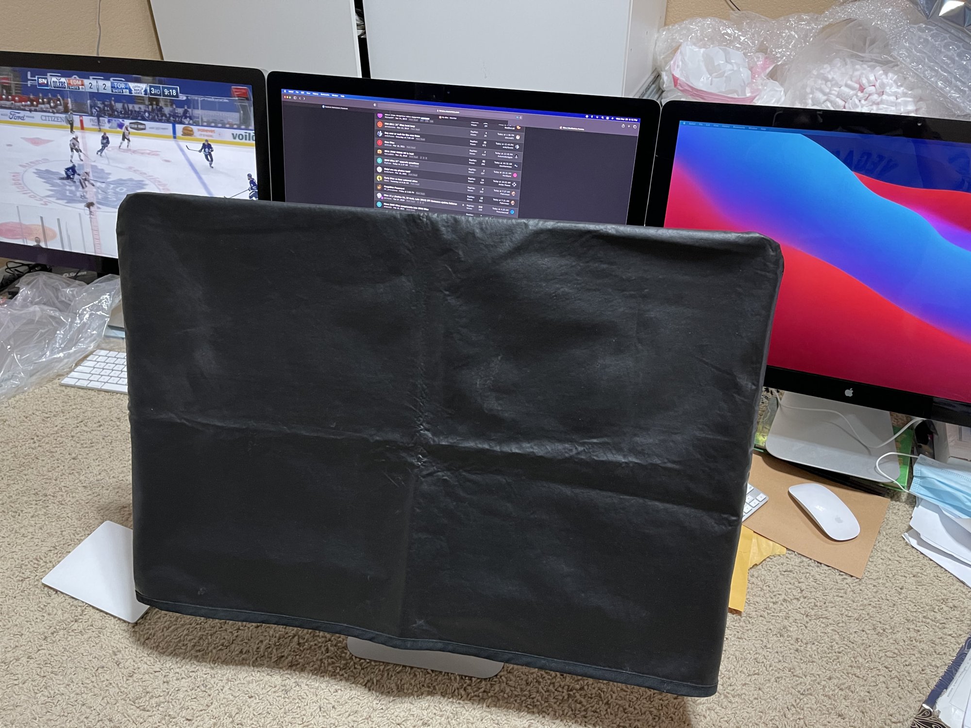

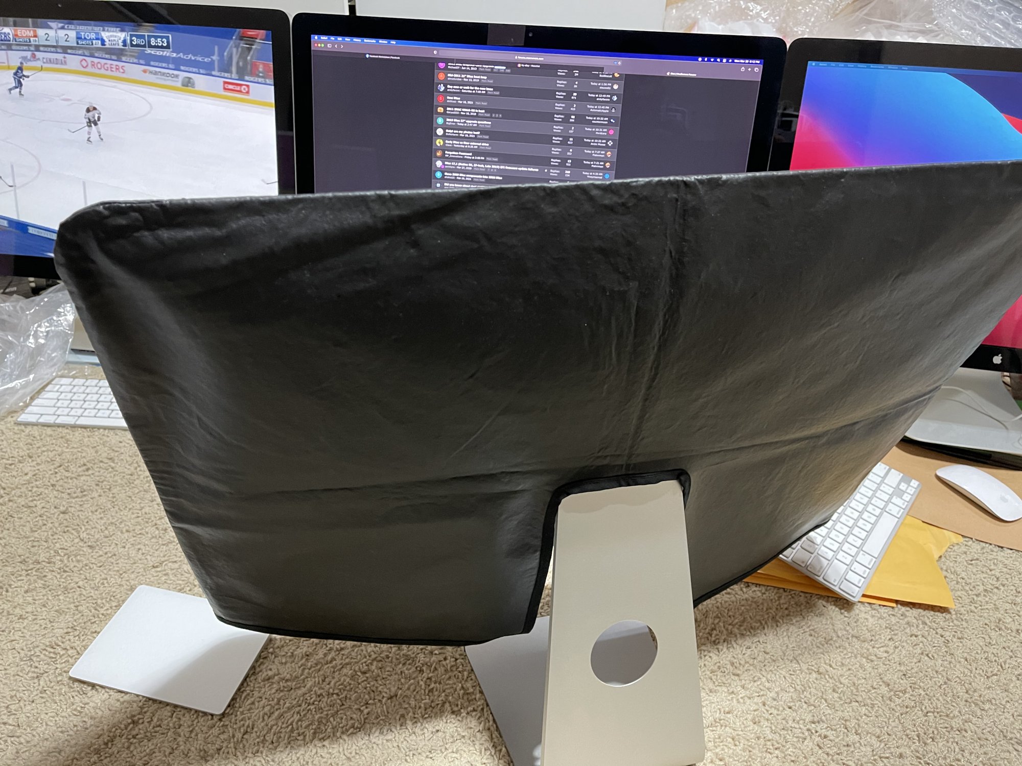

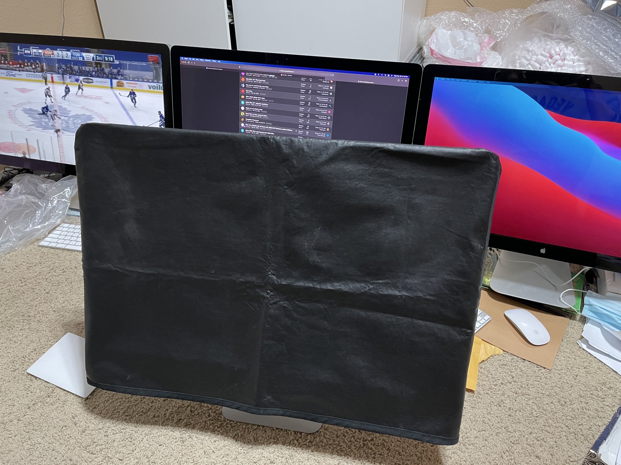

I forgot where I got this leather cover
