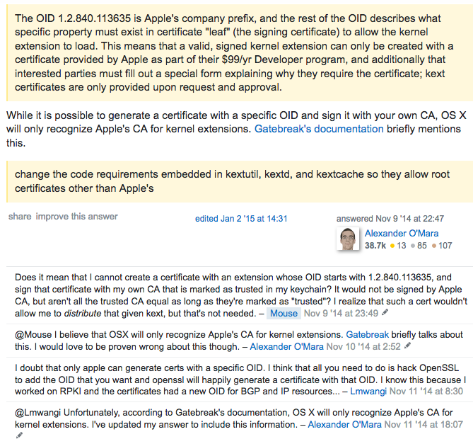

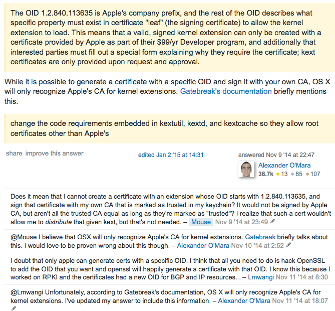

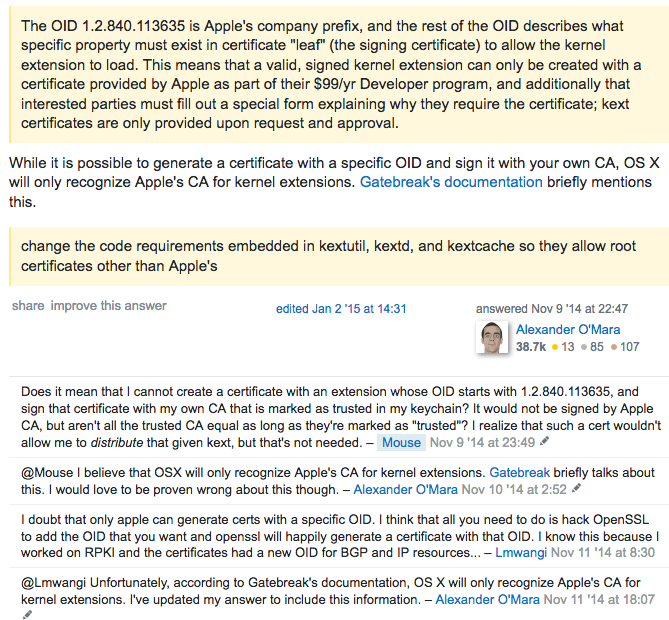

Addendum:
Found this discussion on Stackoverflow. It's a bit old, but it addresses the reason why kext signing isn't as easy as it sounds, since apple does not allow/no longer allows non-Apple kext at all.
Like the sudo command tell a sudoer the first time he runs it interactively: “With great power, comes great responsibility”.
Apple is not telling you not to develop kexts but it’s saying that it lays on your side to inform clearly and faithfully your users of the risks of your third party kext and collect from them corresponding waivers of responsibility.
Only if your information is false or you or any third party use your kexts for nefarious ends then you will feel the power of all mighty Apple fall on you. That’s what Apple should do, police the development of kexts to avoid their voluntary nefarious usage to harm the users.

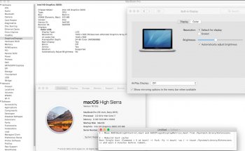

HighSierra 10.13.5 - Macbook Pro 15 Early 2011:
/System/Library/Extensions/AppleGraphicsControl.kext/Contents/PlugIns/
Who shows or does not show the Brightness Slider are the AGDCBacklightControl.kext and AGDCPluginDisplayMetrics.kext.
These two kexts do not exist in El Capitan or Sierra.
I've moved these two kexts -> rebuild cache -> and the Brightness Slider has reappeared. But it has no effect on brightness. But it is a breakthrough in the problem.
It is necessary to rebuild the cache so that the slider appears again:
Boot Single User (Command + S at boot) -> fsck -fy -> mount -uw / -> touch /System/Library/Extensions -> and wait 2 minutes before reboot.

I solved the brightness control problem in High Sierra 10.13.6 with all the updates installed (10 / August / 2018) with AMDGPUWakeHandler.kext without GRUB Solution. Yes, only AMDGPUWakeHandler.kext
(source code changed).
Works brightness slider and F1 / F2 keys.
In the High Sierra (10.13) the brightness control is done by AGDCBacklightControl.kext.
The AGDCBacklightControl.kext is connected to the AMD6000Controller.kext.
The AMD6000Controller.kext has the dependent kexts: AMDLegacySupport.kext and AMDLegacyFramebuffer.
If you use GRUB Solution at boot (grub.cfg), then your AMD GPU will be Power Off and the AMD6000Controller.kext will not be loaded at boot time.
Consequence: you lose control of brightness.
It was necessary to change a portion of the AMDGPUWakeHandler.cpp source code. See the description below.
I'm going to make a video this saturday of how AMDGPUWakeHandler (AMDGPUWakeHandler.cpp) was changed and compiled.
I do not tested the Computer Sleep.
Still in the test phase.
Tested machine:
  • Macbook Pro 15" Early 2011 - Intel HD Graphics 3000 (Device ID: 0x0126) / AMD Radeon HD 6750M (Device ID: 0x6741)
  • Model Identifier: MacBookPro8,2
  • File System: APFS (Encrypted)
  • Boot ROM Version: MBP81.0050.B00
  • SMC Version (system): 1.69f4
  • System Version: macOS 10.13.6 (17G65)
  • Kernel Version: Darwin 17.7.0
  • XCode 9.4.1 (9F2000) - Necessary to compile the changed source code of AMDGPUWakeHandler.kext.
    https://github.com/blackgate/AMDGPUWakeHandler
  • Only AMDRadeonX3000.kext has been moved from /System/Library/Extensions to /DisableExtensions . Otherwise Macbook Pro will freeze on the gray screen during normal boot.
    See MikeyN Guide - create directory and move AMDRadeonX3000.kext .
  • SIP must be totally disabled to move the AMDRadeonX3000.kext. Otherwise you will receive the message: Operation not permitted.
Boot Recovery Mode (press Command + R at boot) -> Utilities -> Terminal:
Code:
csrutil disable
reboot
After you move AMDRadeonX3000.kext, you can partially enable SIP in Recovery Mode for more system protection.
Loads unsigned kexts - AMDGPUWakeHandler.kext .
Code:
csrutil enable --without kext
reboot
The AMDGPUWakeHandler.cpp makes a condition before to see if the AMD GPU continues with Power On. If so, the AMDGPUWakeHandler.kext is not loaded.
Messsage log: Failed to Load. Discrete GPU was powered on.
It is necessary to change a portion of the source code so that AMDGPUWakeHandler.kext is loaded with the AMD GPU with Power On.
https://github.com/blackgate/AMDGPUWakeHandler/blob/master/AMDGPUWakeHandler/AMDGPUWakeHandler.cpp
Original AMDGPUWakeHandler.cpp: if (get_discrete_state() != 0) {
Modified AMDGPUWakeHandler.cpp: if (get_discrete_state() == 0) {
After manually loading the AMDGPUWakeHandler.kext, then the AMD GPU goes to Power Off. Temperature check by IstatMenu 5.32 - Sensors: GPU Die Analog.
0 - Remembering that it is mandatory set up gpu-power-prefs to Intel GPU - Boot in Single User Mode (press Command + S at boot):
Code:
nvram fa4ce28d-b62f-4c99-9cc3-6815686e30f9:gpu-power-prefs=%01%00%00%00
1 - Partially disabled SIP (Loads unsigned kexts - AMDGPUWakeHandler.kext)
SIP totally disabled (csrutil disable) -> less system protection. It is not good.:
Code:
reboot
Boot-args only with verbose:
Code:
nvram boot-args="-v"
or
Code:
sudo nvram boot-args="-v"
2 - Manual loading of AMDGPUWakeHandler.kext (modified) with kexutil - after boot normal -> login -> Finder -> Applications -> Utilities -> Terminal:
Code:
sudo kextutil /Users/Shared/AMDGPUWakeHandler.kext
Kext with invalid signatured (-67062) allowed: <OSKext 0x7f868ac11290 [0x7fff9d67faf0]> { URL = "file:///Users/Shared/AMDGPUWakeHandler.kext/", ID = "io.github.blackgate.AMDGPUWakeHandler" }
Code Signing Failure: not code signed
3 - Verify that the AMDGPUWakeHandler.kext has been loaded:
Code:
kextstat | grep -i AMD
com.apple.kext.AMDLegacySupport (1.6.8)
com.apple.kext.AMD6000Controller (1.6.8)
com.apple.kext.AMDLegacyFramebuffer (1.6.8)
io.github.blackgate.AMDGPUWakeHandler (1)
4 - View log AMDGPUWakeHandler.kext last 1 hour:
Code:
log show --last 1h --predicate 'senderImagePath contains "AMDGPUWakeHandler"'
Filtering the log data using "senderImagePath CONTAINS "AMDGPUWakeHandler""
Skipping info and debug messages, pass --info and/or --debug to include.
Timestamp                       Thread     Type        Activity             PID    TTL
2018-08-10 21:53:23.013052-0300 0x1979     Default     0x0                  0      0    kernel: (AMDGPUWakeHandler) Initializing
2018-08-10 21:53:23.013067-0300 0x1979     Default     0x0                  0      0    kernel: (AMDGPUWakeHandler) Probing
2018-08-10 21:53:23.013080-0300 0x1979     Default     0x0                  0      0    kernel: (AMDGPUWakeHandler) Starting
2018-08-10 21:53:23.013198-0300 0x1be      Default     0x0                  0      0    kernel: (AMDGPUWakeHandler) Waking up
2018-08-10 21:53:23.013202-0300 0x1be      Default     0x0                  0      0    kernel: (AMDGPUWakeHandler) Disabling GPU
Log      - Default:         10, Info:                0, Debug:             0, Error:          0, Fault:          0
Activity - Create:           0, Transition:          0, Actions:           0
5 - View kextstat AGDCBacklightControl.kext - This kext is responsible for the brightness control (High Sierra - 10.13):
Code:
kextstat | grep -i Back
com.apple.driver.AppleBacklightExpert (1.1.0)
com.apple.driver.AGDCBacklightControl (3.20.13)
6 - System Information -> Software -> Logs -> IORegistry Contents -> AMDGPUWakeHandler:
Code:
+-o AMDGPUWakeHandler  <class AMDGPUWakeHandler, id 0x10000064a, !registered, !matched, active, busy 0, retain 5>
            "IOProbeScore" = 0x0
            "CFBundleIdentifier" = "io.github.blackgate.AMDGPUWakeHandler"
            "IOProviderClass" = "IOResources"
            "IOClass" = "AMDGPUWakeHandler"
            "IOMatchCategory" = "AMDGPUWakeHandler"
            "IOPowerManagement" = {"CapabilityFlags"=0x2,"MaxPowerState"=0x1,"CurrentPowerState"=0x1}
            "IOResourceMatch" = "IOKit"
Update 1:
You must have in your grub.cfg two options to Power Off the AMD GPU or leave the AMD GPU Power on - High Sierra 10.13.
grub.cfg:
menuentry "macOS with outb - Power Off AMD GPU at boot - lose brightness control HighSierra" {
outb 0x728 1
outb 0x710 2
outb 0x740 2
outb 0x750 0
exit
menuentry "macOS without outb - AMD GPU stay Power On at boot - with brightness control HighSierra" {
exit
