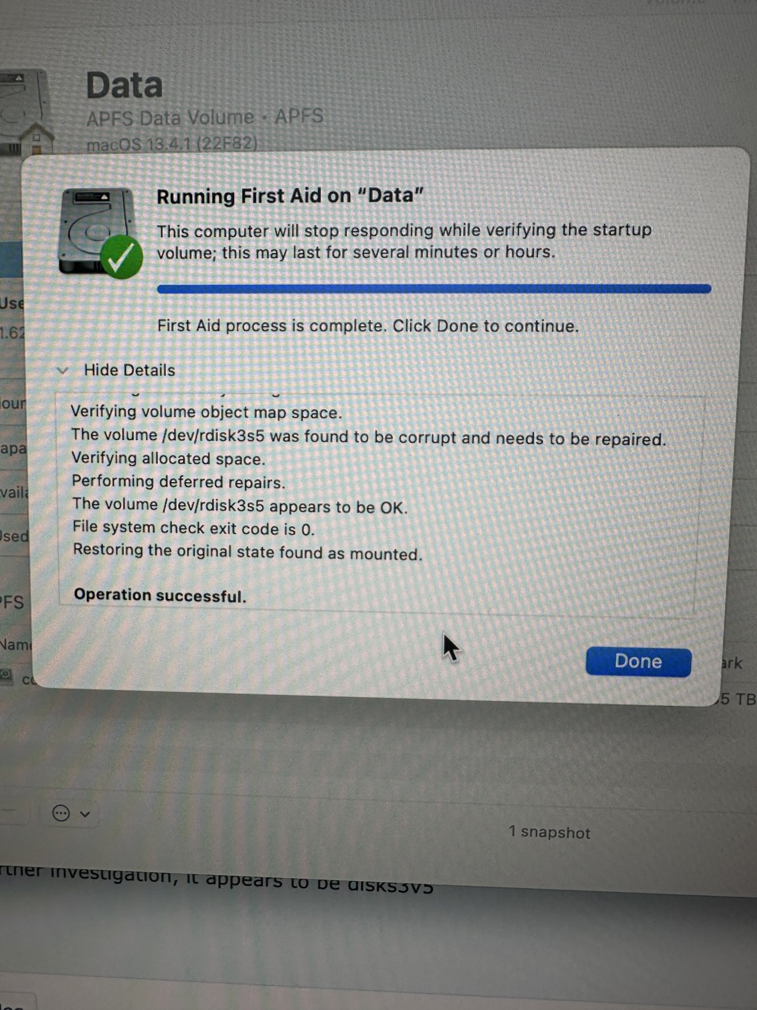

So after further investigation, it appears to be disks3v5

Hey Mike!
Thanks so much for the help!
Annoyingly, I'm getting both, it's so odd.
It's saying it's corrupt and needs to be restored, but then says it's OK afterwards? I've isolated the issue to rdisk3s5.

Please note, I'm not seeing any obvious mac issues, everything seems to be working as is.
I just looked back and see I have also had both the “corrupt” and “OK” messages on the same run, and sent an FB to Apple about it. It can’t be both!

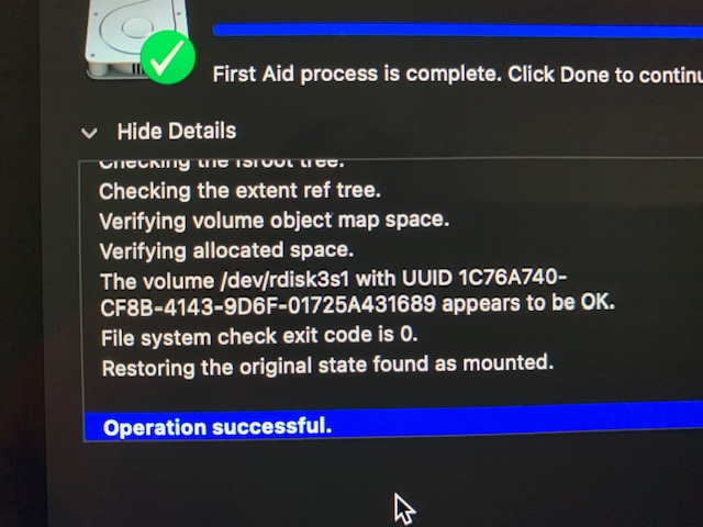

Hi there
I have the same problem and when I ran disk utility before the last line would be "The volume /dev/rdisk1s1 appears to be OK" but after I ran the code:
"diskutil unmountdisk /dev/disk3"
"fsck_apfs -oWT /dev/disk3"
... it changed the last line is "The volume /dev/rdisk3s1 with UUID1c76A ....
Please see attached photo
Any ideas how to change the name of my harddrive back to its original name?
Thanks
Andrew
(New Zealand)

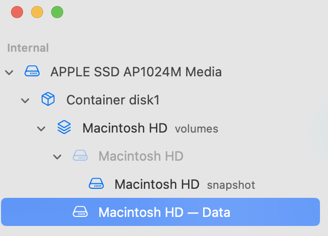

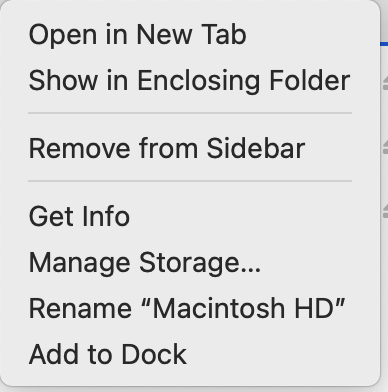

Hi there and thanks for replying. In the finder my hard drive is still named "Macintosh HD"
When I ran the code earlier there were a couple of questions asked relating to the HD and I wasn't sure how to answer so I just typed in "Y". is it possible that stuffed it up?
its more likely that the original errors (and subsequent use of fsck_apfs) fixed a corrupeted disk /file/container name which was part of the original problem.
You should be able to rename the disk in disk utility
edit: in fact i dont think you have anything to worry about as first aid was just reporting the UUID of the volume

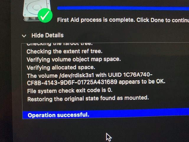

thanks for your advice. in disk utility my hard drive has the right name (see attached photo) What is the UUID? Is there any way to remove it so it doesn't show after my volume/dev/rdisk3s1?
Thanks
Andrew
