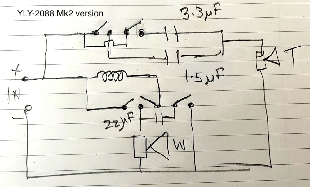

One thing came up as I started to wire up the speakers. Which variant of the YLY-2088 would you use and why?

@drlamb

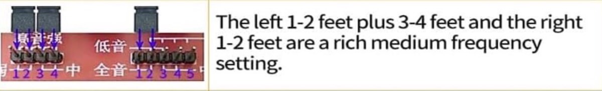

The Mk2 version is (for iMac use) electronically identical to the original one with ABCD jumper settings.
The values are optimal for 8 ohm speakers, so would work best in an iMac with two pairs of speakers in series... 😉
The blue bass-boost capacitor looks to be 22 microfarad in Mk2, but it is 100 microfarad in Mk1.
It is ONLY NEEDED when you are using the crossover with an additional subwoofer circuit (like in a car)... 😵‍💫
To match the Mk 1 version, the #4 is identical to the Mk1 version with jumpers A,B,C and D connected.
This just uses the Tweeter capacitors, but removes the inductor (and the blue bass-boost capacitor) from the circuit.
Removing jumper B in Mk1 inserts the inductor, but with iMac 4 ohm speakers that may cut the midrange response.
To match that with Mk2 use this:
#5 or #6 cannot be matched with the Mk1 version.
Edit: Here's a quick doodle of the circuit:

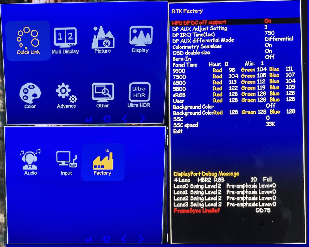

@VegetarianNachos "2. What software should I use to fully check out the display to make sure it is at 5k/60/10?"
What version of firmware are you running?
If the OSD is bright blue and yellow then there is a Factory option on the second page of the OSD options that displays this data.
If your OSD is cyan coloured and says V04 (at the top right of the OSD) then, except for the resolution, this information isn't displayed in the OSD, and you have to analyse test images on the monitor screen to determine the node of operation.
Look at How to Test for Chroma Sub-sampling on this page.
You need to download the test image, and open it in preview at 100% size.
The screen should be set to 5K res, not HiDPI, so 5120x2880;
The image is really small at the correct 100% size.
Then take an iPhone photograph to record the look of the image.
If it is not clear then you are not getting full colour information.

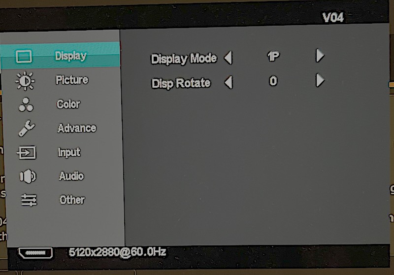

Well that is a bummer. I have the cyan V04 version of firmware. Brightness keys are not working from the keyboard, and I did buy the board directly from StoneTaskin.
@VegetarianNachos You need to download Better Display (from GitHub, the free version is enough) to get keyboard control.
It's called DDC/CI and BD has an auto-configure tab to get it working.
BD also allows you to set different colour modes, which helps to test what you are getting on-screen.

Looks like it is working at 5k/60/10 okay. Now I just need to figure out how to attach the crossover boards. Thanks!

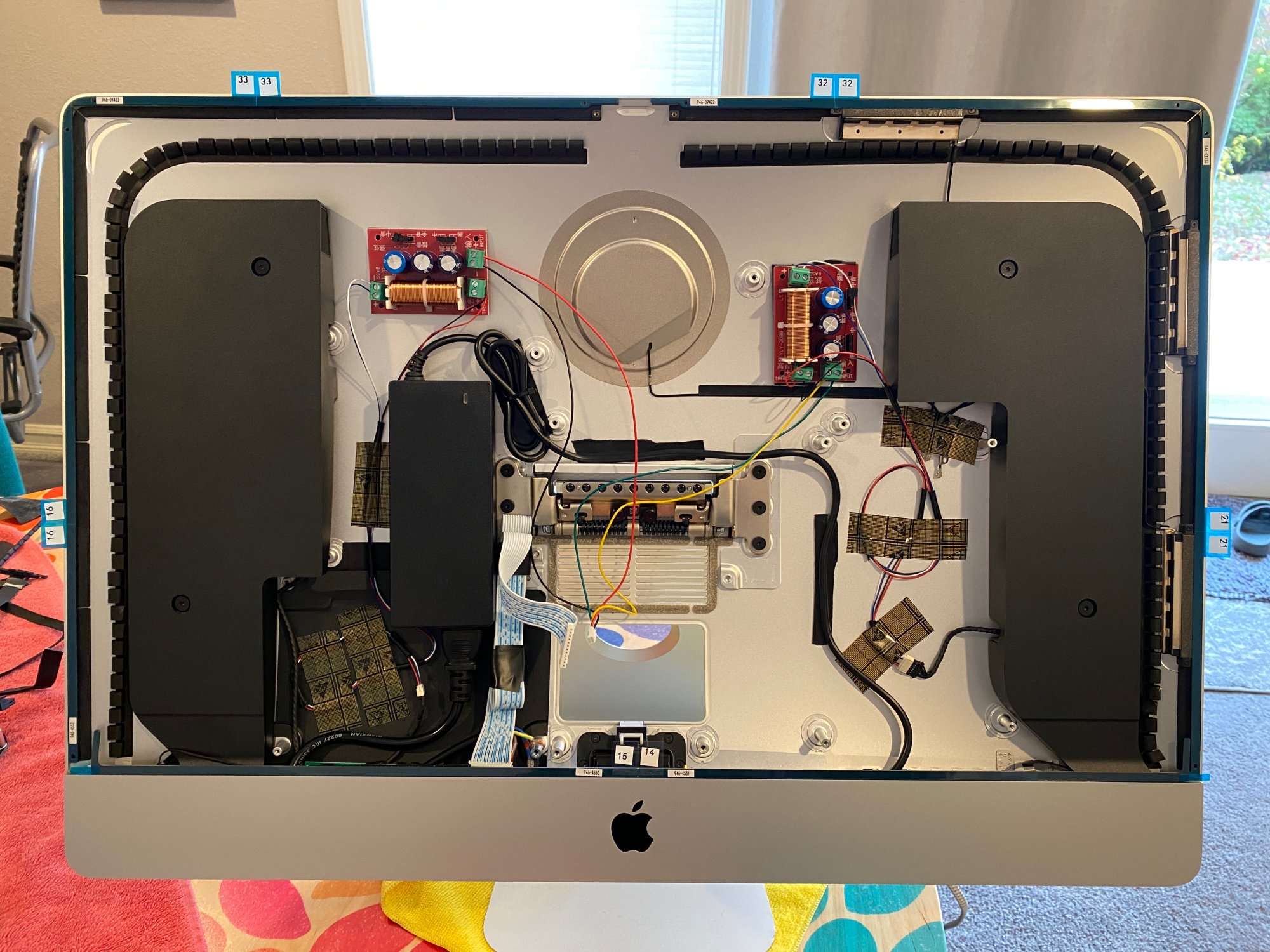

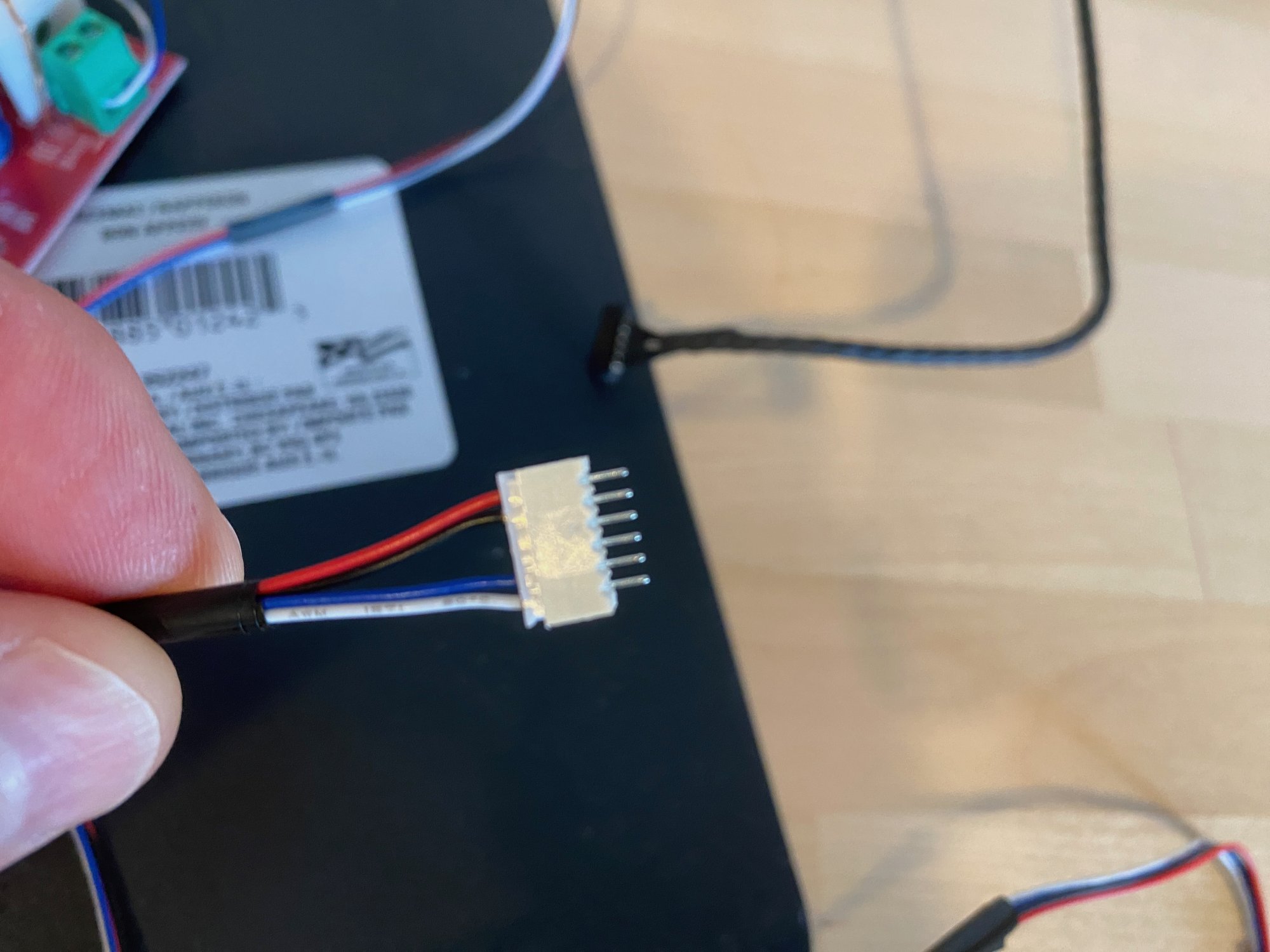

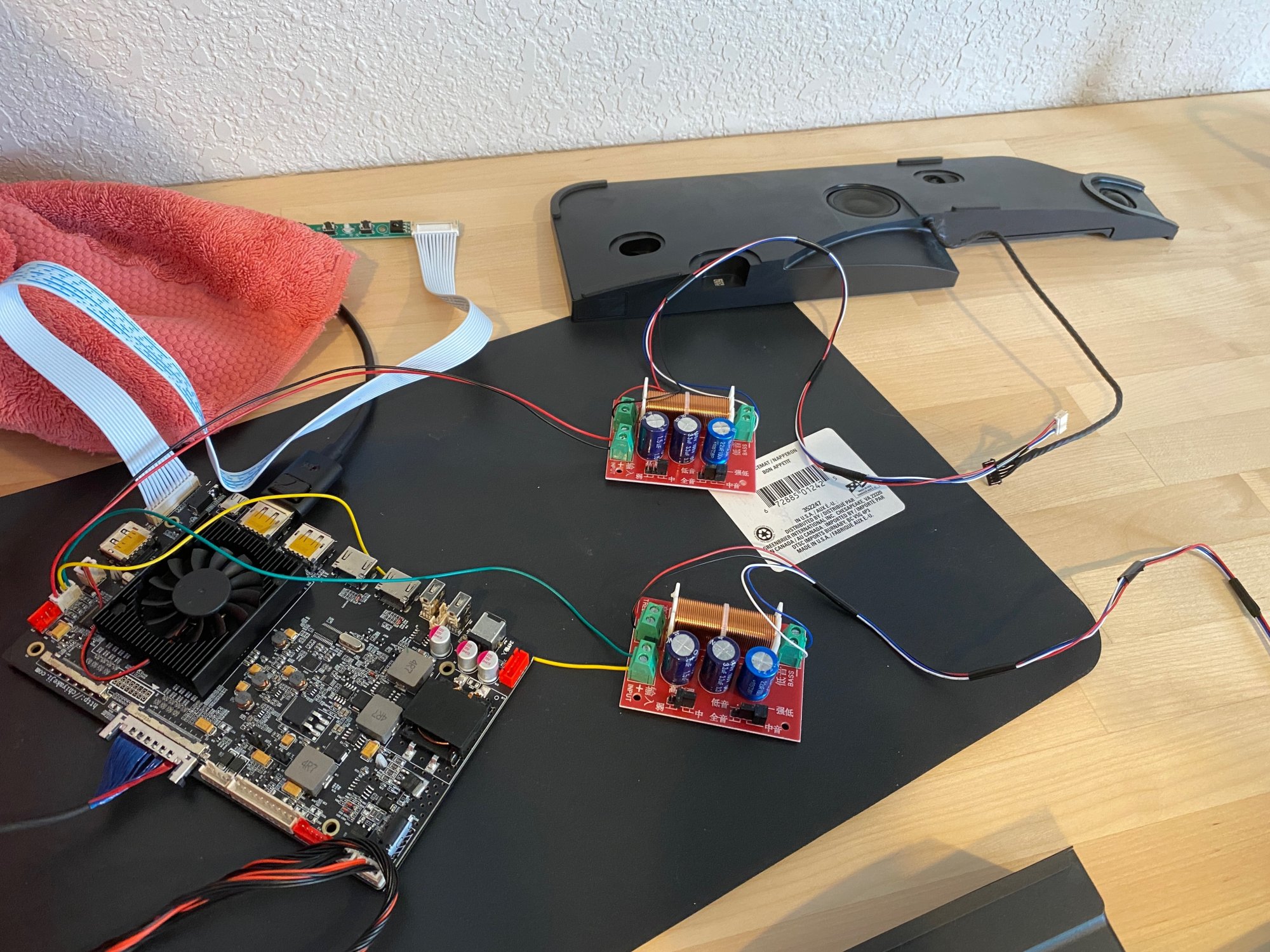

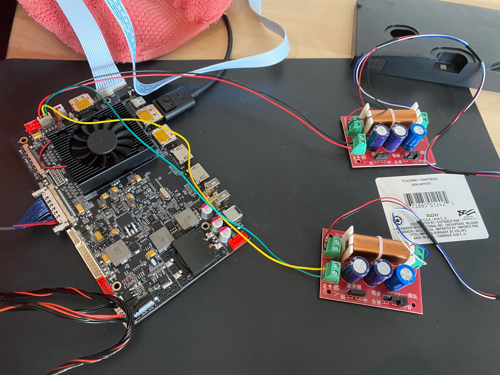

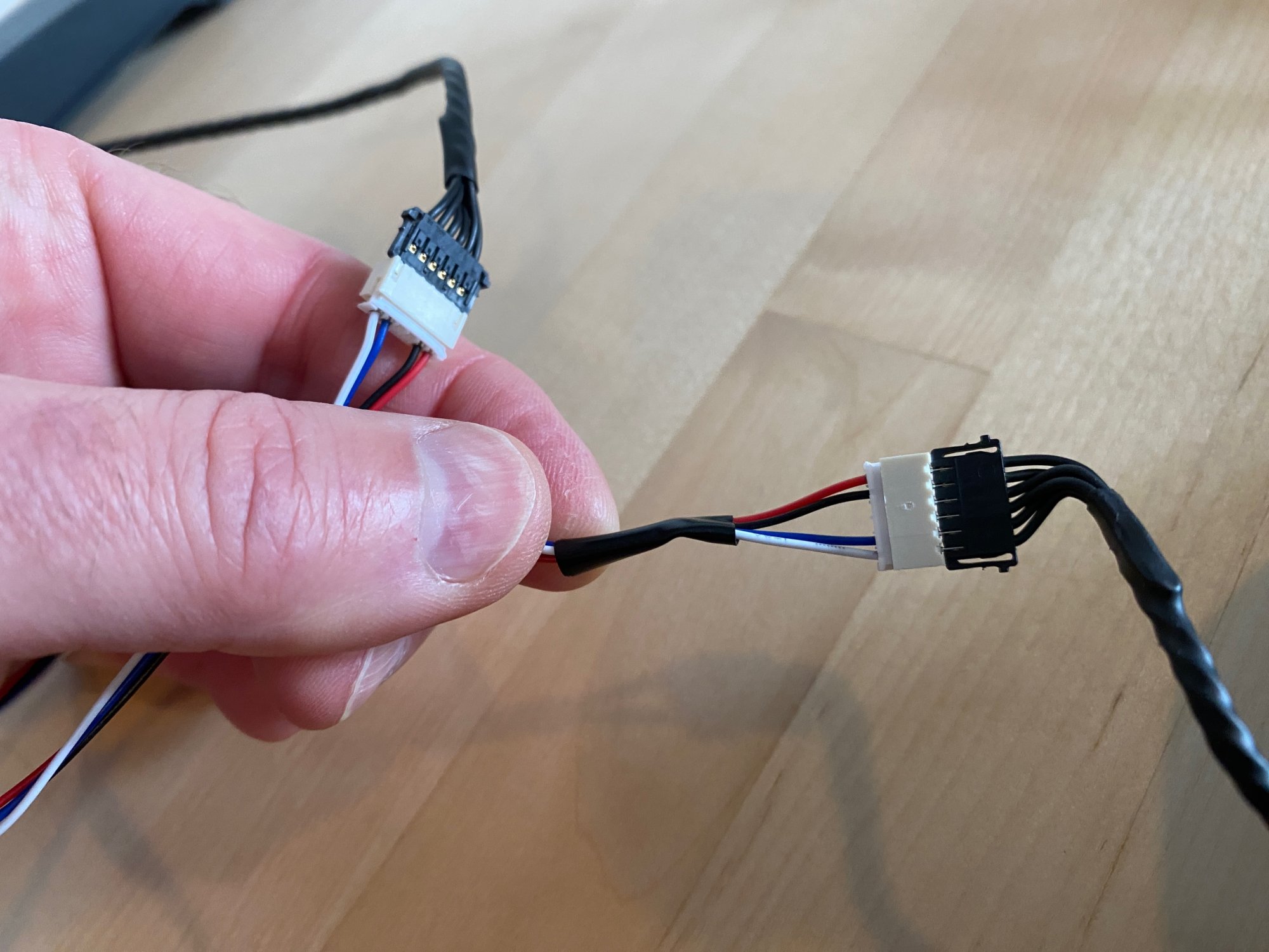

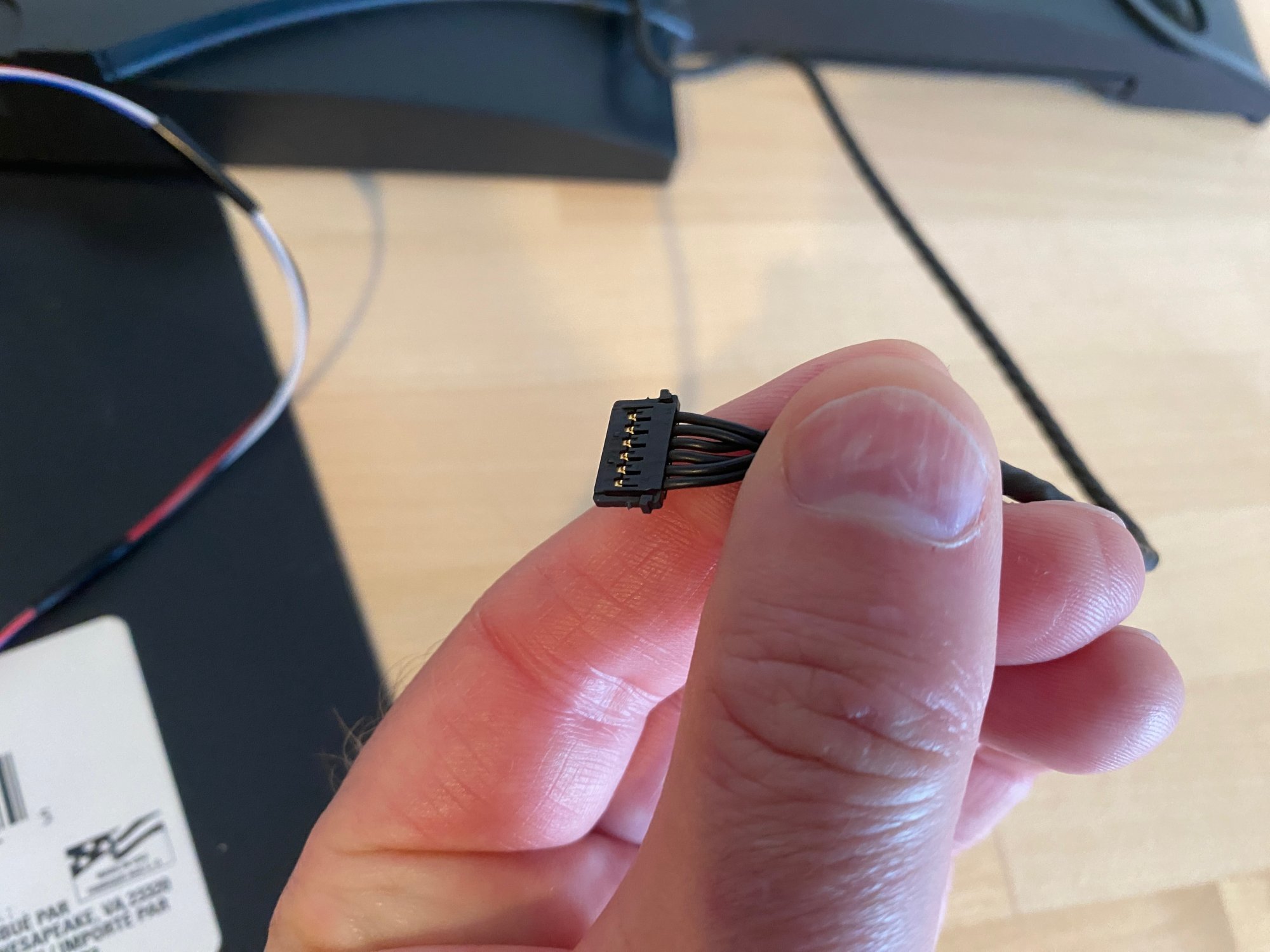

I have not heard back from StoneTaskin about the correct way to connect the crossovers to the iMac speakers yet. The wiring colors to the connectors to attach to the speaker connectors are different from others I have found online. I don't want to connect them incorrectly and damage my speakers. Can anyone tell me which way to connect them? On the eBay store for e-qstore-2020 they call the speaker connector side with the two circles "the back", and the other side the front. They have a different set of wire colors than the StoneTaskin ones. Also, is the connection the same for each speaker, and does it matter which crossover connects to which speaker? Thanks!
@VegetarianNachos You need to start again with the crossover wires. 😉
The plug into the R1811 is inserted correctly.
The four wires from this plug are:
Red - Left speaker +
Black - Left speaker –
Yellow - Right speaker –
Green - Right speaker +
So you have got these connected to the crossover input the wrong way - they need to be reversed.
The jumpers on the crossovers need an additional connection of the Left (4 pin) block - so 1&2 and 3&4 are both connected. The Right (5 pin) block just needs 2&3 connected, which you pic shows.
The outputs of the crossovers are connected correctly to the proper speakers in your pic #1:
In pic #1 the top crossover is Left, lower is Right.
The output wires from each crossover, going to the prongs of the speaker connection (pic #2) are:
Red - Bass speaker +
Black - Bass speaker –
Blue - Hi speaker +
White - Hi speaker –
In your pic #3 speaker connection, the connections from Top to Bottom (as you are showing it) are:
Hi speaker –
Hi speaker +
Bass speaker –
Bass speaker +
So you need to swap around either prongs OR speaker connection (only one) to plug them in correctly. :)
This post has the speaker connections identified correctly:
Reactions: VegetarianNachos
Hi speaker –
Hi speaker +
Bass speaker –
Bass speaker +
Oh wow. How do these changes look now?
Reactions: drlamb and PaulD-UK

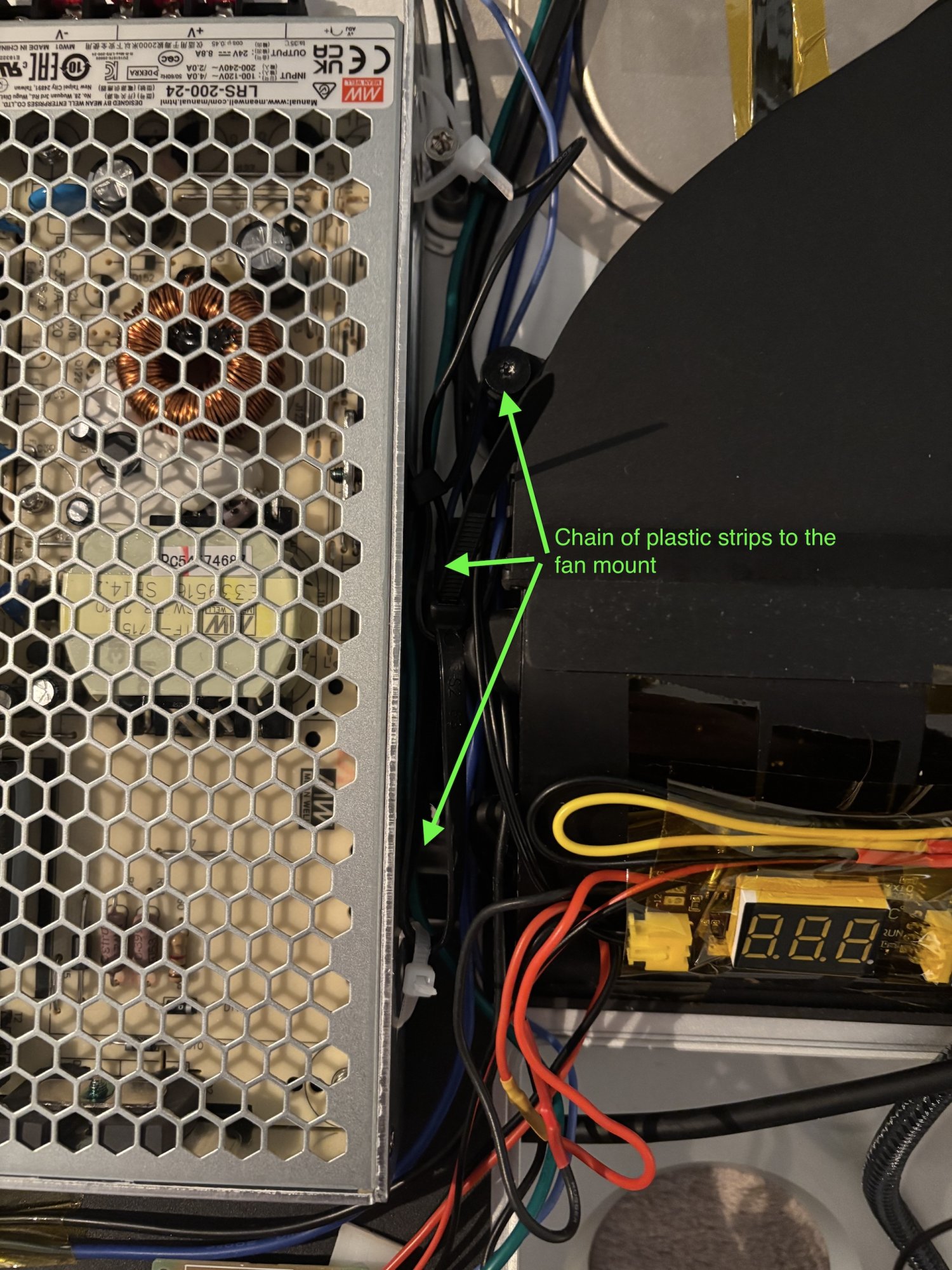

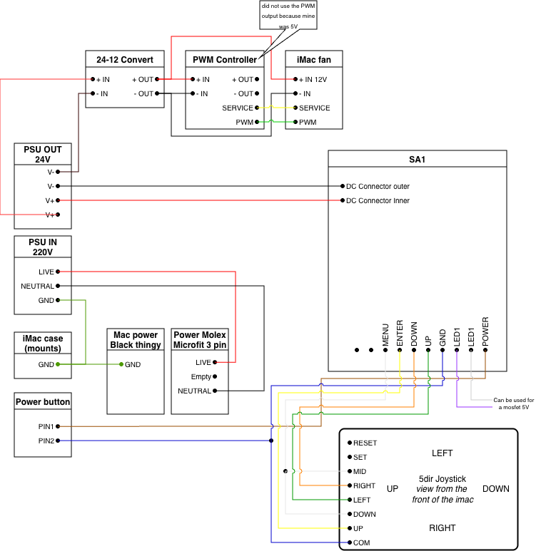

Hello everyone,
I finally “finished” my build and wanted to thank all of you on this forum for the very useful advice.
Especially PauD for all the answer and subdriver whose build inspired me.
Functional Requirements
  • USB-C to connect a MacBook + DisplayPort for a desktop computer
  • Sound
  • USB-C charging
  • Reuse the iMac fan (USB-C charging can draw up to 90W)
  • Reuse the original power cord
  • Reuse the original on/off button
  • Bonus: camera support
Skills & Tools
  • I’m not a soldering pro, so I tried to limit soldering to the simplest possible connections. I also prioritized crimping, especially for the 220V input (France).
  • I don’t own a 3D printer, so I couldn’t rely on any 3D-printed parts.
  • I have an engineering background, but it’s been a while, and I’m fairly new to electronics—so this project is doable by anyone. Just take your time and ask questions if you’re unsure.
Component Choices
Board
I chose the SA1 board because it’s:
  • Cheaper
  • Fanless
  • No need for IR control (I’d probably lose the remote quickly anyway!)
Crossovers
I chose the Dalee 2.1 because:
  • It was recommended by PaulD. as being more suitable for iMac speakers
  • It’s smaller—keeping both the fan and speakers leaves very little space
Note: These don’t have jumpers to adjust sound output, should you want to.
I’m actually quite happy with the sound. I expected something terrible after reading the comments here, but it’s pretty decent (I’ve never heard how it sounds natively on an iMac, so I can’t compare).
PSU
I went with the LRS-250-24, as I wasn’t sure the 150W version would be enough for both the screen and USB-C charging.
Keep in mind that the 150W version fits perfectly (I think) in the iMac’s HDD bay. The 250W (or 350W) model also fits, but it’s bulkier and harder to secure. I used a plastic zip tie on one of the fan screws to hold it.
Joystick
I didn’t want to keep the ugly SA1 controller at the back of the case, so I used a small 5-direction joystick accessible through the RJ45 hole. More details below.
Some info
DDC control works
  • Brightness: via BetterDisplay or MonitorControl
  • Sound level: eqMac
• Brightness is really sufficient without any extra backlit (do not remember the name of the thing)
👀 If You’re Considering This Kind of Build
Very Limited Space
  • Keeping both the speakers and fan leaves very little room. I’m not sure it’s possible to keep all four outputs of the board, but maybe.
  • Because of the board’s position, finding a DisplayPort cable with a small enough or flexible enough connector was tricky. Many have large connectors. The board could be mounted slightly lower, but not much. I ended up using this one. Try to mount the board as far to the right as possible.
Watch Component Height and LCD Thickness
  • I originally placed the PSU at the bottom of the case for better weight distribution and to prevent the commonly reported issue of the screen tilting forward. However, note that the iMac case isn’t uniformly deep — it’s deepest in the middle, which is where the PSU should go. The speaker height is a good indicator of what will or won’t fit (with some margin).
  • The same goes for the crossover beneath the PSU. If it’s too low, the inductor coil won’t fit — the LCD panel is about 0.5 cm thick.
  • I initially bought a PWM controller with the connector facing upward. Once plugged in, it was too tall. It might fit in the deepest part of the case, though.
Miscellaneous Tips
  • Be careful when removing the speaker connector sides — they’re fragile and difficult to fix if broken.
  • Having some cheap Wago connectors to test your wiring before soldering/crimping is very helpful — especially for the right speaker, where I had to extend the connector and re-match cables.
  • The camera is tricky to fit. You’ll need to grind carefully and evenly until it fits. After reassembly, the plastic was slightly loose, so I added a small washer.
  • If I were to rebuild this, I’d probably mount the PSU the other way around — with all cables at the bottom and components on top. That would make using plastic strips for securing it much easier.
Technical Details
Wiring Diagram
See attached image.
Joystick Wiring
The SA1 OSD controls are a bit odd:
  • The Menu button on the panel doesn’t enter submenus, so I mapped it to a right movement.
  • The Enter button actually goes back in the menu, so I mapped it to a left movement.
User DirectionJoystick DirectionSA1 Panel Button
LEFTUPENTER
RIGHTDOWNMENU
MID (PUSH)MIDMENU
UPRIGHTUP
DOWNLEFTDOWN

I was about to ask the board if there was any way to get decent sound out of the iMac speakers using the SA1 board.
I just finished my build, using the Dalee crossovers and I find the sound more than decent. At least to watch a Youtube video. I could make a video if you like.
Oh, and don't forget to include how to keep the power button!
It's actually quite simple.
- Find the cable from the strip that is the power button on the control panel. For the SA1 it's actually written , it's the one at the bottom when looking the panel
- Find the one for GND, same it's the fifth from the top.
- Wire one of the power button cable to Power
- The other one to GND (you have to split this cable, you still need ground for the other buttons of the control panel)
- 'order' doesn't matter

@braunico
Very well done. 👍
"Thoughts & Questions
  1. I’m wondering where and how to place the PWM controller’s thermal probe — maybe on the board’s heatsink?
  2. Not sure this screen can fully replace my 27" 2K gaming monitor in terms of heat and input lag — any thoughts?
  3. For better thermal control, would it make sense to mount the board directly on the LCD panel so the radiator faces the iMac’s aluminum shell instead of the LCD?
  4. Maybe adding thermal pads between the case and LCD would also help."
1. I put my thermal probe on the PSU, but on over two years of use, I don't think it has ever speeded up the iMac fan.
If you circulate air in/out of the case with the fan on low speed that is enough... :D
But I don't power a laptop over USB-C from the monitor.
And the heatsink of the video board will get quite warm, if not hot, so airflow over the heatsink, AND to the back of the board, is important.
2. The 5K monitor is not really a good monitor for gaming. You will have to determine if it is 'good enough' for you.
3. Lots of people have mounted their video board on the back of the LCD panel, and it has worked OK.
The LCD panel doesn't get very warm except at the bottom edge, where the backlight LEDs are.
I didn't mount my R1811 to the screen, because airflow to both sides of the video board is important, and I wanted to mount it securely to the case.
If you power your speakers at higher volumes the screen panel will vibrate significantly, especially as I fitted larger iMac Pro speakers as well as the original speakers (chopped down to fit).
That was another reason for mounting the R1811 securely to the case.
4. Not neccessary, as the heat build up isn't significant.
Reactions: braunico

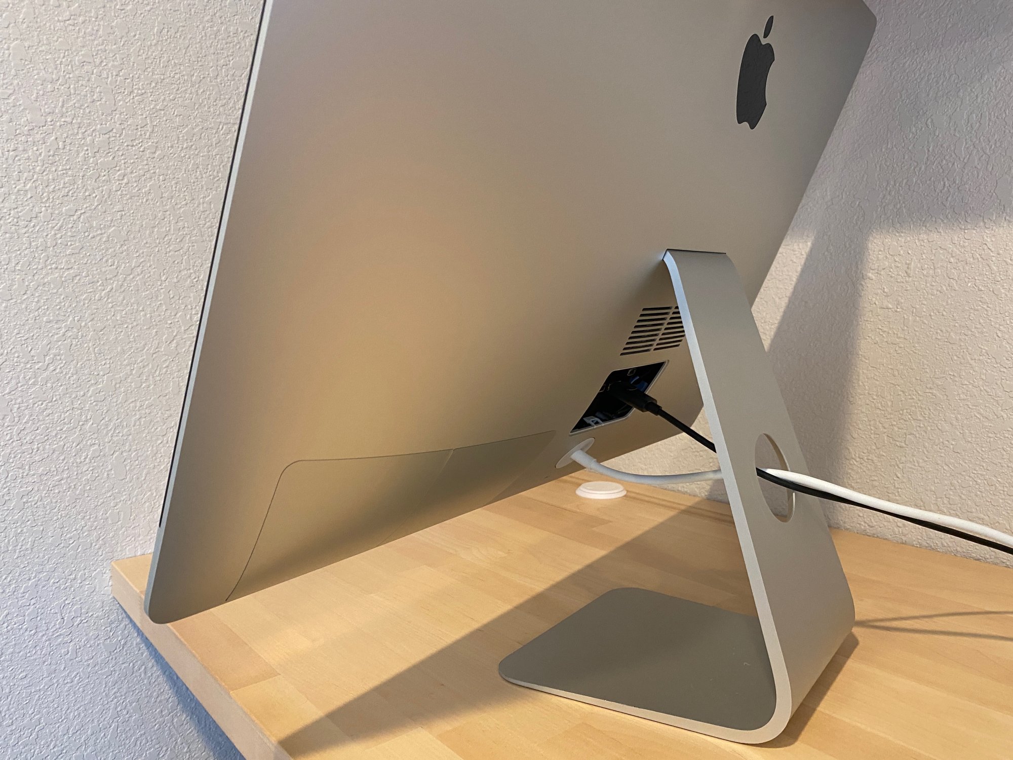

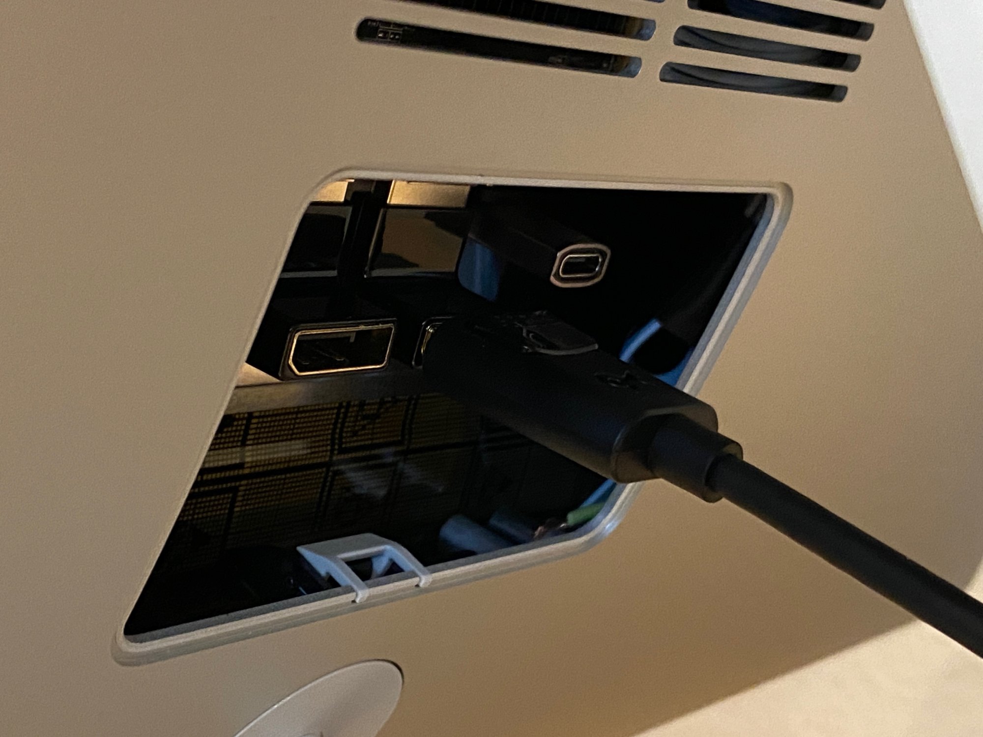

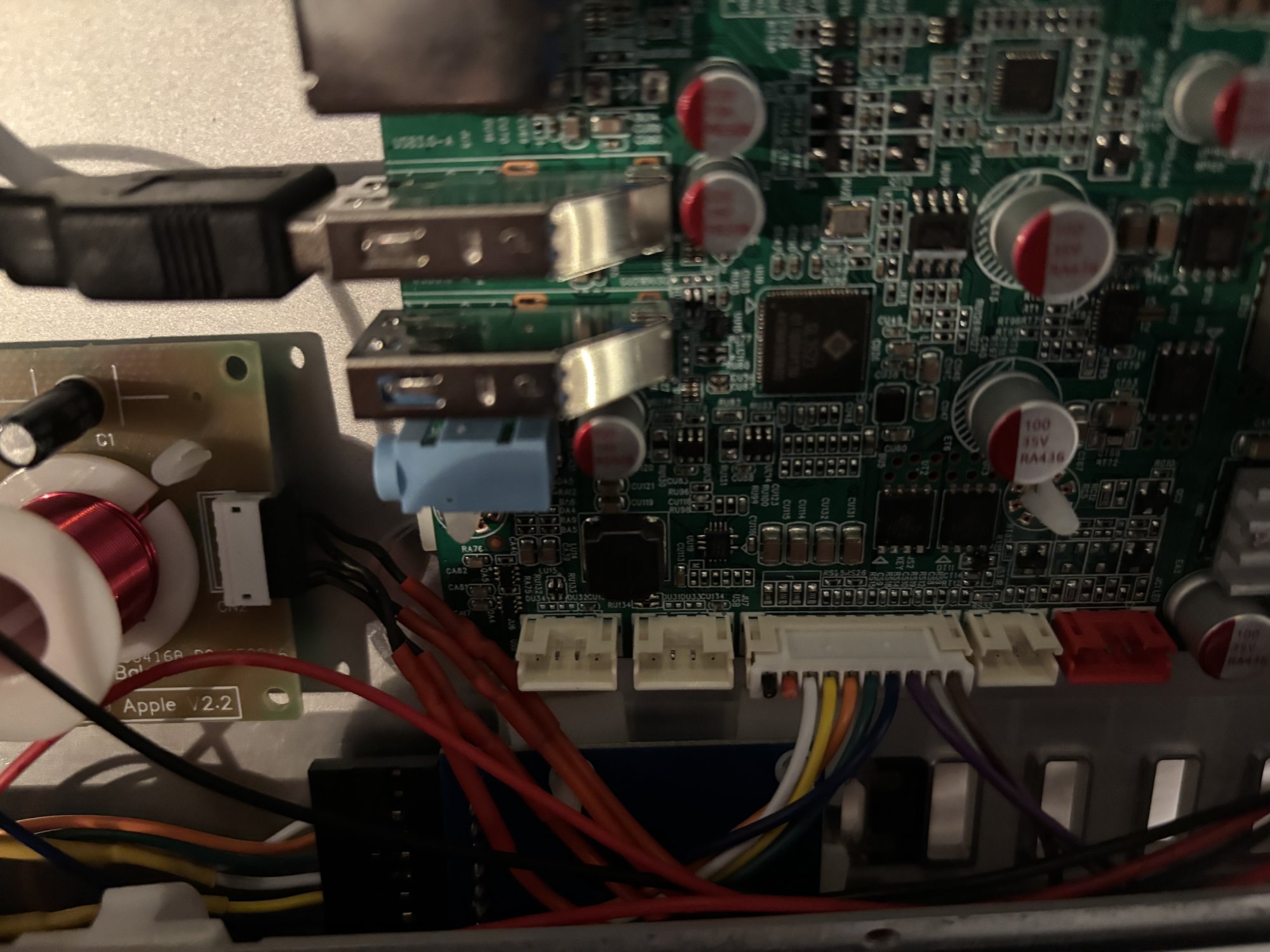

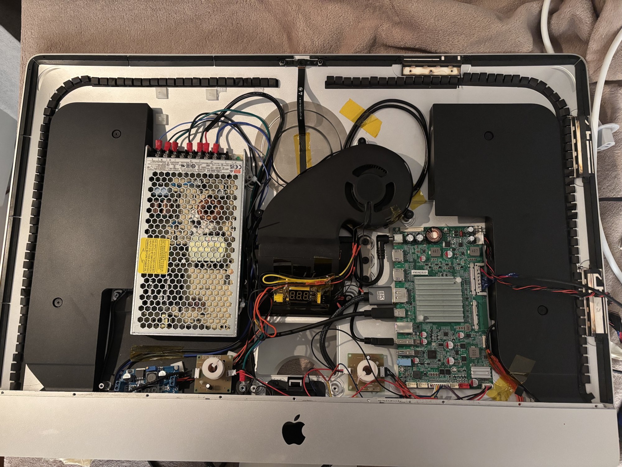

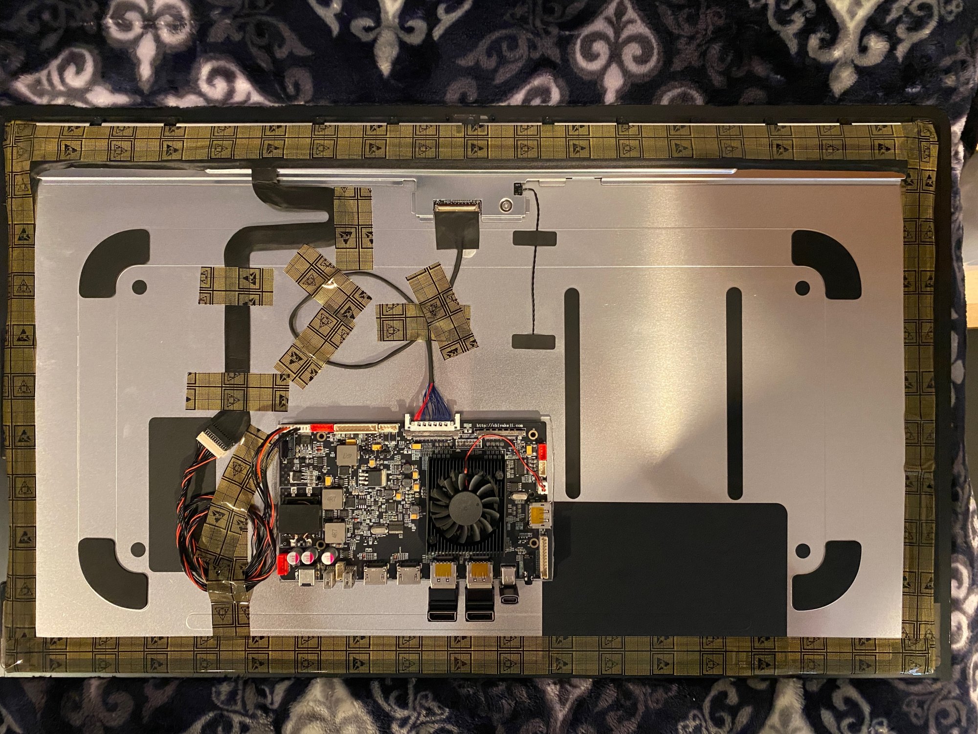

I finished my DIY 5k Monitor build. Thanks to all who have contributed to this great thread!
I used the following hardware:
  • A fully functioning 2019 5k iMac with an LM270QQ1 (SD) (E1) panel
  • An R1811 v4 driver board from StoneTaskin which came with:
    • an LCD cable
    • a backlight cable
    • an OSD keypad
    • a 24V, 5A power supply
    • and a remote
  • A set of crossover boards to utilize the iMac speakers purchased from StoneTaskin
  • A Cable Matters unidirectional usb-c to DP 1.4 cable capable of 8k resolution (1m long)
  • A Cable Matters USB4 8k video and 240W charging cable (1m long)
  • (2) Cable Matters DP 90 degree adapters
  • A Cable Matters usb-c 90 degree adapter
  • Uppercase brand silver palm rest skin to cover iMac ports
  • Apple OEM iMac Pro adhesive strips
Notes:
  1. This build is to be used primarily with a Mac mini (currently using with the M4 version).
  2. Ordered the HDMI 2.0 board since I decided that I didn’t need the HDMI 2.1 version.
  3. Used ESD tape, Scotch Extreme double sided tape, and Scotch Extreme velcro for most of the build. The Scotch branded tape and velcro are made by 3M and have slightly lower high temperature limits than the 3M branded products. I used them because I could find them locally.
  4. Mounted the R1811 v4 on the LCD assembly so that its fan can blow out the exhaust grill. The fan on my R1811 v4 is almost completely silent. Cut a ~3mm thick piece of acrylic which I mounted using double sided tape. Mounted the R1811 v4 to the acrylic using velcro. This configuration allows the acrylic to act as a heat shield between the board and the LCD, and provide airflow between the acrylic and the board.
  5. Mounting the R1811 v4 in this position also allows for 90 degree elbows to point out the ram door. This is pretty convenient for connecting short cables (which is recommended).
  6. Used anti-static tape around the outside of the LCD assembly to help prevent dust ingress which can affect these displays. There is currently no dust in the LCD, and I want to keep it that way.
  7. Connected the iMac power button to the OSD keypad and mounted the keypad internally down by where the chinstrap would go. If I need to use the OSD, I can reach the remote around the back of the computer and it works fine.
  8. Cut the power supply cord and wired it up internally to the iMac AC input, so that I can make use of the original iMac power cord. It is convenient to be able to remove the original iMac power cord if I need to move the display.
  9. Used the 5A power supply for convenience and the fact that I do not currently use a MacBook that could make use of the usb-c charging functionality. If I start using it with a MacBook, the MacBook will just charge more slowly. If that becomes a problem, I will open the display back up to install an 8A supply.
  10. Decided not to use an internal webcam as this setup works great with my iPhone and continuity camera.
  11. Covered the camera hole with black electrical tape on the inside of the assembly in order to prevent light from coming out through the front of the display.

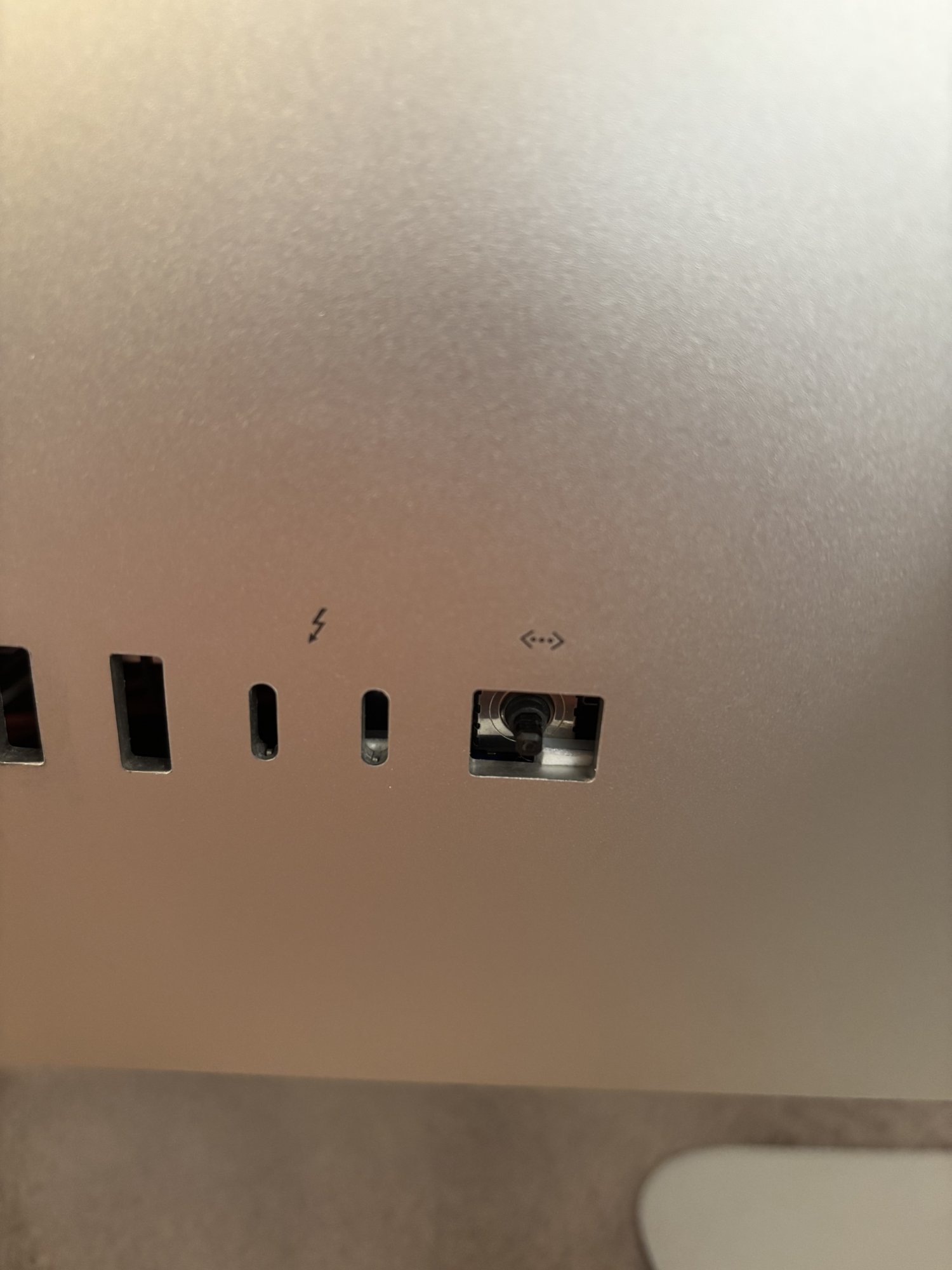

  12. Covered the iMac ports with an Uppercase brand silver palm rest skin.
  13. Used Apple OEM adhesive strips from an eBay vendor I have used many times in the past. They were out of the 2019 strips, so I used the iMac Pro strips. The side strips are exactly the same parts. The top strips are identical as far as I can tell. The bottom strips are different, but only due to the fact that they cover the microphone holes on the 2019 which I don’t care about since I am not using the microphone.
  14. The speakers work fine. When compared to another 2019 5k iMac I have sitting 6 feet away, they sound much worse. The iMac logic board does a better job of driving the speakers and getting good sound out of them.
  15. Getting 5k/60/10 output using each DP and the usb-c port (no issues).
  16. Kind of disappointed that I did not get the newer firmware that the HDMI 2.1 board gets, even though I ordered the newer R1811 v4 HDMI 2.0 board directly from StoneTaskin.
  17. This display is now rock solid.
  18. Thanks again to everyone on this thread for contributing to the community knowledge regarding DIY 5k monitor builds, especially to PaulD-UK whose posts are particularly helpful!
