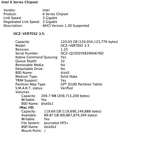

How did he check the system profiler? Did he look at negotiated speed or actual possible speed?

Peter D. asked the following question at 1:22 PM on May 3, 2011: "Will these new iMacs support your new 6G SSD?"
OWC Michael responded at 2:33 PM: "In checking system profiler, we found that the SATA bus is 3.0Gb/s. So while they would certainly be compatible, they would be limited to 3Gb/s speeds."
These are the two 2011 models they used to gather the fact that there is only SATA 3.0Gb/s speeds:

I'd also like to see a screenshot of System Profiler of the 2011 iMac, which will put to rest whether it is SATA II or III.

well the owc blog. it just came up with the bad answer to me and one other. a sata iii ( 6gb) owc ssd reads at stata ii (3gb) speeds. sooo that means hello t-bolt for fast speed. kevin you read it correctly!
if this is true and you don't want t-bolt the 2011 imac is crippled.

This clarification looks fairly conclusive. All I can say is WHY!!
It seems that if this is indeed as it looks then Apple have come up with such a great machine only to have it constrained by not being able to slot in a SATA III SSD.
But then again if the Apple SSD only supports speeds handled by SATA II and they don't like people opening up the iMac (unlike the MP) then it make some sort of perverse sense.
My question has been answered in the OWC blog.. SATA II. Really? Wtf?

Apple's SSDs that have been supplied in the 2010 iMac and 2011 MBP are SATA II, but the 2011 MBP has SATA III ports.

Thats really strange given the fact that the MBPs are reportedly undergoing a silent hardware revision in which both the HDD and OD ports are now SATA III. (It used to be HDD=SATA III & OD=SATA II at launch)
Why would they seriously nerf the iMac like that.
