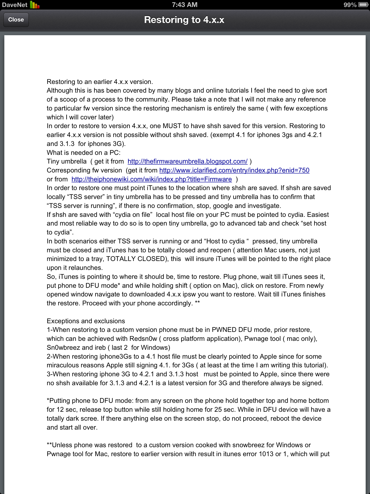

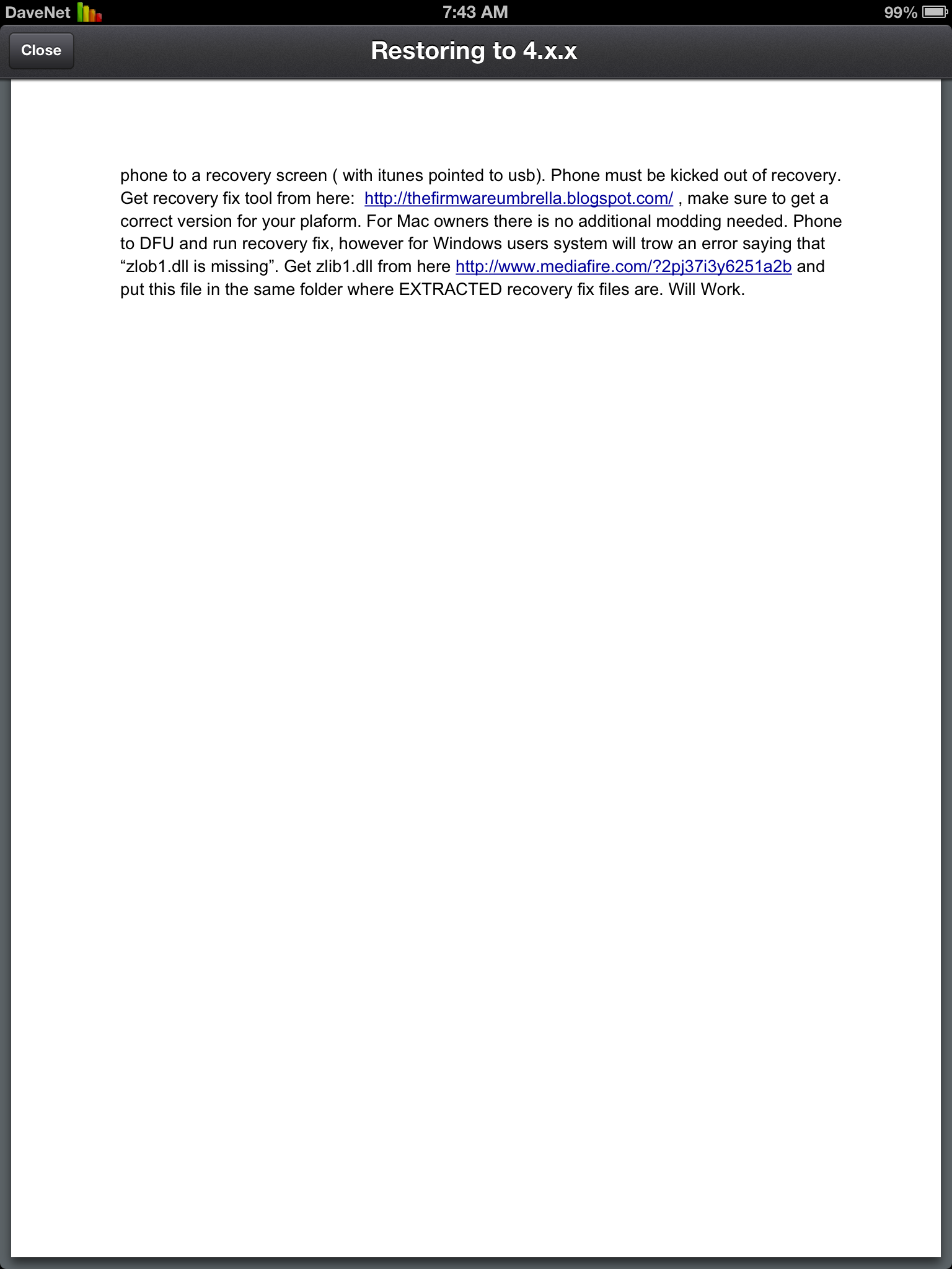

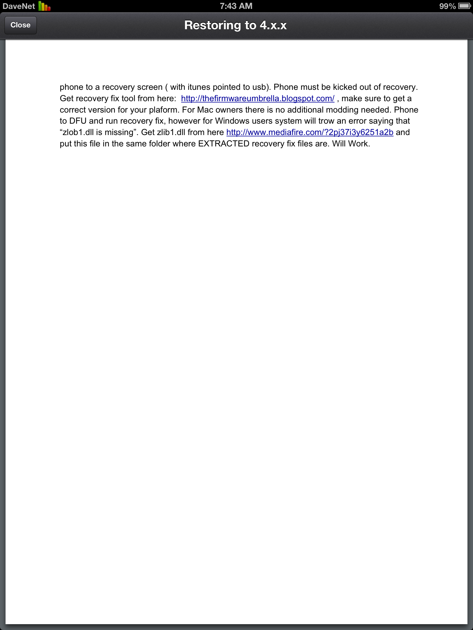

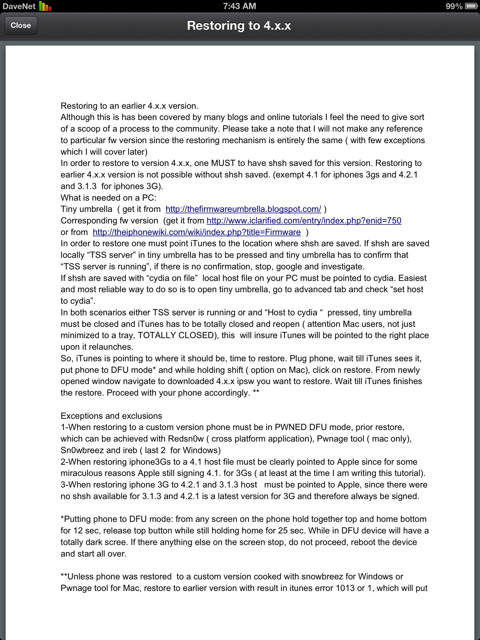

A friend of mine "Slavikulikoff" wrote this some time ago, AFAIK it still should work
OK, if so, then I am mistaken but I could swear 14b will do it successfully.
I am using RS 9.14b1.
Hi DH, actually he is right on this, tried it myself, redsn0w pops alert only 4.3.3 to 5+ for custom IPSW, the 9.6rc8 does not have the option and 9.9b8 also pops up the same alert.
He can use Pwnage tool to make the 4.1 custom IPSW (the old days…) but first lets see what happens on the just boot and the hard reset.
Tried hard reset and just boot option too, just now. hard reset no change. In just boot option pwnapple logo shows for a while and again end up in dfu.
