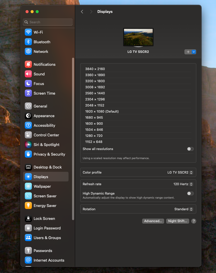

You're a life saver. I was ready to give up after weeks of hair pulling and reading this thread and still not able to make heads or tails with the kludge solutions. Finally, tried that guy's fw and it's working. I went from the 428 GRY to the 388A but 4k@120hz is glorious on 48" C2
Thanks again!
