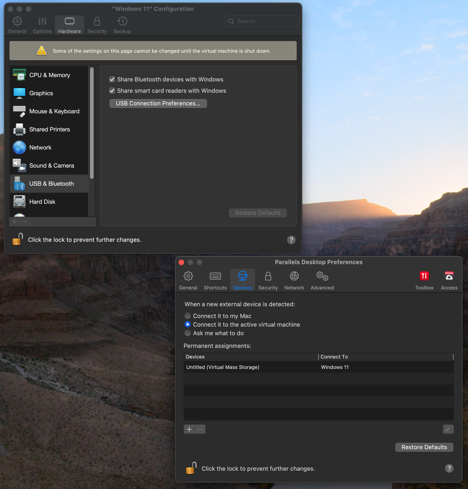

@davidawolf I noticed you have the CableMatters instead of the Anker like most here. I recently acquired the 201428-GRY from CableMatters to pair up with my LG C2 48". I read you had success 'assocating' the USB to Parallels but I'm having a pickle of a time figuring out where in the settings this is. I'm at my wits end with the Spyder chip is not connected error.
Here is where I'm stuck.
The only USB connected devices I have are my TerraMaster DAS and in fact, the dongle I have connected powering the HDMI cable going to the LG doesn't even appear in the list.
Appreciate any insight you may have.

So every effort to use Parallel has failed with this device? I'm bummed as my only Windows machine proper, has a USB-C port that doesn't do video. I've tried several times to see if I could get my PC to recognize it but it won't. Even got the Spyder chip nonsense pop up on a standalone Windows machine.

Can you elaborate on what 'it does not work' mean? CM sent me the custom firmware and instructions but my antiquated PC from a handful of years ago doesn't seem to have alt mode available as when I plug in the HDMI cable into the dongle, no images are coming through. It's probably just outdated standard. Computer is from 2017 Alienware R6?
At any rate, I do get the dreaded message of Spyder Chip not detected which you diagnosed to another user as not passing through to Windows. I've tried my darnedest to figure out Parallels but still no luck. Hoping more exposure and one of the guys who found success can help me out.
Got it to work! Already confirmed devices but just wanted to add to the confirmations.
Macbook Pro 14" M2 Pro
Anker VMM7100 USB C-> HDMI Flashed using Parallels
Dell WD19TB
LG C2
Works great!

I successfully flashed the Anker 518 USB-C to HDMI 2.1 adapter and it works at 4K@120Hz PCM with my LG 42LX1Q6LA (same panel as the LG C2) and a M1 MacBook Air 👍🏼
I used Parallels and needed to download the VMMHIDtool from the Microsoft Store to flash it. I had it connected to a standard USB-C (10Gbps) on my Mac Studio while flashing it with no display connected.
