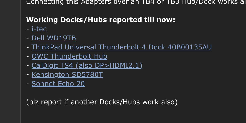

Can you recommend the dock u are using right now?
Read the OP there are some Dock where are confirmed:
I use this one:

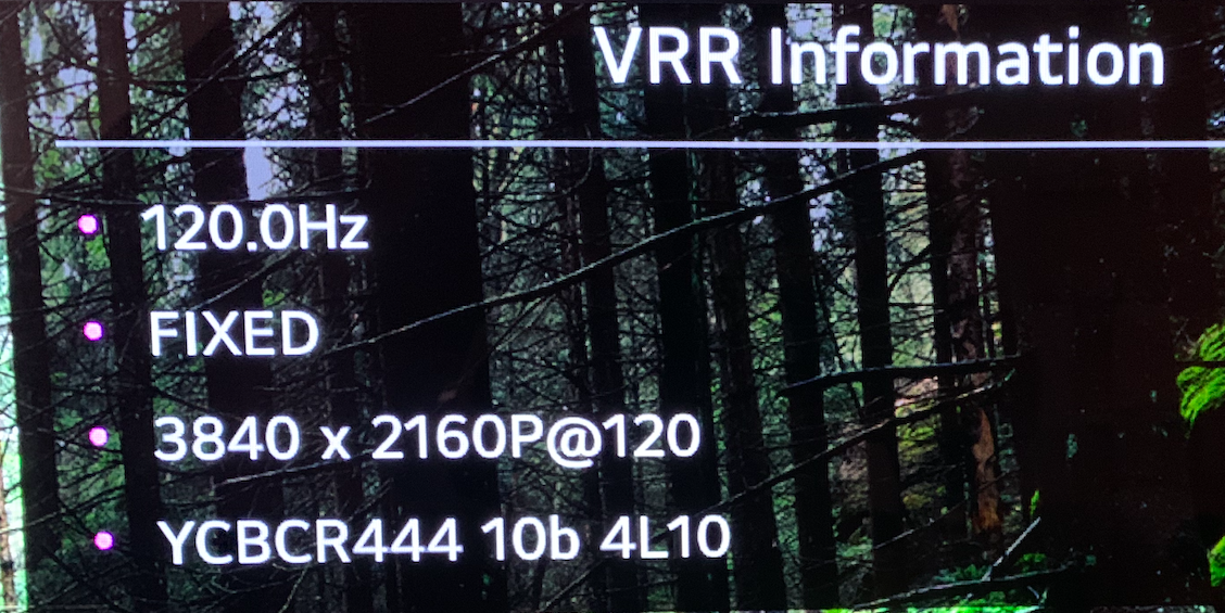

yay, got it working, too! Macbook Air M2 2022 via USB-C-HDMI-Adapter@LG C1. This is so awesome! Thanks to AironMan and all the people who made this possible :)

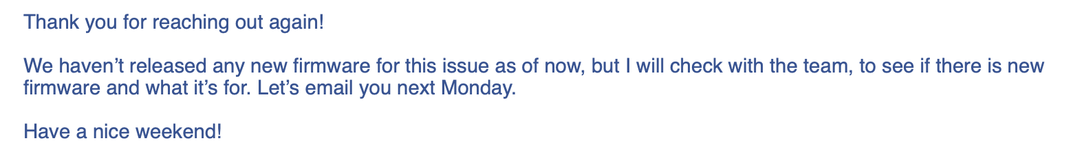

I contact CM if there is a new Firmware, but i dont think so.
