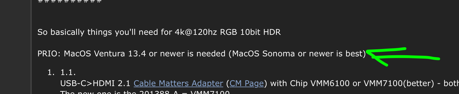

Using the latest macOS was described in the OP:

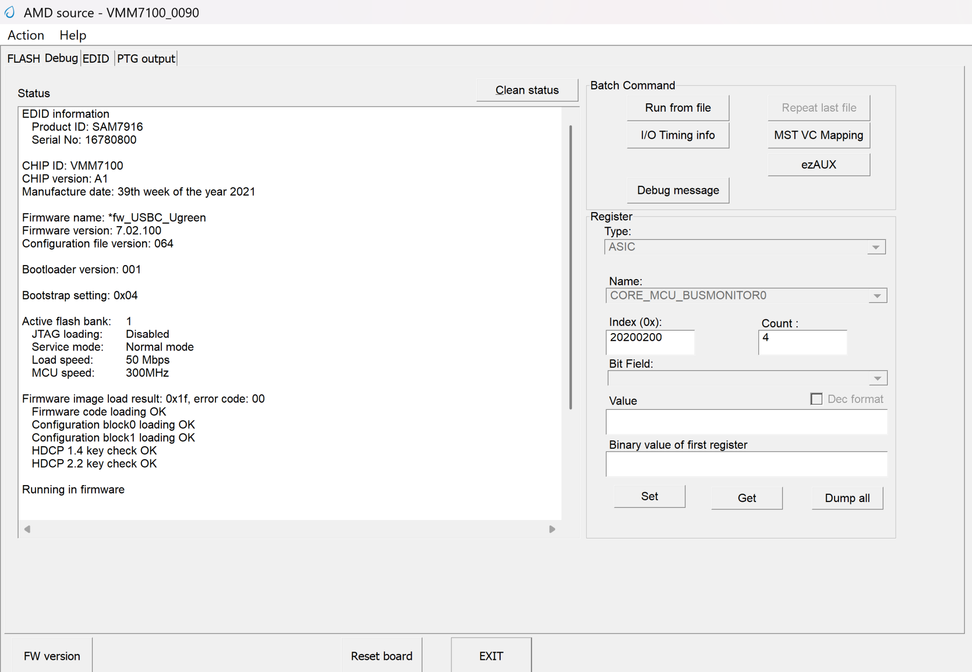

Hello i have this oneugreen adapter, , i checked the fm version and its having the compatible chip, is there some firmware that can be compatible with this ugreen cable?

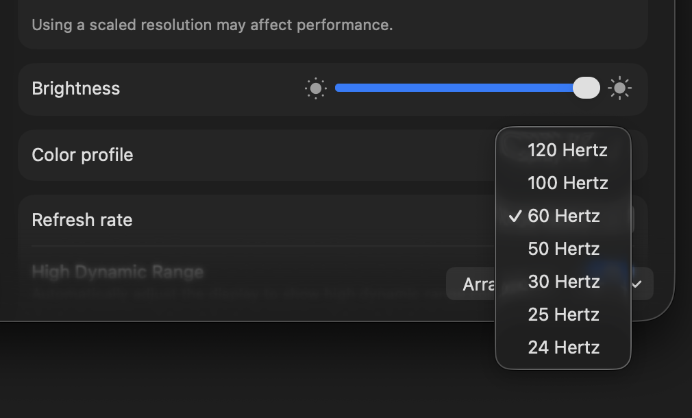

How come the colours are all blue tinged when I put it in HDR mode (at 60hz as the option disappears at 120hz)

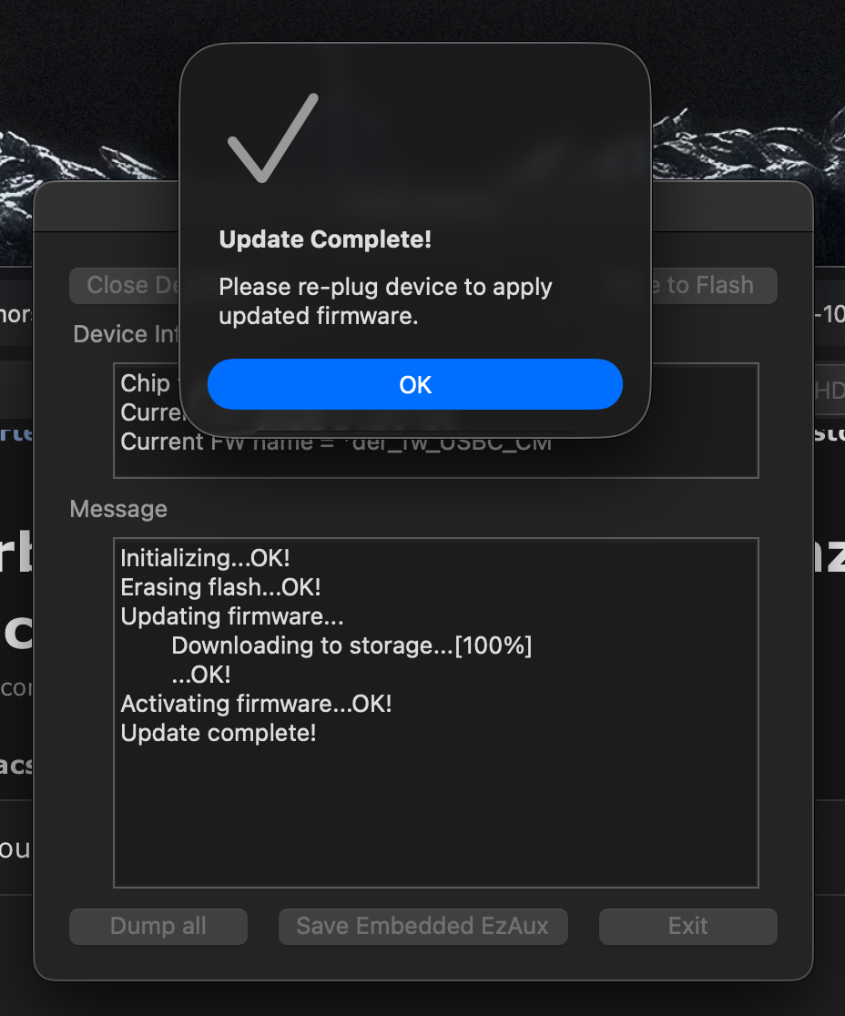

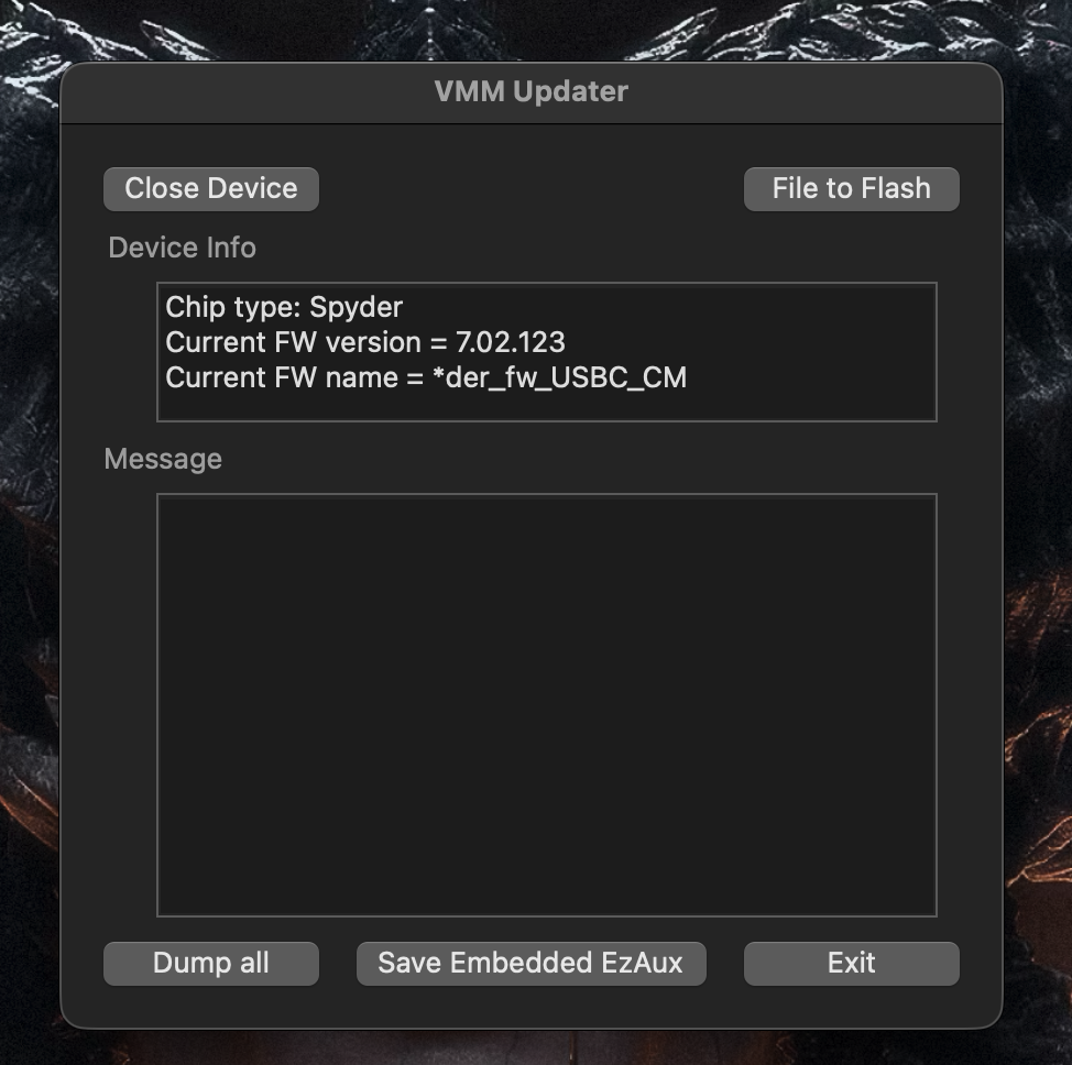

Got the updater working on macOS. Kind of funny but looks like CM didn't actually set the privileges on the executables in VMMUpdate and VMMUpdate_Cascade.
Setting their permissions to 744 and sure enough, the app works just fine on Macs. So no longer need Windows moving forward. Just a heads up for the thread.
Screenshot 2025-09-21 at 3.11.07 PM.pngScreenshot 2025-09-21 at 3.17.26 PM.png
And works perfectly. Totally plug and play after unplugging and replugging the cable.
