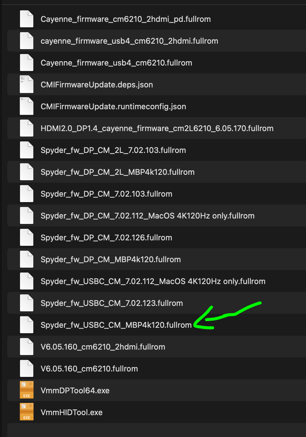

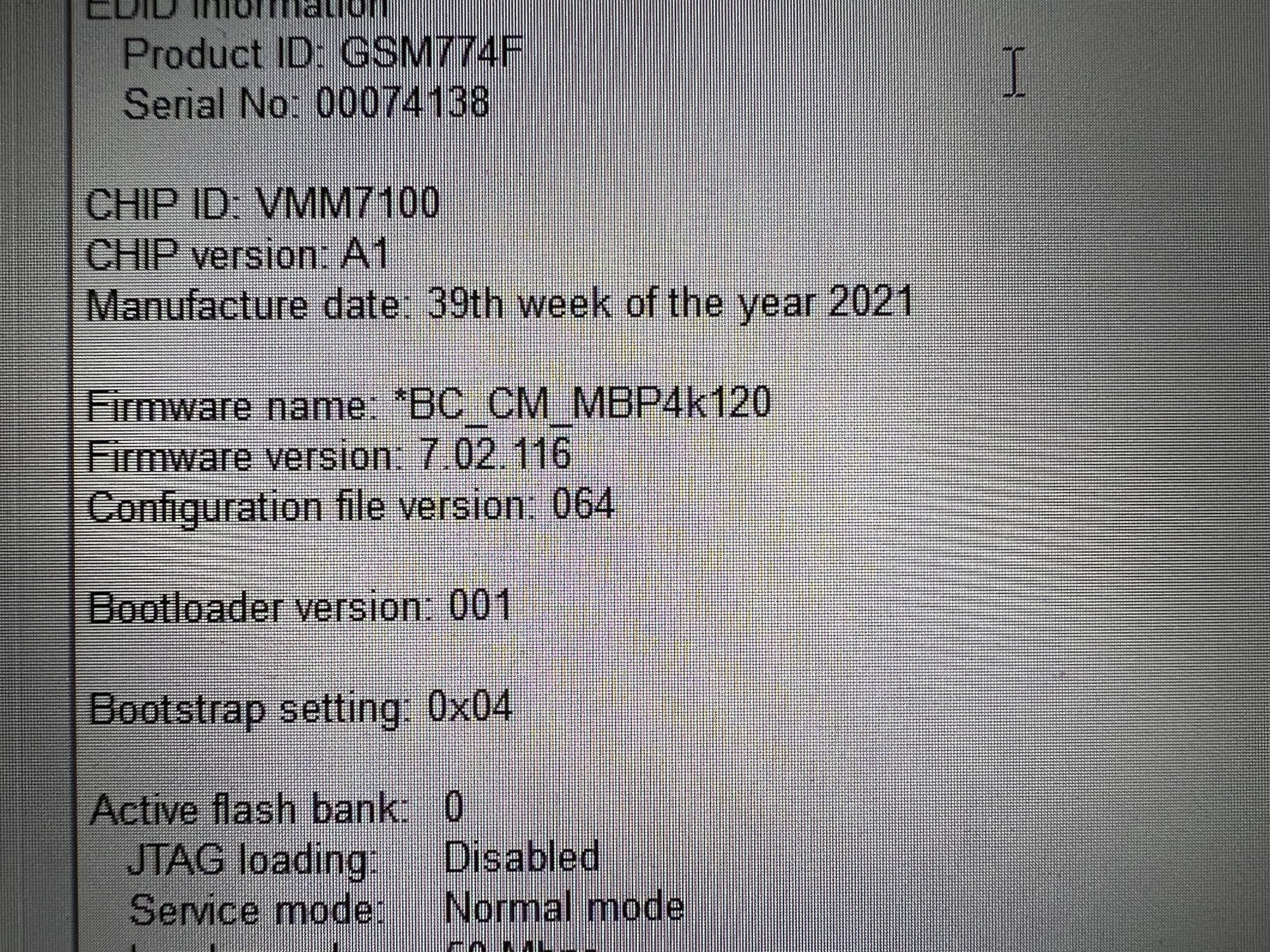

I have an LG C2, MBP 2 Pro (Sequoia Beta 15.5), and CableMatters 201388-A USB-C -> HDMI cable. Using the CableMatters update tool I end up with:
- Firmware *BC_CM_MBP4k120
- Version 7.02.116
- Config file 0x040
Directly flashing from Spyder_fw_USBC_CM_MBP4k120.fullrom via VMMHIDTool, I get the same result: 4k120 *without* HDR or HiDPI. I had HDR working before 14.0, which I think reflects the comments upthread about some HDR change by Apple.

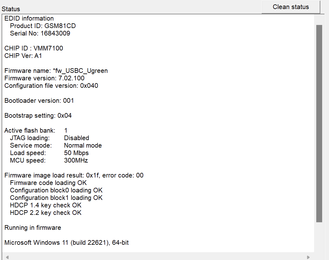

Can confirm because I messed up with the ugreen adapter. The type C to hdmi 2.1 adapter does implement A1 and the VMM7100 chip, but there seems to be a specific ugreen fw compatibility issue which has now rendered my adapter useless after flashing it without backing it up (I know....). Now it keeps going into some fallback mode upon connection and refuses to show anything on display. Does someone maybe have the original ugreen fw for this adapter to atleast get its functionality back? (Resetting VMM7100 with betterdisplay also didn't work)

I used the newest firmware from CM released in March 2025 LINK , and it works well so far. Has anyone else had any experience with it? Mac models M4 must use the newer firmware version. Iam on M1 MAX with an CM USB-C>HDMI Adapter VMM7100, i will report if issues like standby problems are resolved (Update: for me the standby issue is solved with this new firmware)
The release notes are:
- The new firmware resolves the issue of DPtool not working under macOS.
- After restarting the computer, the resolution for 4K120Hz RGB will be downgraded to 4K120Hz 420.
Info: Don't forget to set your HDMI input on your TV or monitor back to PC mode!
The new Firmware:
The new Firmwareversion is 7.02.116
I've tried to do the same but I'm ALWAYS backing up ROM first!
Ugreen 8k usb-c to HDMI ROM
after trying to flash CableMAtters ROM and having nothing on screen, I've successfully recovered the cable

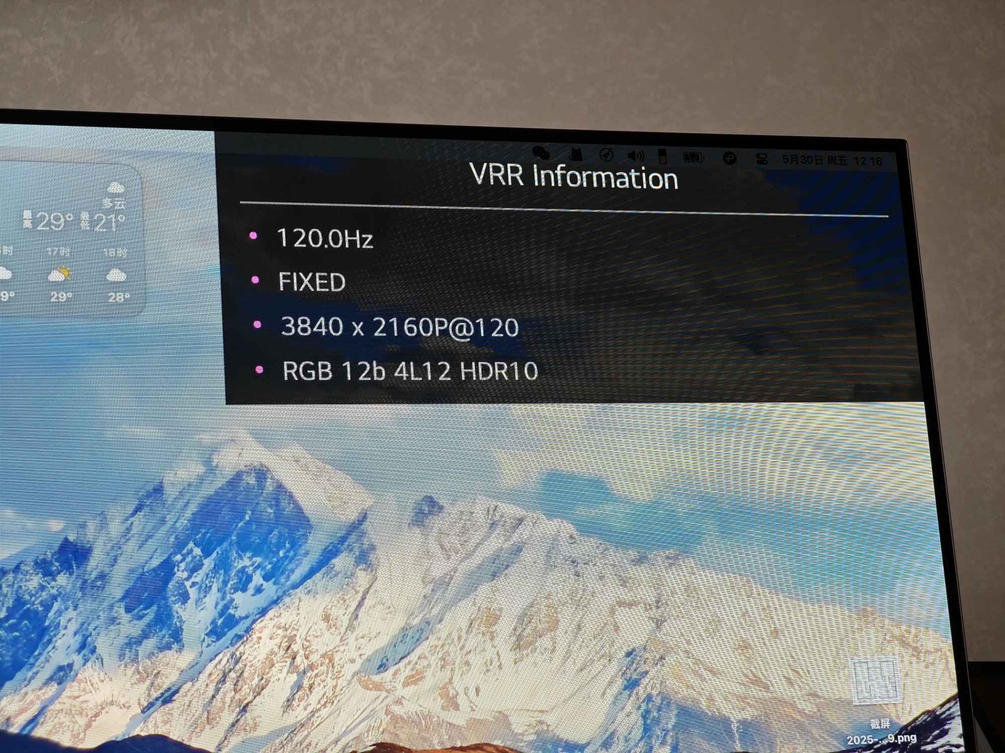

I'm using a MacBook M1 Pro with an LG C2 42" and a MOSHOU VMM7100 cable. After I updated my Mac from 14.0 to 15.5 (for using Final Cut Pro), I found I can now get 4K 120Hz HDR 12-bit 4:4:4. I'm not using Better Display, and everything looks great – even better than before.
When I was on 14.0, I could only get 10-bit HDR. Also, I can now control the TV's brightness directly from the Mac, which was disabled before. I'm not sure why this happened. I haven't updated my adapter's firmware since I bought it in Feb 2024.
