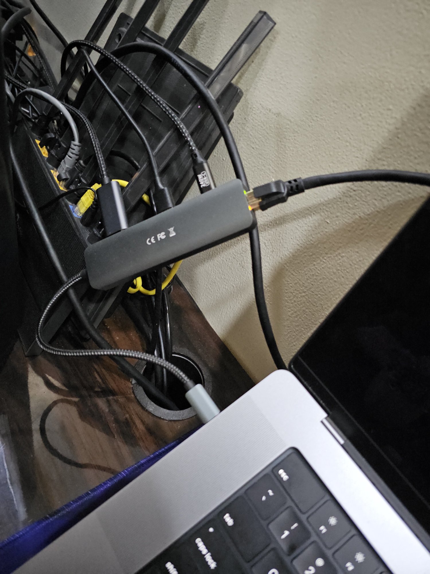

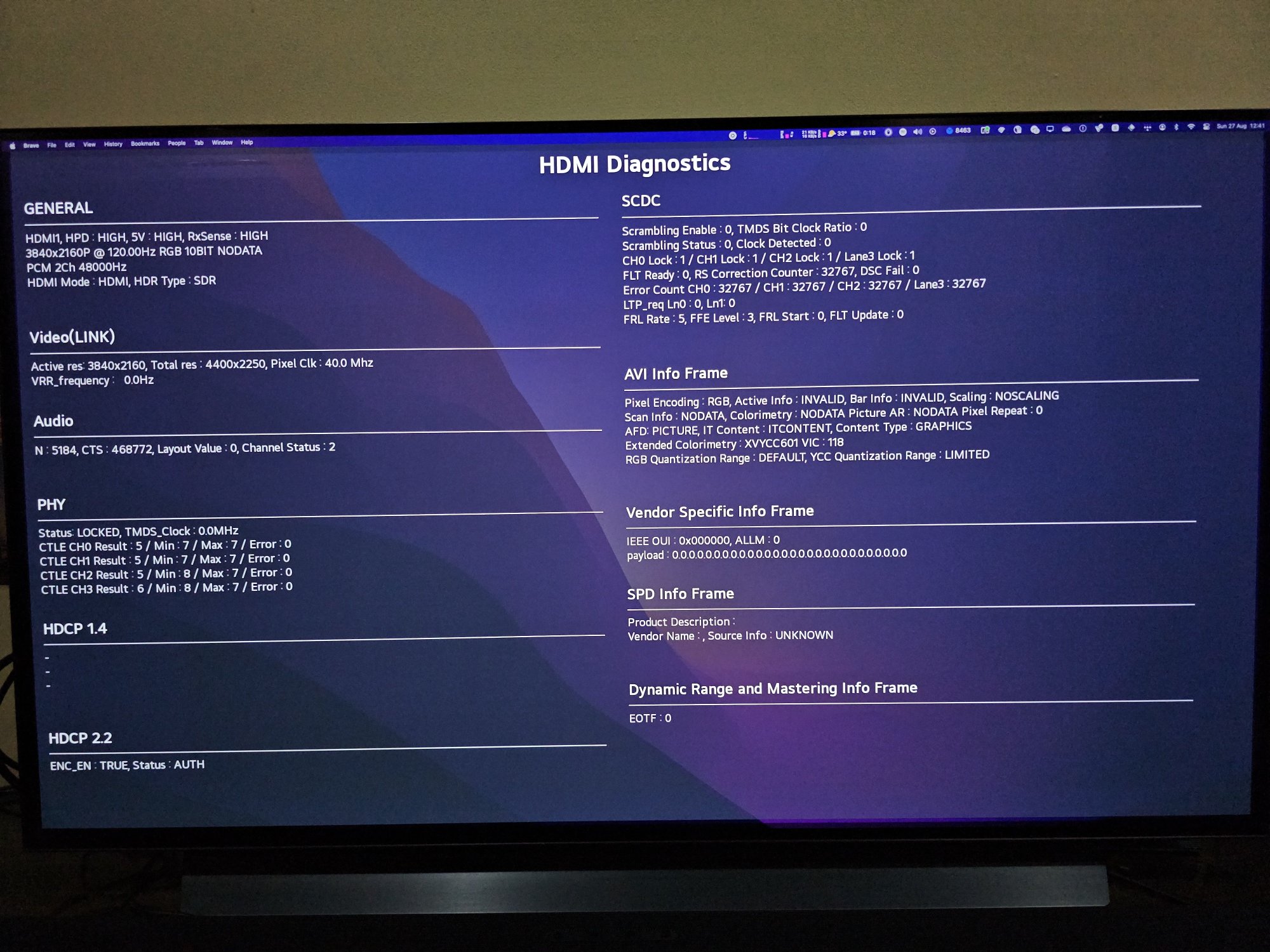

I think this is the first Dock/Hub with LAN and native USB-A Adapters where can be flashed do work with 4k@120hz 4:4:4. This is an VMM7100 or VMM6100 ?
I got the Cablecreation USB-C hub working but it keeps annoying when I close the lid and suddenly no signal on my 42C2 LG oled tv
Is there any way to fix this?? Or should I get device with VMM7100
It happens on both USB-C hub and cable matters USB-C to HDMI adapter
Also, I need to unplug multiple times to even 4k 120hz work on my tv with MacBook Pro lid open
I use config protection and EDID auto upload on my better display 2.0.8 version with pro license+MacOS Sonoma latest beta available
I have a similar problem as well where I don't get the signal output when I turn off the TV (after the macbook is locked) and come back sometime later and turn on the TV. It does not matter if the mac is sleeping or not. When i press some keys to get the lock screen, I simply get no output on the TV.
It's fixed by replugging the usb hub cable into the mac. It's annoying but it doesn't happen often.
