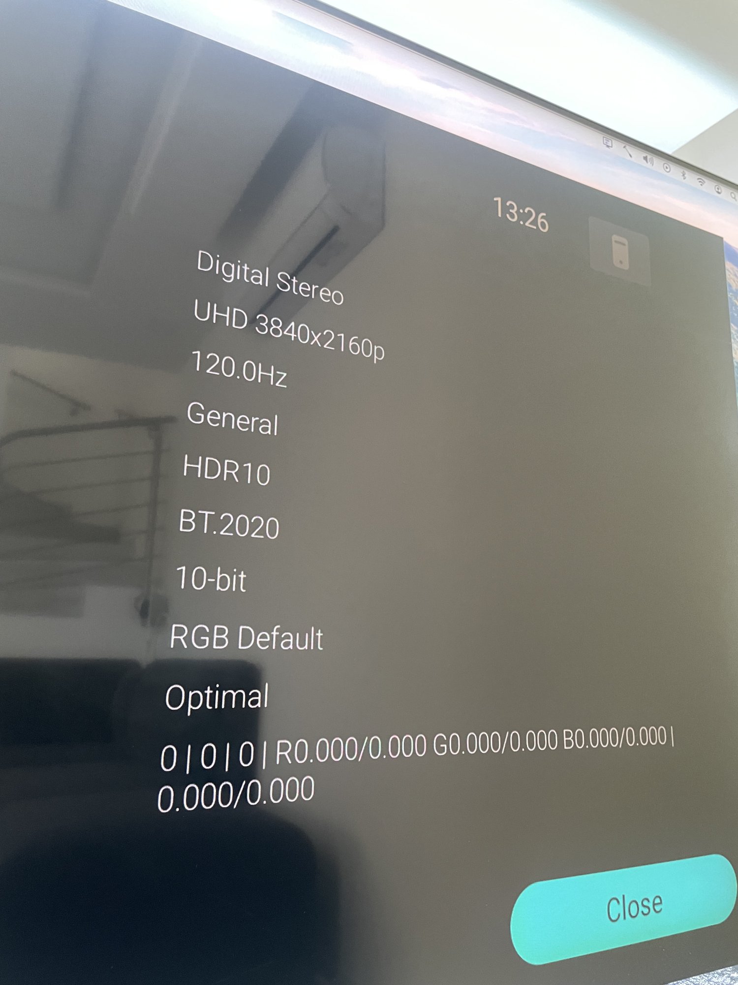

Complete success. Thanks @AironMan for the step-by-step instructions and the firmware update for the 201388-GRY!
One annoyance though is that Config Protection does not seem to properly protect HDR status and I have to re-enable that after every sleep. I'll fix that in an update as it can't stay like this!
Note: I use a Philips 9506 mini-LED TV, but it seems to behave the same way as the LG C2 in this regard.
can you tell the code you used on remote to get that info please?

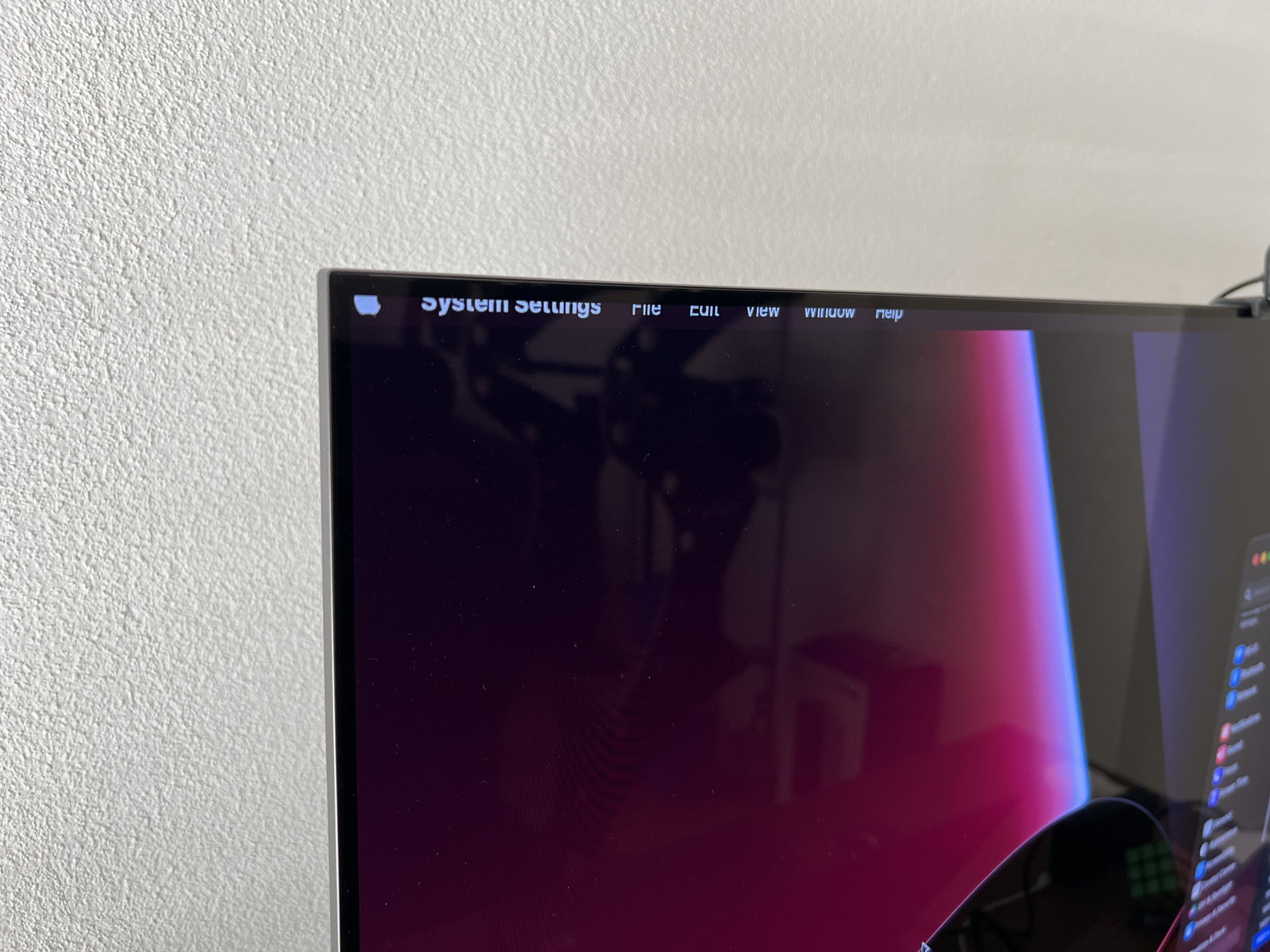

I have a super weird issue that nobody else is reporting as far as I can see.
I’m using LG C2 and the Cabble Matters adapters, flashed for 120Hz with a M2 Mac Mini.
It seems like the « signal » doesn’t fit my screen, that is, the top bar is cropped, so is the bottom of the screen.
I don’t have the issue if I connect directly via HDMI (but then, no 120Hz).
This is super annoying and really makes it harder to use. This is less pronounced if I use 1920x1080 (this is how it is in the attached picture). As 3840x2160, well I cannot see the top bar AT ALL.
Any idea?
Two hours trying to fix it and obviously I find the solution a few minutes after my post.
Leaving it just in case anybody encounters the same problem:
On the LG Settings: Picture>Aspect Ratio>Just Scan>On (was set to Auto, off results in the same cropped screen)
Any idea? View attachment 2376903
U hace to go to C2 burn in settings and disable picture moving, also u have to enable HDMI input to PC or 4:4:4
Try setting the hdmi signal type to PC if you have not done so.
EDIT: nvm just noticed your other messages.
