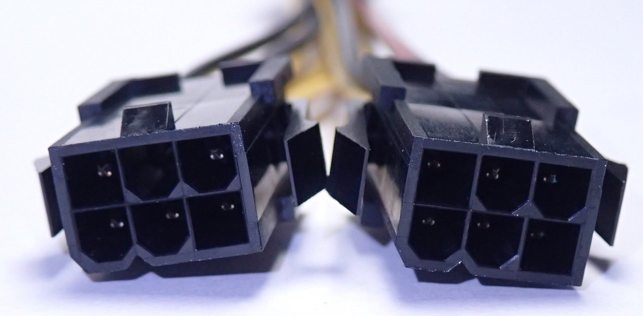

Thanks for the reply!
So, since I have a 8-pin RX480 (I just found out), I should use a 2x6pin -> 8pin, right?
I could maybe take one 6pin from one of the HDD bays?
And the other just from the pcie 6pin?
yes you need 2x6pin to 8pin
you'll need two sata connector to make one 6pin
Reactions: itdk92
I have a 2012 Mac Pro on the way and a Powercolor Red Devil RX 480 (as you do) right now. I would assume that the PCI-E power headers on the motherboard are male so how would a 2x6 pin - 8 pin adapter like this (https://www.amazon.com/PCI-Express-.../B00VWEGKD4/ref=sr_1_1?ie=UTF8&qid=1480025401) work?
Isn't the idea to use both 6 pin headers on the motherboard to one 8 pin for 8 pin cards because of 75w limit on power draw for a 1x6 pin connector?
I've looked everywhere for a cable that would be reversed and I can't find one.
Am I not understanding how this works? Probably hah.
Could you please help clarify? I'd really appreciate it since I'm so confused...
Thanks!
And happy thanksgiving (if you live in the states)
thats the wrong adapter. The search term should be "dual 6 pin to 8 pin PCIe" here's what you'll need
http://a.co/iSmjSQY
the one you linked on your post is a single 6 pin to dual 8 pin. Thanks for the greetings, happy holidays and I hope this helps!
