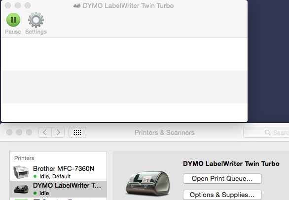

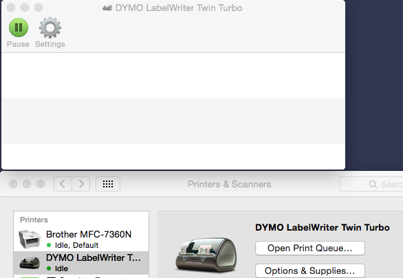

Here are my queue shots:
Before:
After:
Crazy time
What the heck is going on????
