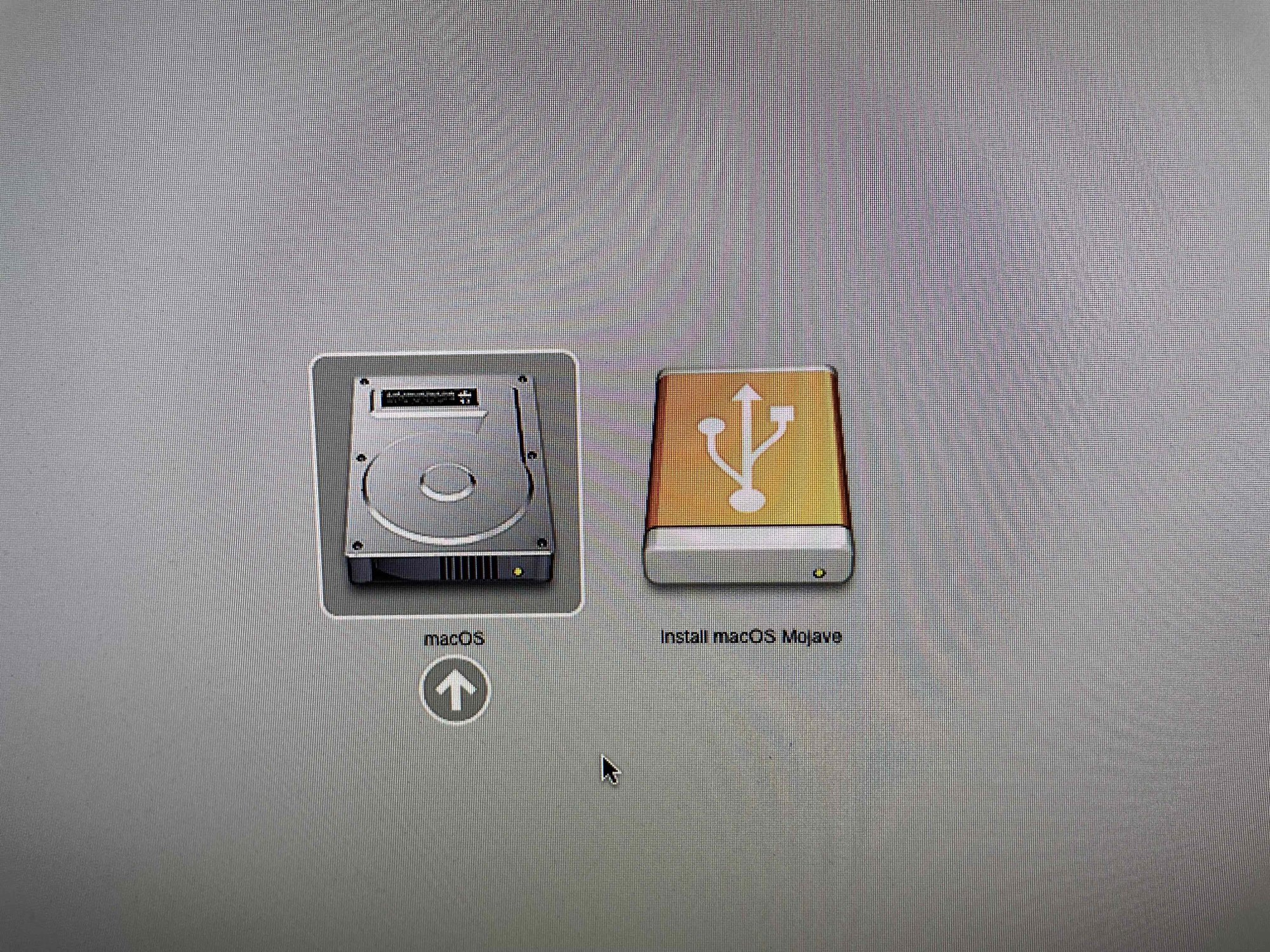

I have just added this to my system, after following Martin Lo's excellent detailed instructions I have this machine in the signature showing the grey boot screen with multiple hard-drive icons, one of which is EFI (I have open core installed via Martin's package) which means Vega56 is performing as expected!
Reactions: Bmju
