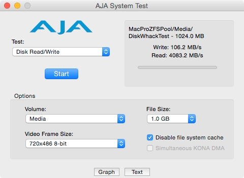

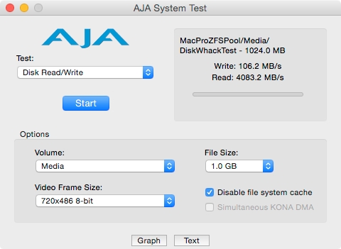

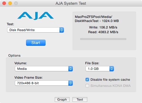

Why bother with hardware raid when you can use OpenZFS? All you need is a PCIe eSata card with port multiplication (I use a Firmtek 4 port card). I have been using that very same Sans Digital 8 bay tower for a few years now with ZFS and the Firmtek card with OS X (now El Capitan) and it performs superbly; I have even pulled the power plug on it while writing to test it; no data loss; not ever. Cost? TowerRaid box + $200 Firmtek card.

What are your read and write speeds with OpenZFS ?

Per AJA Test (disk whack 1 GB file):
106.2 MB/s write
4083.2 MB/s read
This is from a 4 x 4 TB mirrored pair Zpool inside '09 MacPro; Sata II speeds of course. Writes not so good, but reads are. Good enough for my uses and cheap.
