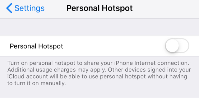

Instant Hotspot is now working with the latest release for me now with ATT.
Wondering the same.
12.1.3
