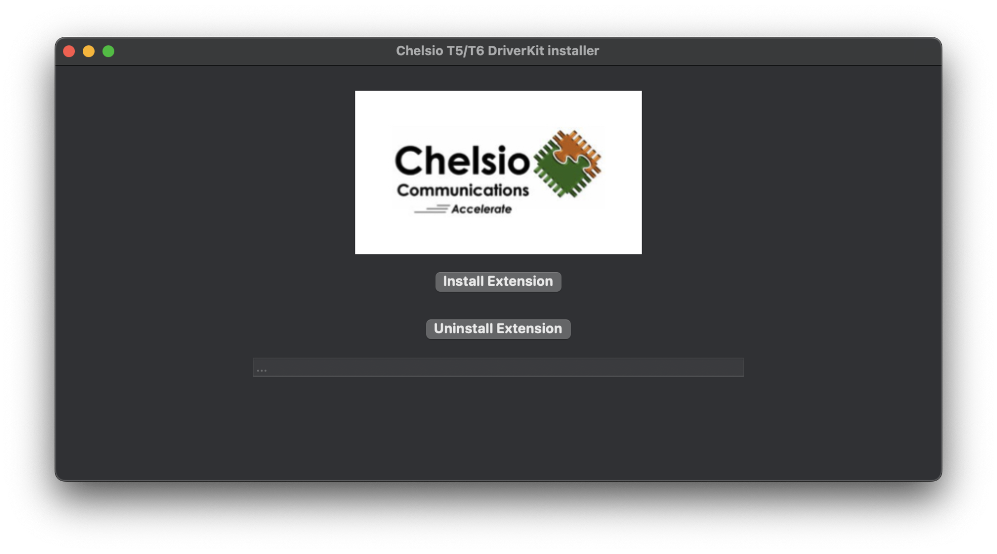

Chelsio recently released a DriverKit-based driver for their T6/T5 NICs, though it doesn't seem to work on my system. Has anyone tried it out?
Tried it out macOS Sonoma and Sequoia but the driver does not load. The firmware was updated to 1.27 and verified on Windows. Maybe you can update your kext?

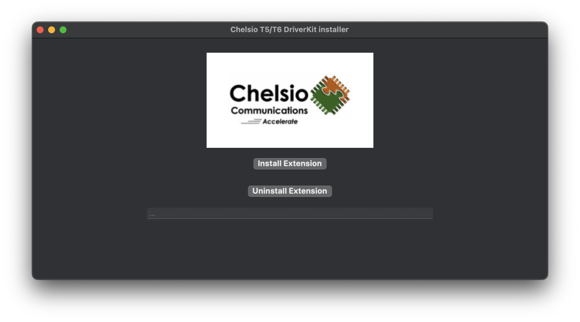

Have you launched the app after install to install the extension? Just running install on pkg doesn't install drivers? cxgb.app
Have you launched the app after install to install the extension? Just running install on pkg doesn't install drivers? cxgb.app View attachment 2513359
Yes, did that but no luck. The old driver works but not the new one. The old one has few bugs. Note that I already allowed the extensions from Privacy settings so that shouldn't be an issue. Is it working on yours?
