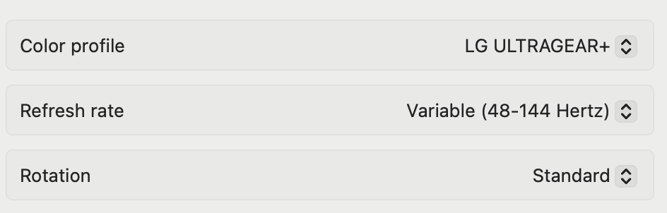

Another piece of advice is if your monitors support gsync or freesync, enable it. Apparently m1 and m2 macs support variable refresh rates:

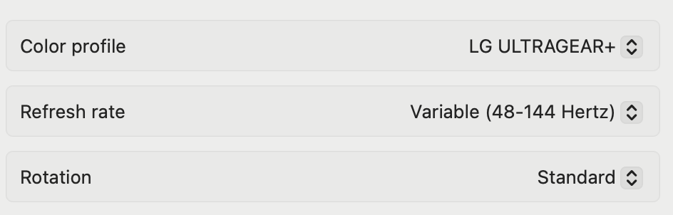

Another piece of advice is if your monitors support gsync or freesync, enable it. Apparently m1 and m2 macs support variable refresh rates: View attachment 2156101
Will try this, thanks
