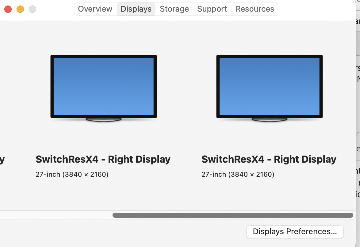

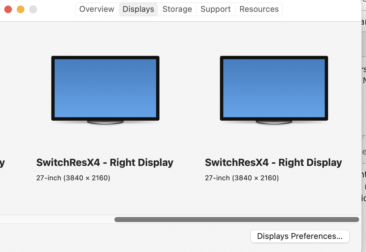

I seem to have solved this problem for me - I have now had no random swapping of monitors during the last 20 or so wakes from sleep. I think the problem may have been associated with both monitors having the same (default) name - with (1) and (2) appended. I did this sequence:
1) I unplugged the right monitor and used switch SwitchResx to change the name of the left monitor to "Left"
2) I unplugged the left monitor, replugged the right monitor and changed its name to "Right"
3) I replugged the right monitor
The two monitors now have different names and everything works fine - the different names could be confirmed by eg looking at Display Preferences or "About this Mac"
Strangely, after about 10 mins the name of the Left Monitor changed to "Right" so both monitors now have the same name. I've repeated this process with the same outcome - but nevertheless it has solved the problem. This is what it looks like now:

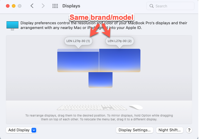

I have 2 Lenovo 4k monitors that I use, both via USB-C. The problem we're all encountering is they swap positions sometimes on wake from sleep, power on, or plugging in the monitors. I tried just using displayplacer on its own when the monitors are out of order, but that doesn't change which desktop shows up on which monitor, it changes the positions of the monitors relative to one another to make dragging/cursor movement from one monitor to another make sense.
While I'd obviously like this to just work, my biggest gripe is when the logical order of my monitors is not right, meaning dragging my cursor across monitors doesn't do the right thing. In installed displayplacer, ran it to get its output at the bottom and saved that. I waited for the monitors to swap, fixed it on the Monitors system pref, ran displayplacer again and saved its output.
