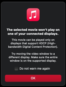

Actually, there might be a real dealbreaker. I knew HDCP movies would not play, but I did not know this applied to music! I can't get any of my Apple Music to play! It says "The selected movie cannot play on one of your displays." It says this for all the music files (not video).
I am definitely NOT experiencing this. I have been playing music steadily since setting up my dual display configuration on my MacBook Air. Apple Music is working just fine. I actually have the Apple Music window on the DisplayLink monitor. Here is my setup:
M1 Air -> Apple USB-C Digital AV Multiport Adapter -> QGeeM DisplayLink Hub
My left 1440p display is connected to the Apple adapter. My right 1440p display is connected to the DisplayLink Hub.

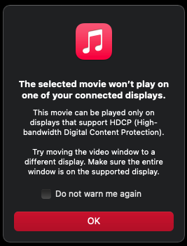

Now, if I attempt to watch a video in Apple Music I am getting the following errors (but NOT for music):
That message is the same exact one showing up when I try to play music! I wonder why this is happening for me and not for you. I’ll keep trying to solve this tomorrow.
Do you have music which was not upgraded to the DRM-free version yet?
