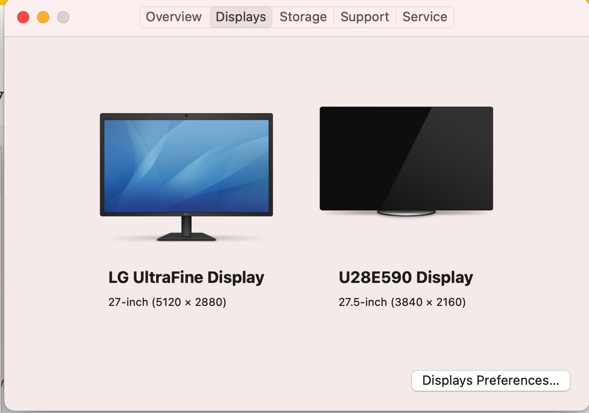

Can confirm that M1 Mac Mini (base model, 8GB ram 256GB ssd) can run full res LG 5K display. And that it can do so while also running a 4K display at full res simultaneously through the HDMI port. Don’t have a second Thunderbolt Display to try a dual set up through the second TB/USB 4 port.
Super interesting! Is this a relatively new LG 5K and how are you sure it’s not doing 4K upscaled? Also, can you tell if the 4K monitor on the HDMI port is in RGB mode or in YCnCr mode?
Apple still sells the UltraFine 5K. Do you really think they'd fail to mention that it runs degraded with the M1 machines? Especially given that they used it for performance testing and list it in the footnotes?
They have done non-standard support things with this monitor in the past (on-screen controls, etc) - why wouldn't they do the same for the M1?
The HDMI 4K monitor looks the same color-wise as it did running off my MBP 15 i9 from 2019. No idea how to tell different but it looks good when doing Lightroom edits off that screen. Take a look at the Mac Mini tear down article from this morning—shows that there in fact seems to be an Intel thunderbolt controller in there that would support this display. So previous speculation seemed mistaken.
