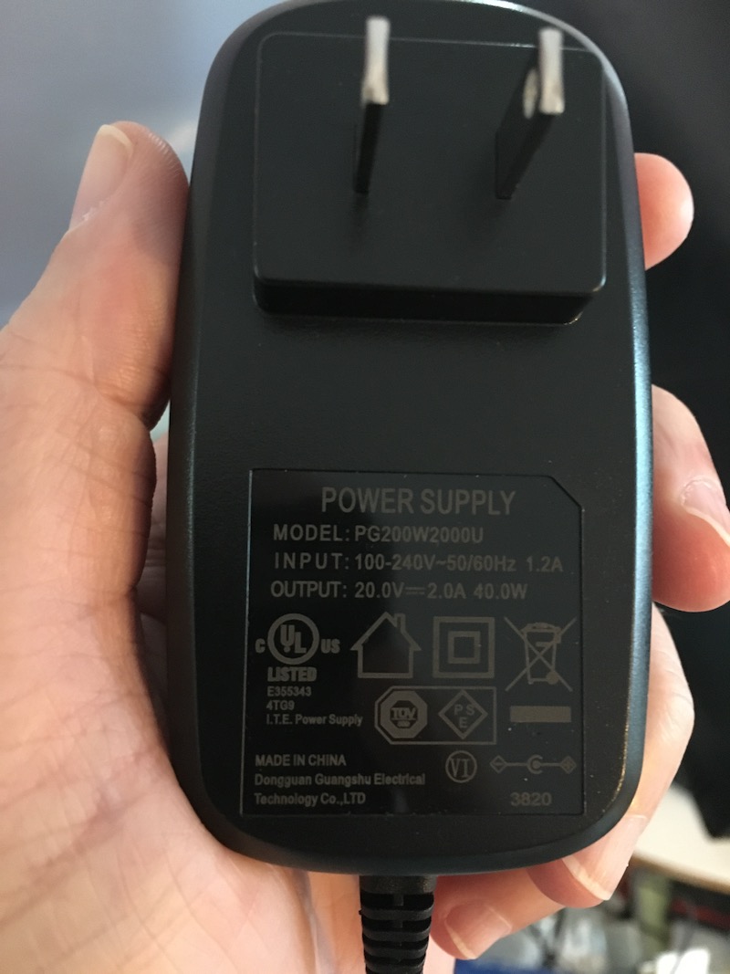

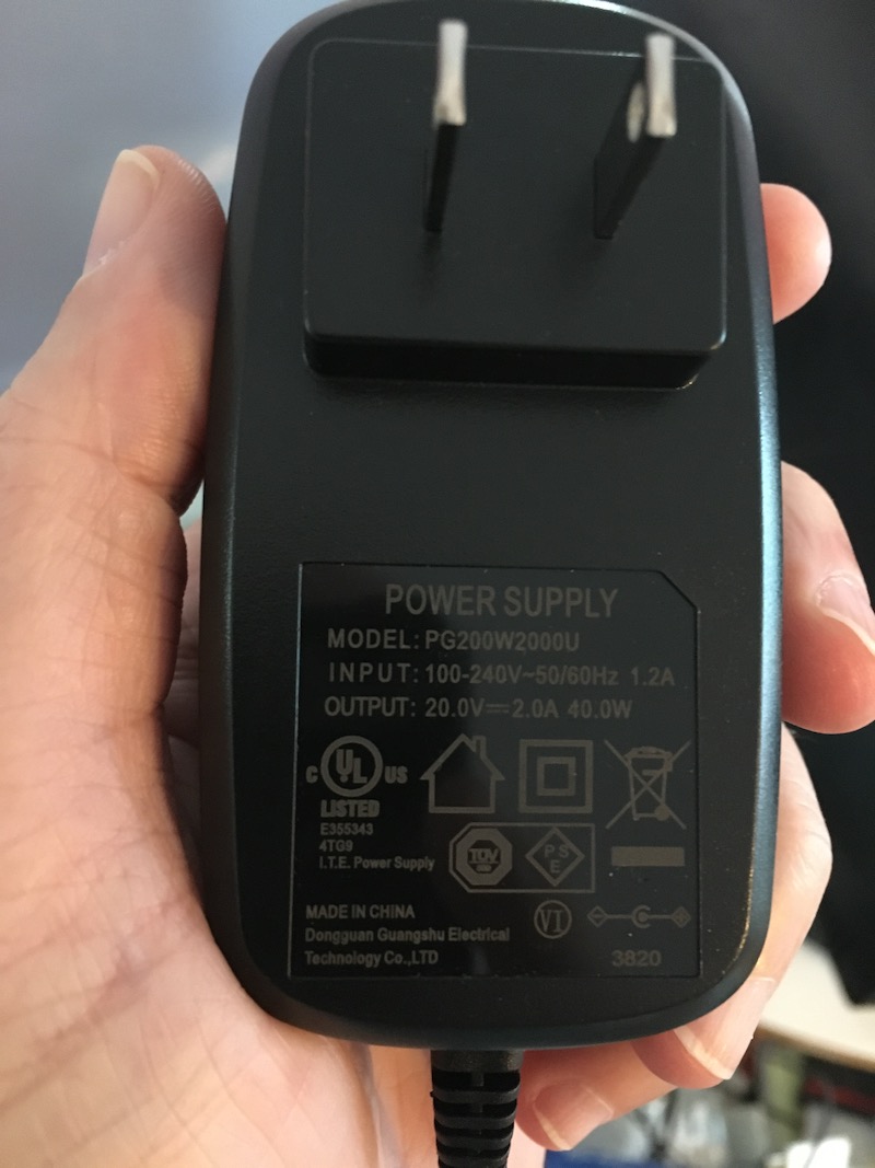

Thanks for the recommendation. Does this Dock support only USA voltages or can it do UK/Singapore voltages?
Here are the specs printed on the power supply:
Reactions: hunkster
