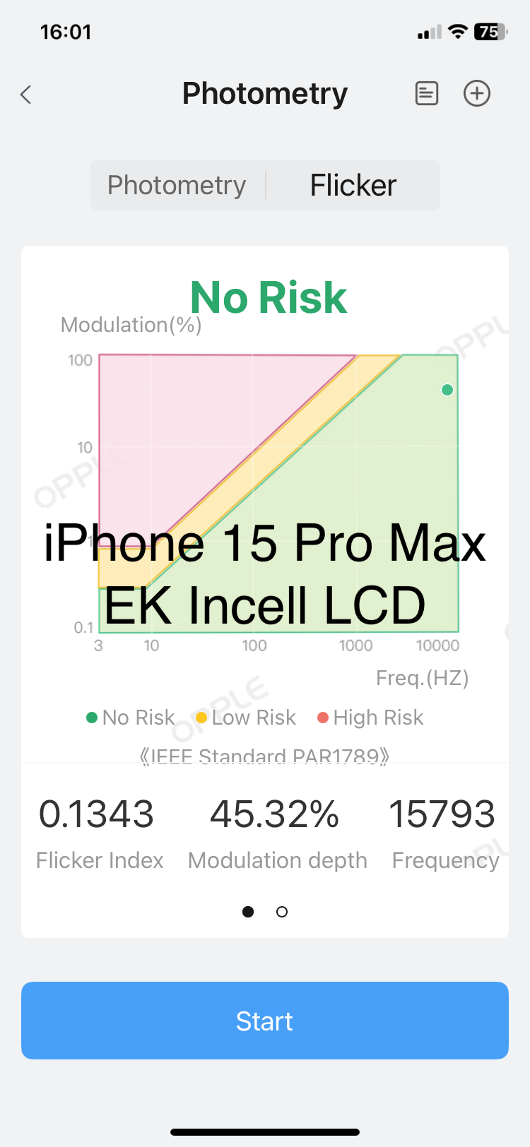

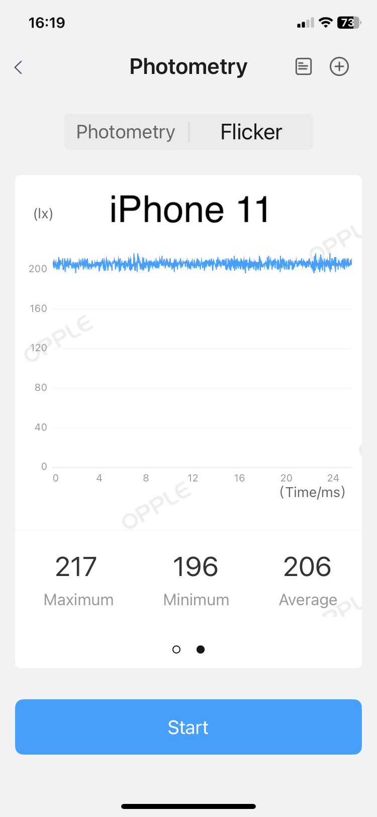

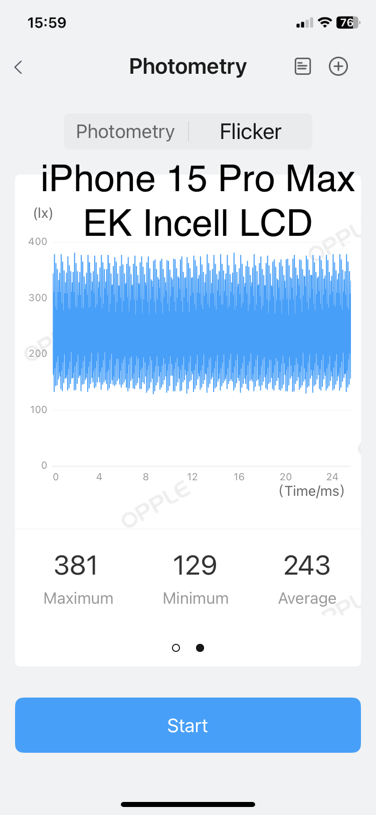

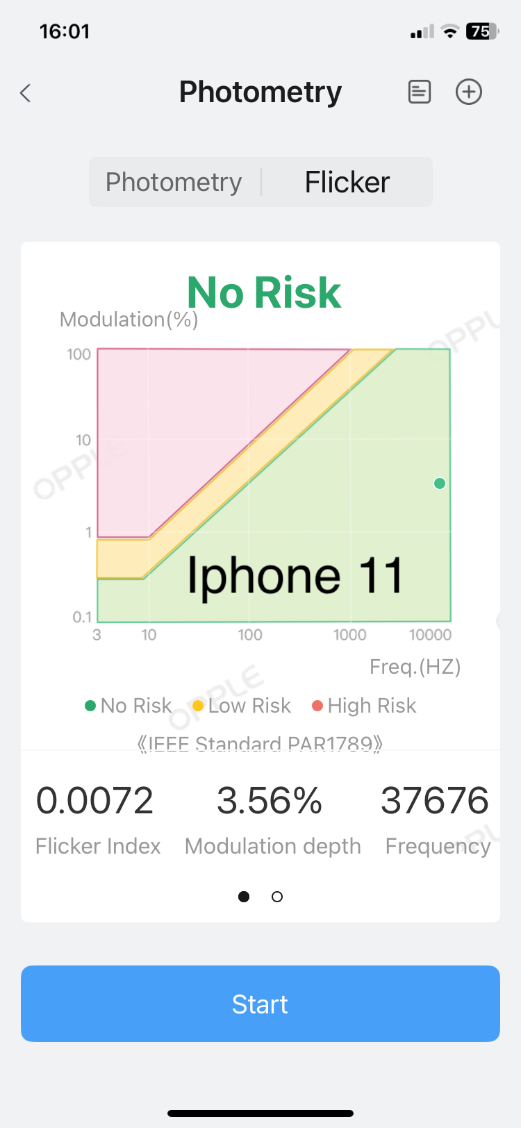

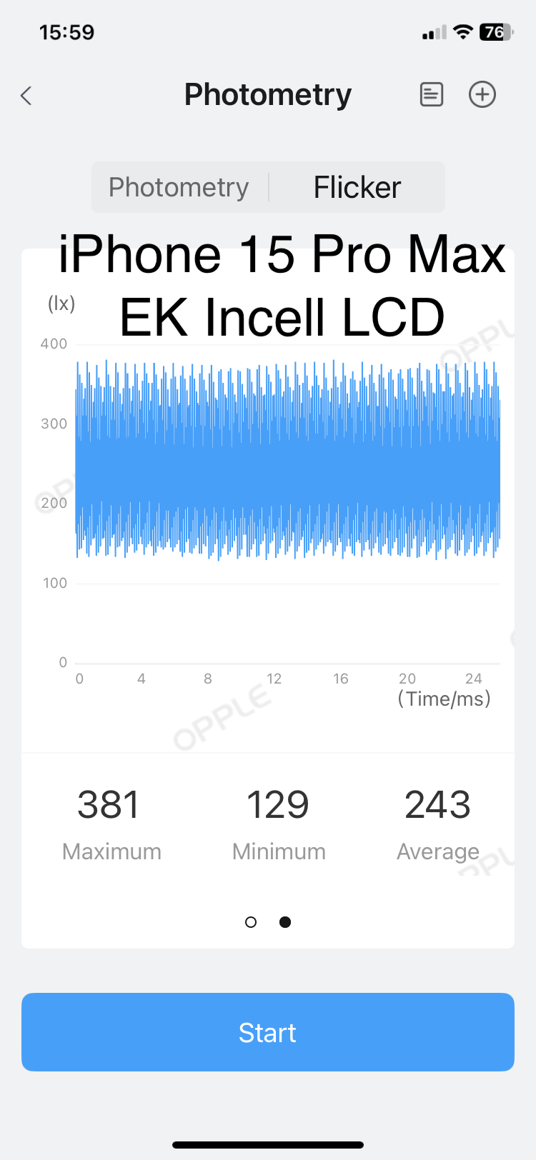

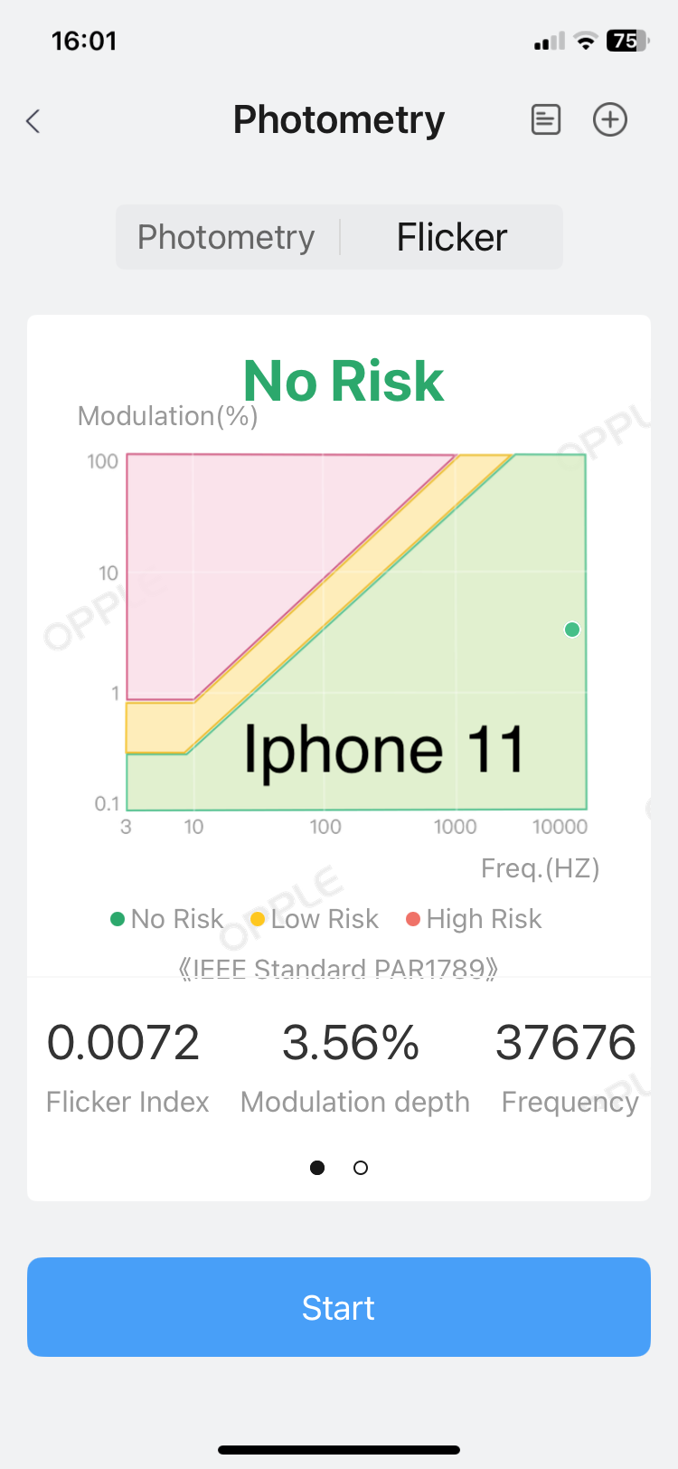

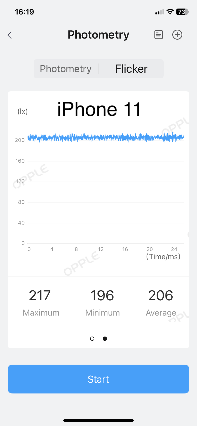

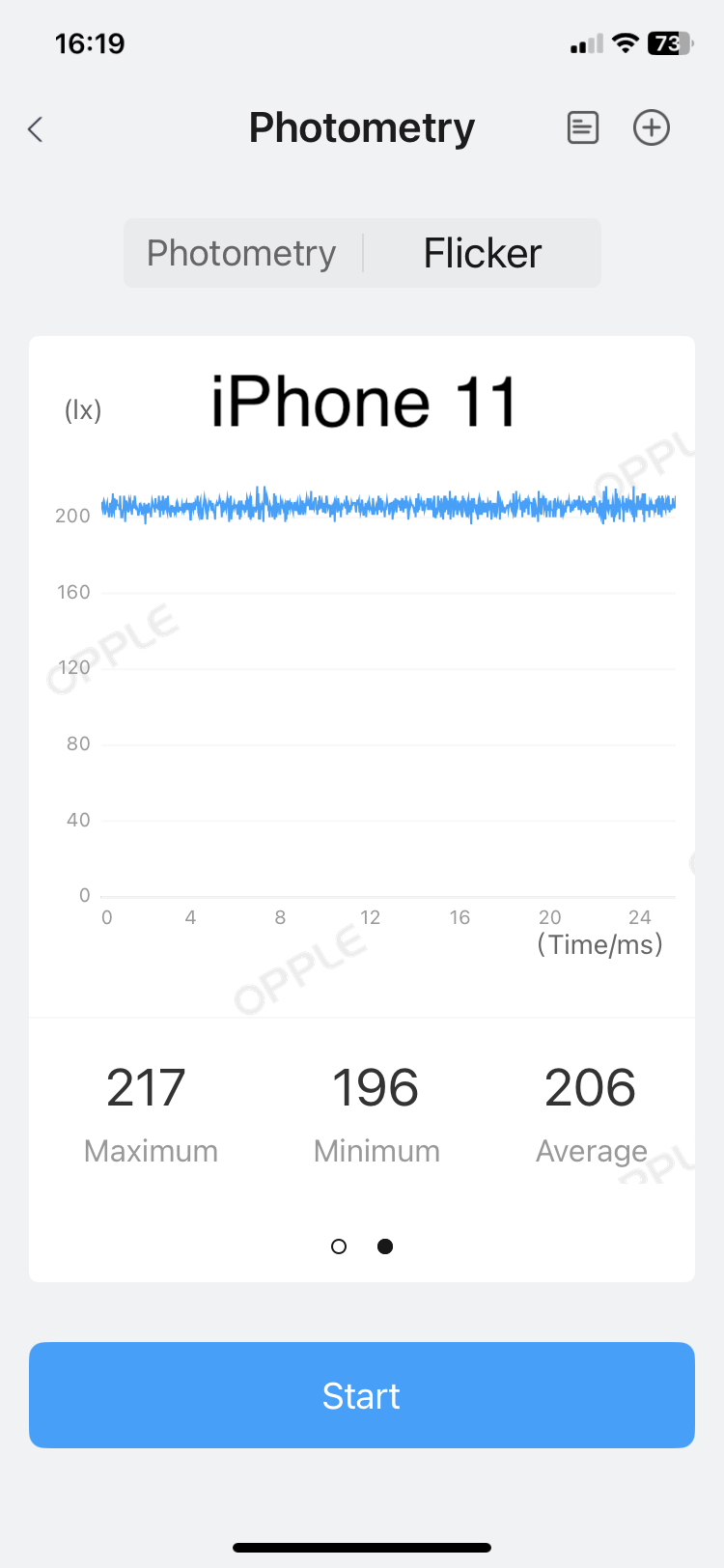

Is it possible to measure the indicators of this screen with Opple Light Master or other similar instruments?
I found from the previous replaced screens that, although they were LCD, their luminosity was erratic and appeared flashes on the graphics with a rather large amplitude, different from how OLED works, but still being somethingsimilar to them, which resulted in the same negative effects and inability to use them.
I will show in the following message.

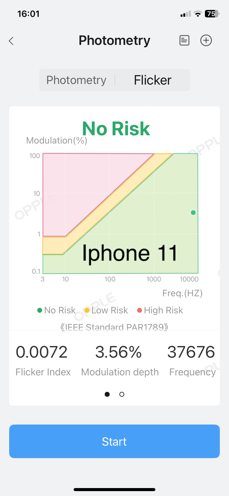

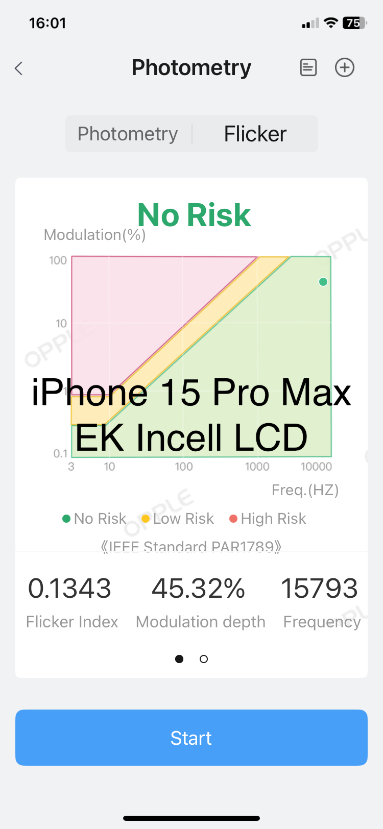

Here you can compare the display of iPhone 11 and iPhone 15 Pro Max (replaced by LCD screen EK Incell).
As you can see from the graphs, the iPhone 15 Pro Max LCD screen uses a technology similar to PWM, despite the fact that the screen is LCD. There is a rather large amplitude (modulation depth), which leads to almost the same negative effects as OLED screens.
It appears that the control of the lighting control method is managed by the controller on the iPhone board.
Therefore, it is very curious whether any alternative screens can give similar indicators to the iPhone 11 and previous LCD models.

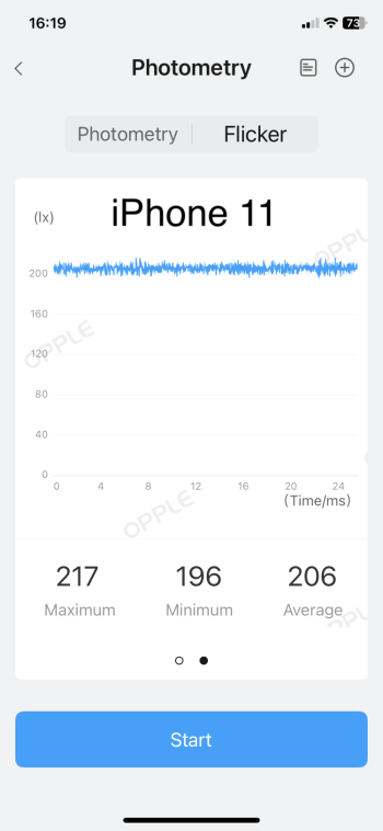

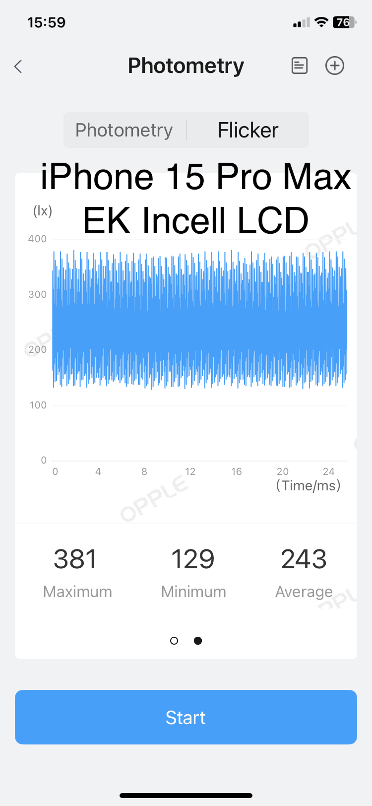

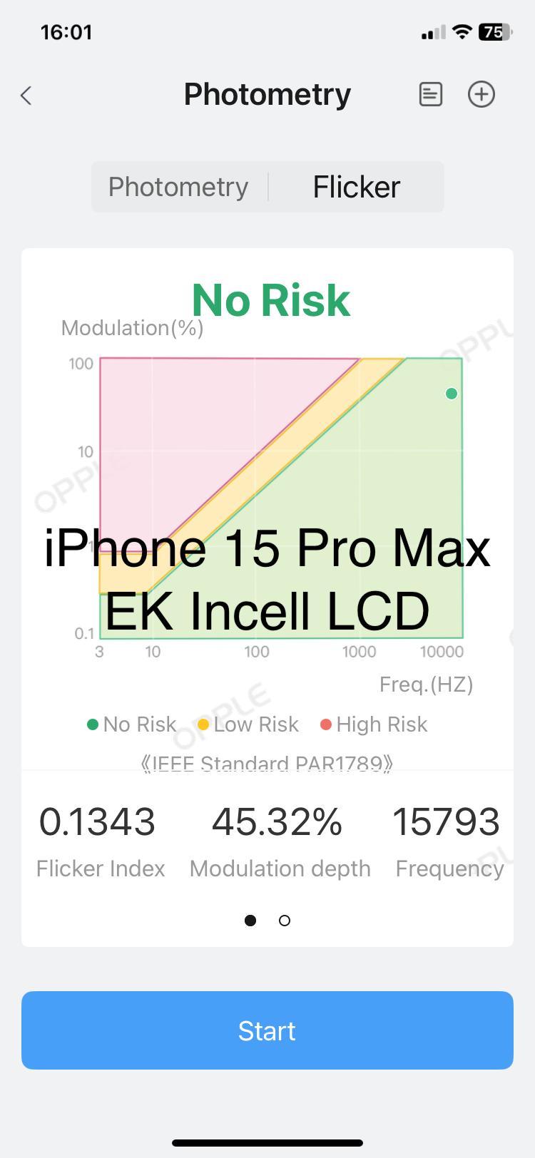

To be honest, I would have expected so. When you change the display, does it also change the driver interface? If not the phone might just no ba capable of driving DC dimming … but i am not sure whether it works like that, does anybody know?
