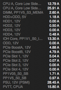

I can add that even when overclocked considerably, my GTX 680 with two 6-pin connectors, power draw was always under 200W and the draw from the two connectors and PCI-e slot were always quite even. About 60-ish watts from each.

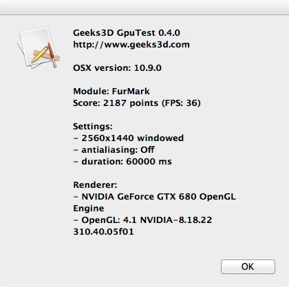

I ran Furmark prior to testing the overclocking limits of my card. The results were largely the same.
I would run it now on my current clocks but I'm in Mavericks and Furmark doesn't run in Mavericks. Computer is busy doing some stuff and I can't reboot in to Mountain Lion at the moment.

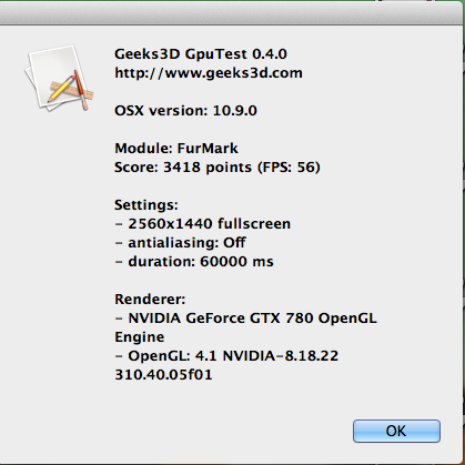

Got it. I was running 0.5.0 which doesn't work with Mavericks. 0.4.0 does.

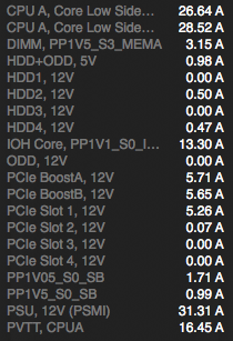

I also note that the GTX780 is 40-50% faster than that 680 you tested. GK110 is truly a generational step up from GK104, at least for running Furmark. Or perhaps GK104 knows to ease throttles to keep power draw low? I don't recall the barefeats tests showing 780 to be 50% faster than 680.
Power consumption is higher. Running test I hit 5.48A, 8.35A, and 4.02A using scale you did.

As you can see from my post above, my GTX 680 card with two 6-pin connectors are pulling 68.52W and 67.8W from the 6-pin connectors and 63.12W from the PCI-e slot. All are within spec since each of those connections are rated to provide up to 75W.
You can also see that the GTX 780 is pulling 65.76W, 100.2W, and 48.24W. Obviously, 100.2W is above what the Mac Pro's logic board was rated for.
It can work, but you will be drawing more power from the Mac Pro's power connectors than they were intended for. 6-pin connectors are rated to draw up to 75W. 8-pin connectors are rated to draw up to 150W. The PCI-e slot is rated at 75W.
