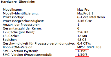

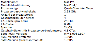

I have a flashed 4,1 to 5,1.
If it looks like this flashing was successful:
BEFORE flashing boot-ROM should be B07:
h9826790
