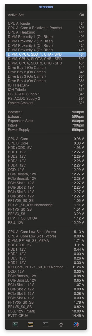

@h9826790, back when you mixed all those different RAM types, was there noticeably very high fan speed?
Have to test that again later. I was using some fan control software, that may suppressed the abnormal fan speed (if any).
From memory, my fan speed was normal. That's with the fan control software which will raise the minimum fan speed when the CPU is warm. PCIe fan and PSU fan setting was native by that time. And the CPU target fan speed is also untouched.
AFAIK, OSX will raise the target fan speed when the system believe it's required. That's why I only raise the minimum fan speed in my own setting, but leave the target fan speed untouched. So that both my setting or the system can spin up the fan. The higher fan speed always win.
I am quite sensitive to the fan noise. And I didn't notice any higher fan noise when I was mixing the RAM. Therefore, I believe that didn't affect the fan speed.

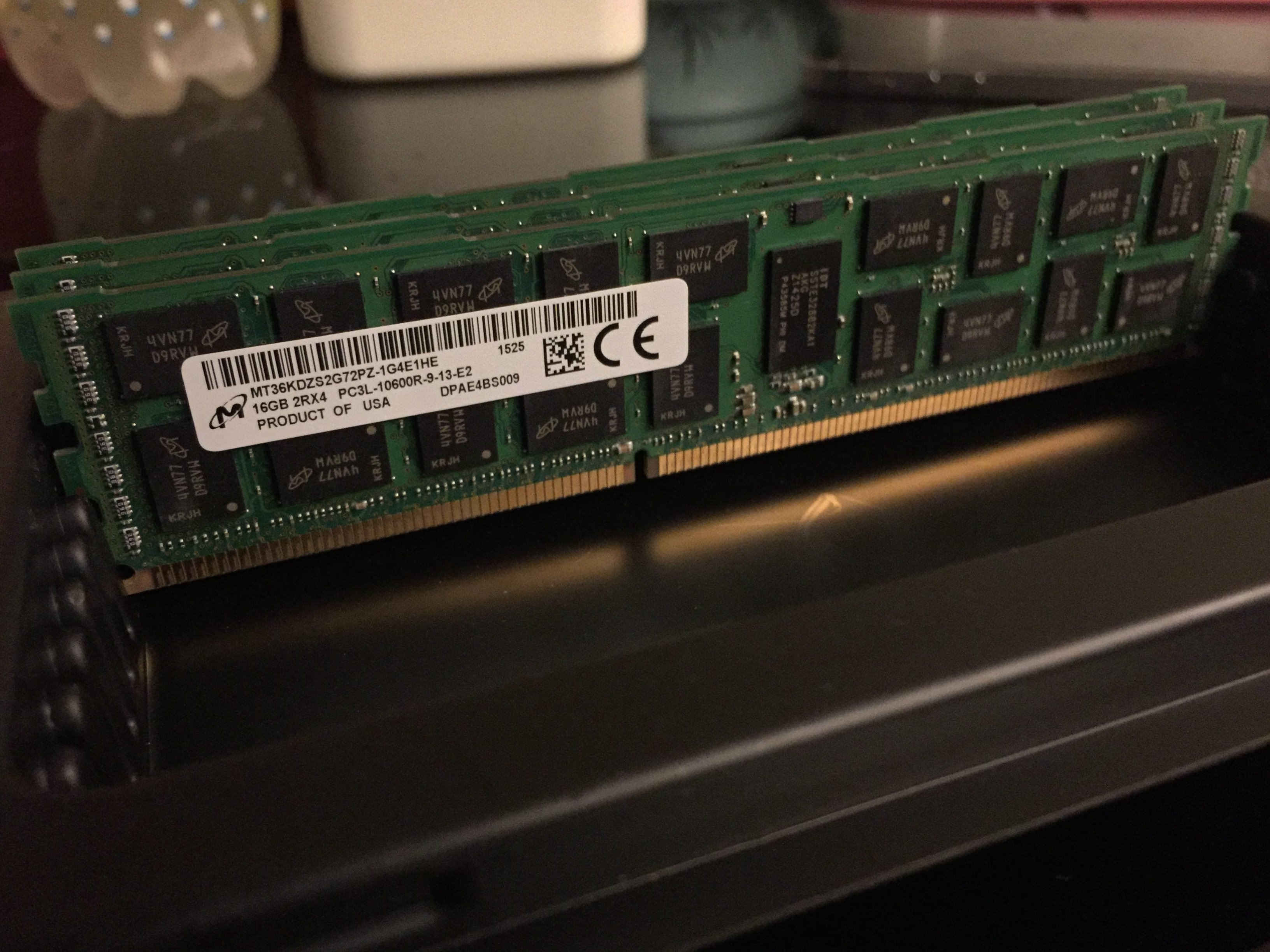

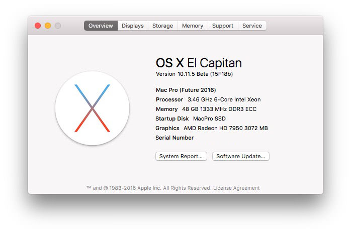

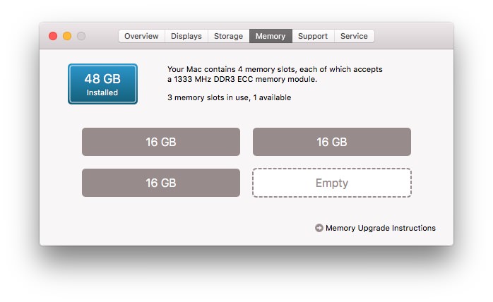

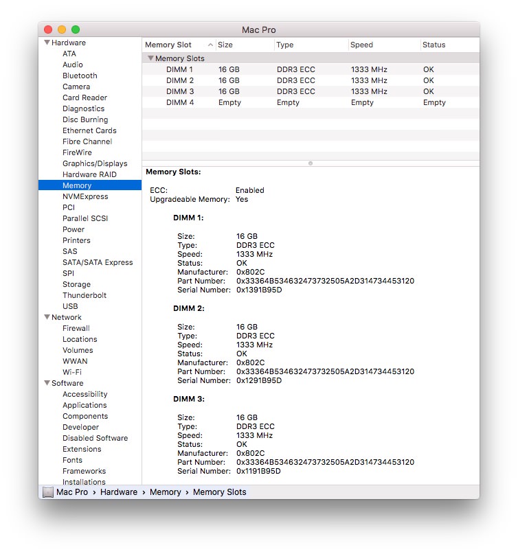

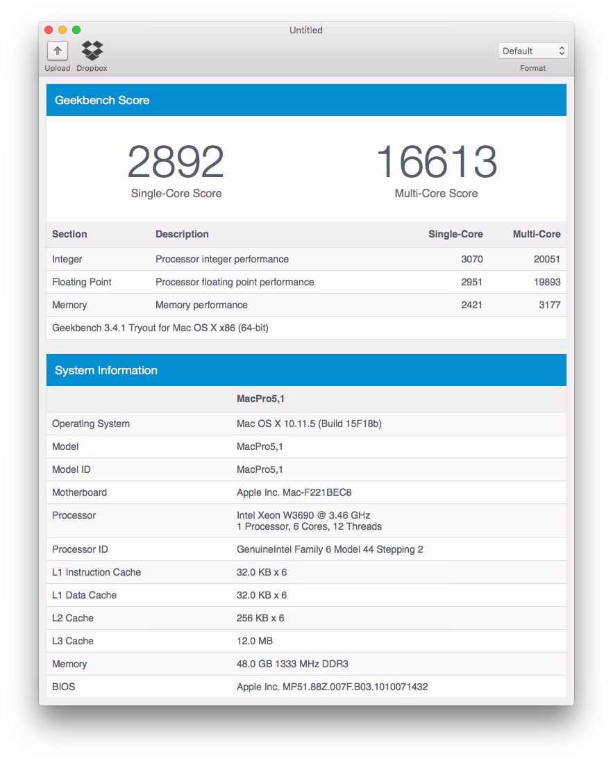

The new RAM received. Work as expected. 3x16G 1333MHz ECC server memory, end up cost me $190 (including shipping), a bit more than my initial expectation, but still very good deal IMO. And this memory comes with the temperature sensor which works on the cMP as well. Initial quick test shows reasonable score in GeekBench.
Update 1: just went to Micron website to download the data sheet of this RAM. All parameter well fitted the cMP. Max temperature is 95C (double refresh rate when above 85C), and my RAM component temperature never go above 60C under stress (Ambient up to 34C).
"Product of USA"....
Yeah, I notice that as well. But it's strange to say "product", but not "made in", I guess it's just some product will ship to USA. It's very common the China factory get some product that should only export, and put them on Taobao sell for cheap.
This kind of product usually has better QC. Much more reliable than the average products on Taobao.

75C is nothing for Xeon. Of course the fan won't spin up. From my observation, the fans are calibrated to spin up when the CPU temperature reach ~80C and keep it at around 85C.
Anyway, my Mac is a flashed 5,1, upgraded with the W3690. And it something running at 100% load continuously for a week. No shut down issue.
If you believe that's temperature related. All you need to do is install MacsFanControl, manually set the fan to 50%, and run the stress test again. 50% should be more than enough to keep the CPU cool.
