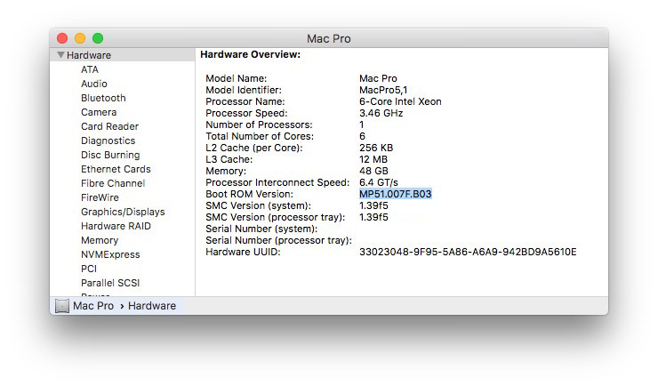

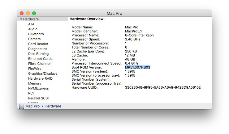

It's not unusual that someone already flashed it before. Anyway, that's your boot ROM version?

Then you're set to go. The person who had the system before you could have flashed it already. Anyone tech savvy enough would have done so, if it can be done. Upsides. ;-) You practically got a "2010" model for the price of a "2009". Giving it at least another couple of extra years for longevity. So long as Apple keeps supporting it.
