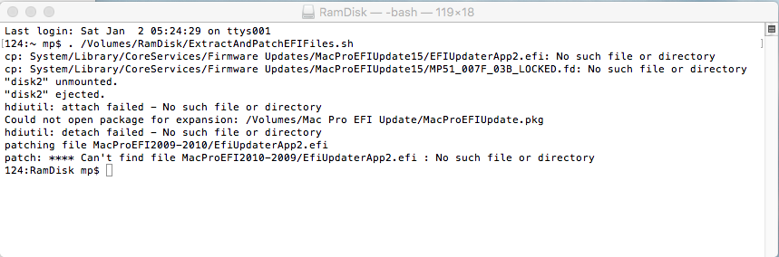

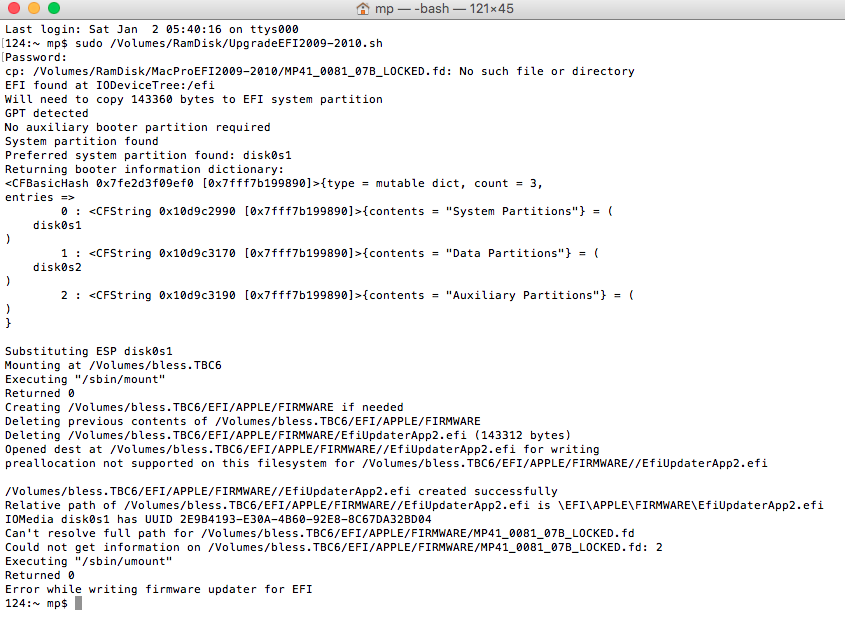

i got this MacPro4,1, Boot ROM Version: MP41.0081.B07, Nvidia Geforce GT 120.
obviously, i want to upgrade to firmware MacPro5,1.
- i tried to use the "Mac Pro 2009-2010 Firmware Tool" on mavericks, yosemite and el capitan (here i disabled csrutil).
- double click the "Mac Pro 2009-2010 Firmware Tool" > Click "Upgrade to 2010 Firmware" > Type in the admin password.
- i get the The program ahs encountered an error: 5530.
- i tried this: https://forums.macrumors.com/threads/mac-pro-1-1-firmware-upgrade-issues.2174741/post-27228336 (it is for the 1,1-1,2 firmware, i thought it would have the same installation procedure).
- mac pro efi update 14 and mac pro efi update 15 are mounted (can be seen on finder sidebar).
- an empty! RamDisk is created on the desktop.

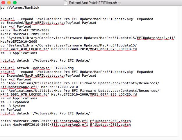

- according to the above procedure, i need to copy files and delete some lines of code. it seems that the ExtractAndPatchEFIFiles.sh have two(?) sections. one for upgrade, one for downgrade. i just deleted the lines of code on the "upgrade" section (the deleted lines of code, were the ones instructed on the above procedure).

did anybody get this to work?
