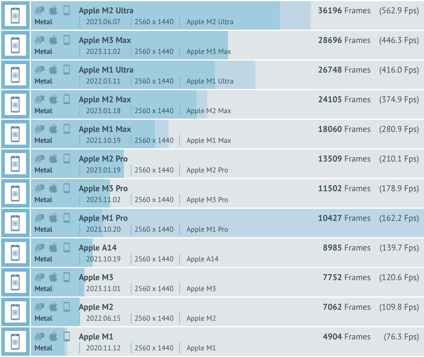

Not Geekbench, but as it’s the only new result I’ve seen, there is a New Gfxbench result. 446fps Aztec High Tier offscreen. Don’t take it too seriously as Gfxbench has some issues.

There are already benchmarks from the M3 and M3 Max, but I’m really impatient to see the M3 Pro benchmarks, for a couple of reasons. First and foremost, for me it’s the sweet spot of raw performance at a still relatively affordable price, so it is my target device, wether the M2 Pro or the M3 Pro Mac mini. And, secondly, because the M3 Pro is the only chip that has reduced the performance cores in favor of the efficiency ones, and it has actually 3 billion transistors less than the M2 Pro. And the memory bandwidth issue. So, I need to see the benchmarks to know wether it is worth waiting for the M3 Pro Mac mini, or just getting an M2 Pro mini.
The M3 Pro appears to be slower in something like GFXBench but again it's old and dated. Or it could be the binned 14-core GPU version and the M2 Pro could be the full 18-core GPU.
