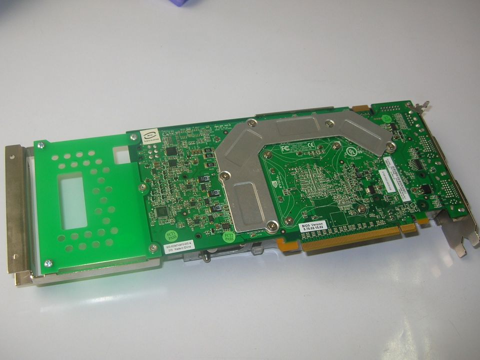

Note: Only the Quadro FX 4500 revision with a metal L-shaped piece on the back of the card can be flashed for compatibility with Late 2005 Power Mac G5s. This revision is known as having 'double-sided RAM'. The newer revision contains RAM on only the top side of the card and is incompatible.

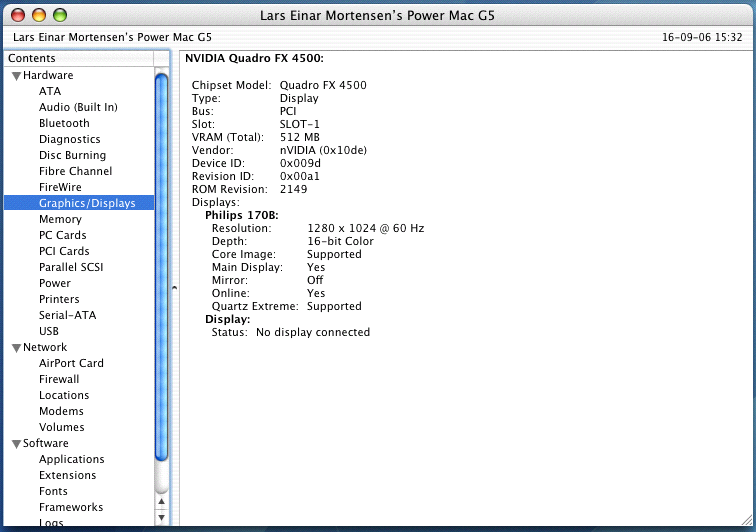

Duuuuuuude, you're my God!
Everything worked perfectly!

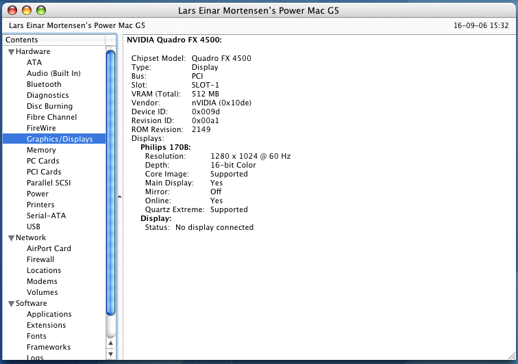

Anyone who has flashed these cards, I'm looking for more info on them.
Do both the DVI ports work on a flashed card?
@LarsG5 Has reported only 1 of their 2 DVI ports appear to be working, has anyone else had this problem with flashed cards?

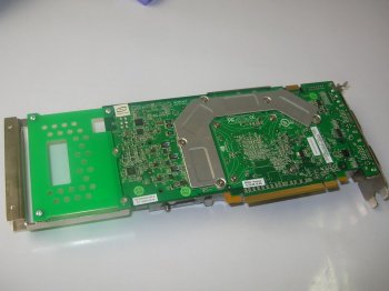

Can someone post a pic of what card one should be looking for?
There are some really cheap ones on eBay, but they don't show good pictures of the whole card, both sides, etc. I'm guessing MOST of them are the wrong kind of card.
I have a PC and can probably easily flash a card like this.
You are going to want to find cards that have a silver looking heat sink on the back. These are the only ones that will work with a G5, the ones without the heat sink will work in a Mac Pro
Indeed, many on Ebay are likely to be incompatible. You should look for FX 4500s with a silver L-shaped metal piece on the back.
