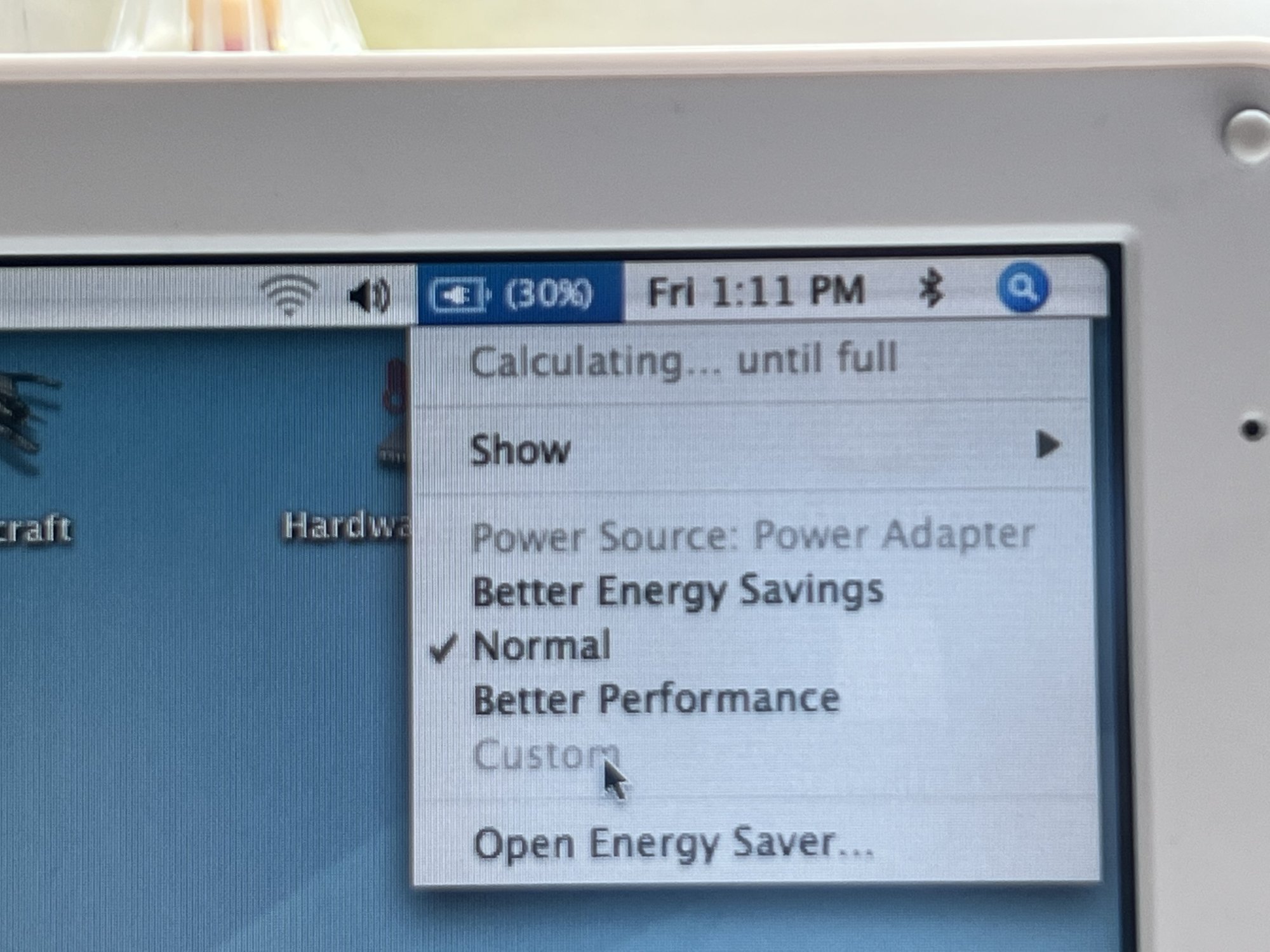

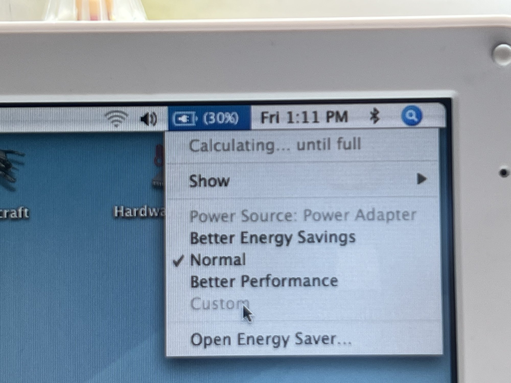

And second question bout power profiles of iBook:
What do they chance? Only sleep and screen off time or it also affect cpu and gpu clock.
The CPU toggles between a reduced speed, on demand ie slows down when idle or doing lesser tasks and full speed.
