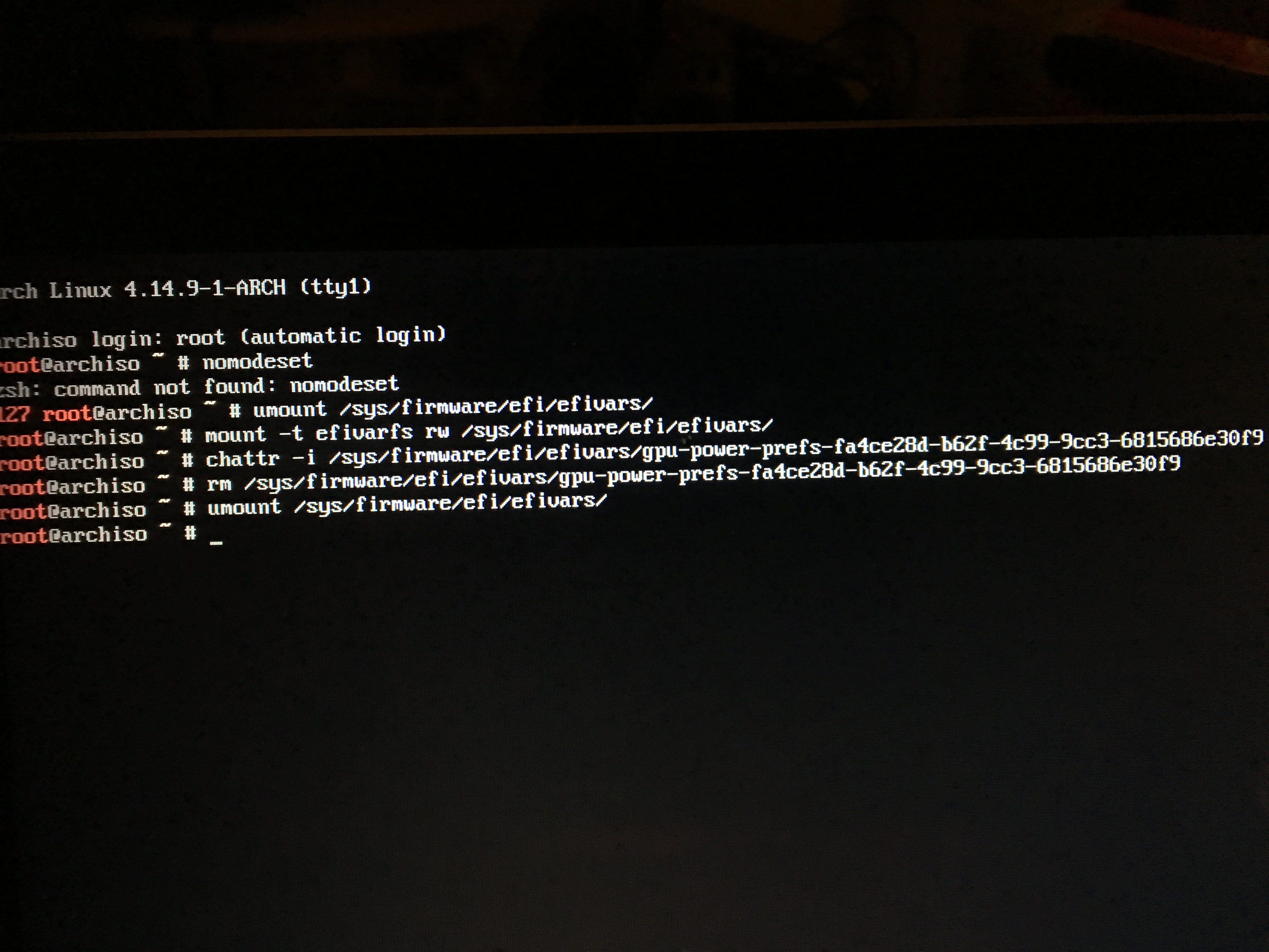

Hey Guys,
First of all, i intend to thank you all for the time you spent fixing this graphic card issue. I started to try to fix my macbook pro late 2011 17 inches this morning.
First of all: trying to do this: 2.2) Edit EFI vars: looks like efivarfs filesystem is mounted by default! So you can already cd /sys/firmware/efi/efivars and ls to explore this directory and see if there is a "gpu-power-prefs-..." variable (where ... is UUID of this variable).
I get: cd:cd:6: string not in pwd: /sys/firmware/efi/efivars
I decide to ignore it
In a second time i do: *) rm gpu-power-prefs-…
i get: cannot remove because no such file directory
My guess is I have not the gnu power prefs file so i get to step 2.3) Create a new gpu-power-prefs-… file (Original credit mentioned above, https://github.com/0xbb/gpu-switch/blob/master/gpu-switch, Credits to AppleMacFinder):
I get: operation not permitted so i do the step:
To remove “gpu-power-prefs-..." variable it is necessary first of all to unmount efivars:
*) umount /sys/firmware/efi/efivars/
then mount efivars in read/write mode:
*) mount –t efivarfs rw /sys/firmware/efi/efivars/
*) chattr -i /sys/firmware/efi/efivars/gpu-power-prefs-[press TAB to autocomplete]
*) rm /sys/firmware/efi/efivars/gpu-power-prefs-[press TAB to autocomplete]
then i was able to do
*) printf "\x07\x00\x00\x00\x01\x00\x00\x00" > /sys/firmware/efi/efivars/gpu-power-prefs-fa4ce28d-b62f-4c99-9cc3-6815686e30f9
2.4) Add immutability to the gpu-power-prefs-… file (Credits to AppleMacFinder):
This chattr command is supposed to lock a file to make it accessible only by "superuser" - and so that, while booting, your EFI will have no chance to screw up your gpu-power-prefs-... variable under any circumstances
*) chattr +i "/sys/firmware/efi/efivars/gpu-power-prefs-fa4ce28d-b62f-4c99-9cc3-6815686e30f9"
and then:
2.5) Unmount efivars and reboot (Credits to AppleMacFinder):
Could not unmount efivars if you are inside this directory, so change to the root directory
*) cd /
Guarantees that your EFI variables are flushed to efivarfs filesystem, please unmount it safely before rebooting)
*) reboot
All my code lines i did step by step was in the root:
root@archiso / #
I don't know if its ok

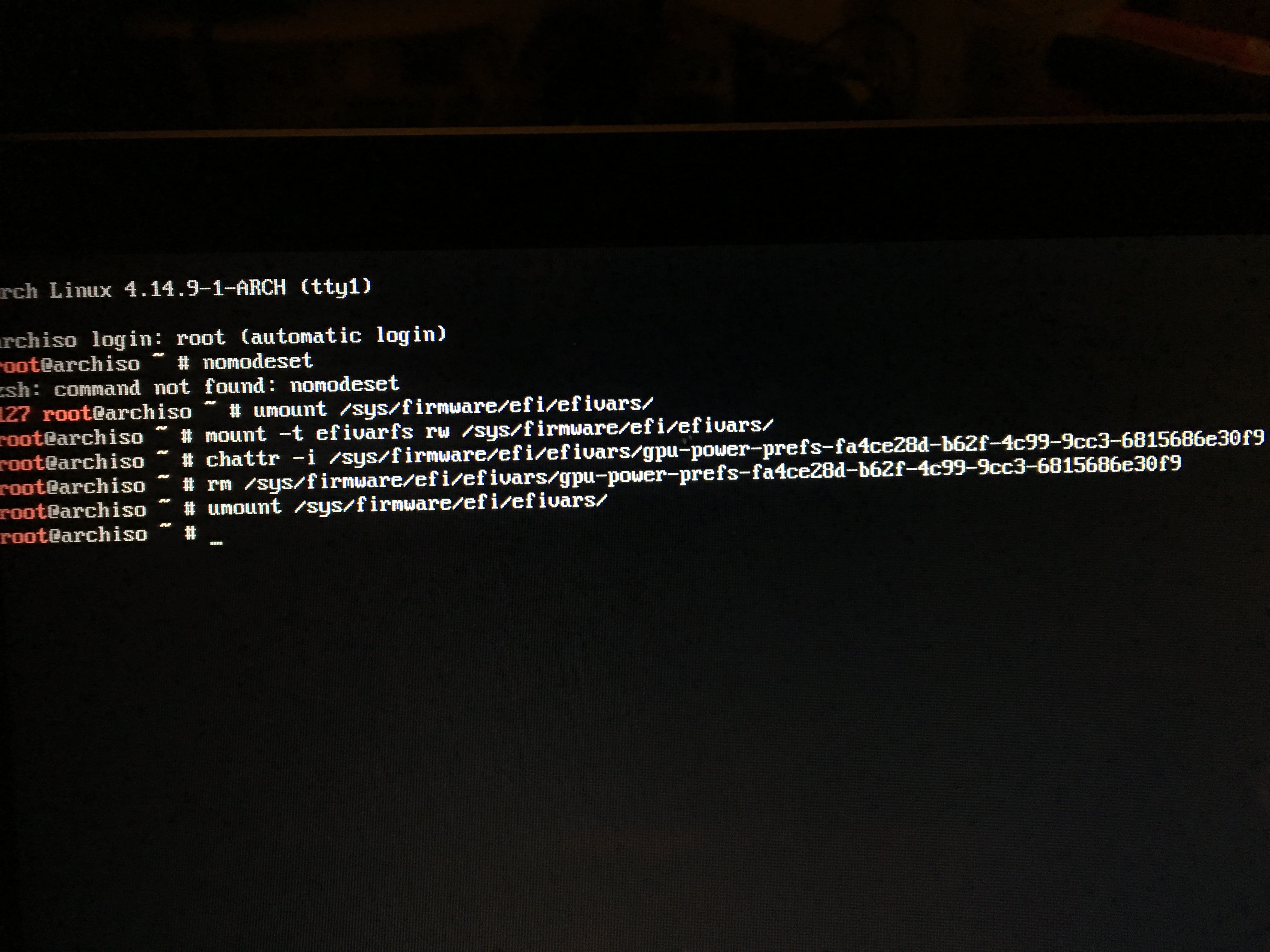

HELP!
I’ve got two MBP on that is not even booting anymore and on that is going out.
2011 and even a 2010 doing the same thing.
I was lucky to get the 2011 under apples recall or whatever they called it and got maybe a year out of the logic board replacement and now I’m in the same place as everyone in this board.
The confusing part of the solution is there is three different concepts with the final one being a Linux code solution.
Thing is for the layman who has no coding it’s very Greek! No offense as it seems helpful to most but not as simple for me.
If someone can please look at my screen shot and help me with what I might be doing wrong? FYI I’m using. USB thumb drive so I’m not certain why I would use CD/ ?? I tried that as well but did not seem to do anything.
I did reboot from Linux and checked and nothing happened GFX still offers Discreet!
I did do the pref ls and see I did seem to have that preference already in one computer.
If someone can really speak very simple to me and actually copy and or paste and or write a very simple code steps so that I might actually record a video on how this is actually done so that everyone else can have a better visual of how it’s done.
FYI
With the current Linux ISO it seems to go directly into coding interface so the steps to press e or c and the nocodeset seem confusing as well.
Please could use some help here and again if I can get some walk thru advice based on my current screenshot I will for sure do a video of fixing this MBP!

=== 100% WORKING SOLUTION
=== Force your MBP to ALWAYS use Intel integrated GPU (EFI variable fix)
=== to make it great again ! 😉
1) Create the Arch Linux LiveCD/LiveUSB :
You need a working computer for that and a spare CD/DVD/USB drive. Download the latest Arch Linux ISO image from this page - https://www.archlinux.org/download/ , at the time of writing it is archlinux-2017.03.01-dual.iso . Then you could either simply burn this ISO to CD/DVD (which later could be either inserted to MBP's SuperDrive or External DVD Drive connected to MBP by two USB cables) or create a bootable USB: use the great detailed instructions from this page, https://wiki.archlinux.org/index.php/USB_flash_installation_media
2) Boot to it: insert this CD/DVD/USB to Macbook Pro, hold Option key while booting, choose "EFI boot" (that is your bootable installation media), press "e" key to edit the GRUB options of the Arch Linux archiso x86_64 UEFI CD menu entry while it is selected at the main screen, add nomodeset to the end of this line and press Enter. If everything is done correctly, you will find yourself at the Linux console!
3) Edit EFI vars: looks like efivarfs filesystem is mounted by default! So you can already cd /sys/firmware/efi/efivars and ls to explore this directory and see if there is a "gpu-power-prefs-..." variable (where ... is UUID of this variable). If there is such a variable, its better to remove it with rm. In my case the efivarfs has been mounted by default with read/write permissions, but if you are getting the "operation not permitted" message while attempting to rm, it means that in your case efivarfs has been mounted as read-only and you need to remount it with read-write permissions and try again (credits to totoe_84 for this valuable addition) :
*) cd /
*) mount -t efivarfs rw /sys/firmware/efi/efivars/
*) cd /sys/firmware/efi/efivars/
If your screen is so distorted that it is difficult to see the letters, just start typing the rm gpu-power-pre and then press TAB key for autocompletion. In my case there were not such a EFI variable, only "gpu-active-..." and maybe somehow related "gfx-saved-config-restore-status-..." . Then I looked again at that gpu-switch text file (mentioned above, https://github.com/0xbb/gpu-switch/blob/master/gpu-switch),
and entered THESE COMMANDS:
*) chattr -i "/sys/firmware/efi/efivars/" <----- skip this command
Actually a gpu-switch script had "${sysfs_efi_vars}/${efi_gpu}" but I didnt have a "gpu-power-prefs-..." variable - so, partially by mistake, I didn't add that efi_gpu suffix and entered this incomplete path accidentally
Did not have a EFI "gpu-power-prefs-" variable so I thought that it will be OK to create a new one with a random UUID - in this case, taken directly from a gpu-switch script
http://www.tecmint.com/chattr-command-examples/ - chattr (Change Attribute) is a command line Linux utility that is used to set/unset certain attributes to a file in Linux system to secure accidental deletion or modification of important files and folders, even though you are logged in as a root user.
Syntax of chattr ---> chattr [operator] [flags] [filename]
A file is set with ‘i‘ attribute (+i as you see in this command) ---> cannot be modified (immutable). Means no renaming, no symbolic link creation, no execution, no writable, only superuser can unset the attribute.
Operator
  1. + : Adds the attribute to the existing attribute of the files.
  2. : Removes the attribute to the existing attribute of the files.
  3. = : Keep the existing attributes that the files have.
*) cd /
*) reboot
===> IF YOU DID EVERYTHING CORRECTLY, MOST LIKELY THAT YOUR MACBOOK PRO IS NOW USING INTEGRATED GRAPHICS WHILE BOOTING, AFTER BOOTING, AND IS WORKING GREAT AGAIN ! 😉
In the future maybe you could need to re-apply this solution if you would have to reset your PRAM / NVRAM / SMC because of some other problems, so remember this solution somewhere... Funny thing: now you can't switch to Discrete GPU even using gfxCardStatus, it is forever stuck at Integrated
I spent two working days to discover this solution, and really hope that it will work flawlessly for every MBP owner with a broken discrete GPU. Good luck!
Thanks for the solution. I've tried to make all and I think I didn't make something...
The first time I've tried to make all from:
part... I didn't have the gpu-power... so I've created the new one.. but I don't have chattr not chflags... So I couldn't run the chattr... After all I've tried to reboot and didn't reboot. I powered down and up again... The mac starts... Installed the gfxstatus and tried to change and in any of the options the mac hangs... (reboots just fine.. but hangs on discrete or integrated). I've install some updates from the app store.. and then tried to run the same process... from
... now I have the gpu-power, but couldn't deleted... first I've tried to umount and mount.. but after that I couldn't... I didn't have chattr so I couldn't run that...
what's going on? what am I doing wrong?
I have a MacBook Pro 15' 2011... and download the archlinux archlinux-2018.01.01-x86_64.iso
Thanks!
