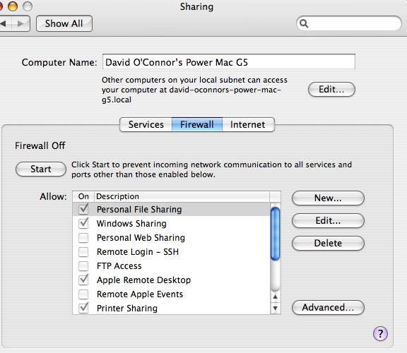

And, if you're using OS X's built-in firewall (located in System Preferences -> Sharing -> Firewall), turn it off.

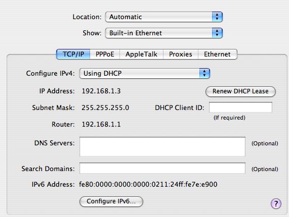

I believe l have a Broadband connection. I connect using a Nokia DSL modem (router?)
In System Preferences -> Network->Network status, It says:
"Built-in Ethernet is currently active and has the IP address: 192.168.1.3. you are currently connected to the Internet via built-in Ethernet"
when I go to the show built-in Ethernet screen, under the TCP/IP tab it shows:
attachment.php
Hopefully this is the info you need.

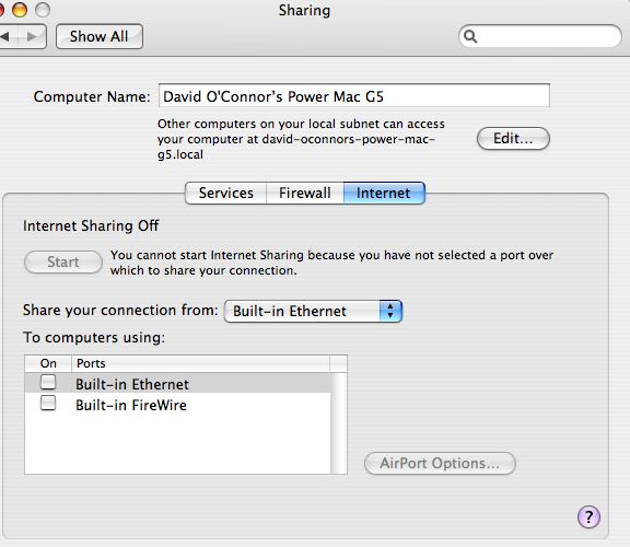

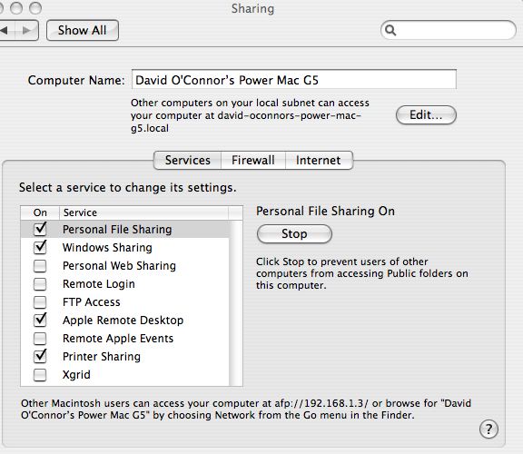

some more
Yo,
I thought these shots might be important also:
attachment.php
attachment.php
attachment.php

Forward ports 6881 - 6889 (the manual seems to call these "pinholes") to the IP you see in system preferences (which looks like 192.168.1.3 from the pictures you posted)

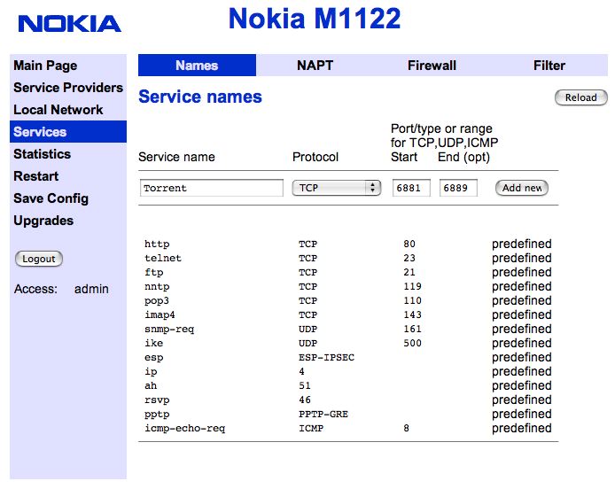

Go to http://192.168.1.1
Click on Services, and make sure that Names is highlighted.
Enter something like Torrent for the name. The protocol should be TCP and UDP and then plug in the starting & ending port ranges.
Click on Add New.
This will define these ports in the modem.

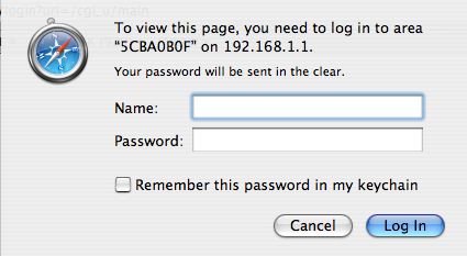

Okay this looks challenging...
clicked on the link and oops:
attachment.php
Not sure what to put here. Tried my username and password but no joy ...?
:confused:

I'm checking out page 66 in the user manual. Looks like if one hasn't been established, a password is still requested but not required.
Are you able to login without entering a username & password? Give it a try... Leave the username & password blank & try logging in.
stage 1-success
I actually tried to login without entering a username & password already
but I just tried again and and lm in!
odd... anyway, l shall continue on

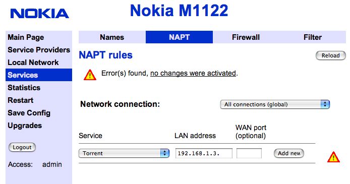

ok l followed your instructions and have got an error message,
1."Click on Services, and make sure that Names is highlighted.
Click on Add New.
This will define these ports in the modem."
did that.
attachment.php

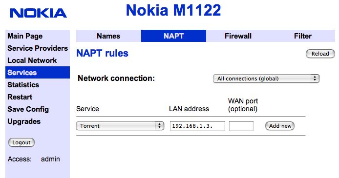

"Then, move along to NAPT and select the service name you created earlier from the Service pop-up menu.
Plug in the IP address of your computer into the LAN address field (the IP address you saw in System Preferences: 192.168.1.3.) Leave WAN port empty."
https://forums.macrumors.com/attachment.php?attachmentid=35133&stc=1&d=1132550731
did that.
Then when I Click Add New, l get:
https://forums.macrumors.com/attachment.php?attachmentid=35134&stc=1&d=1132550731
Im doing something wrong ... :eek:

There is a dot at the end of the IP address and there shouldn't be. Should be just 192.168.1.3 with no period at the end.

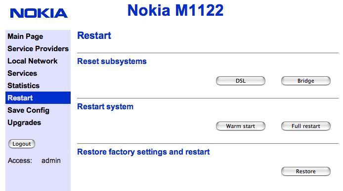

which Restart button? DSL?

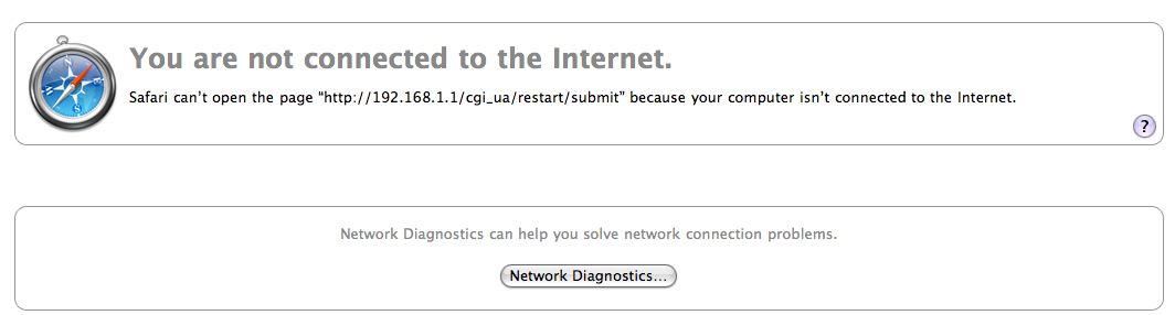

I clicked on Full Restart and got the following:
https://forums.macrumors.com/attachment.php?attachmentid=35168&stc=1&d=1132601324
I went through the Network diagnostics, it does some scanning, and eventually says my connection is ok.

Yeah; you would have lost your internet connection for a few moments while the modem restarted. Shortly thereafter it should have come back up online. Has that happened yet?
Yes
indeed, my internet connection, seems to be functioning okay soon after.
