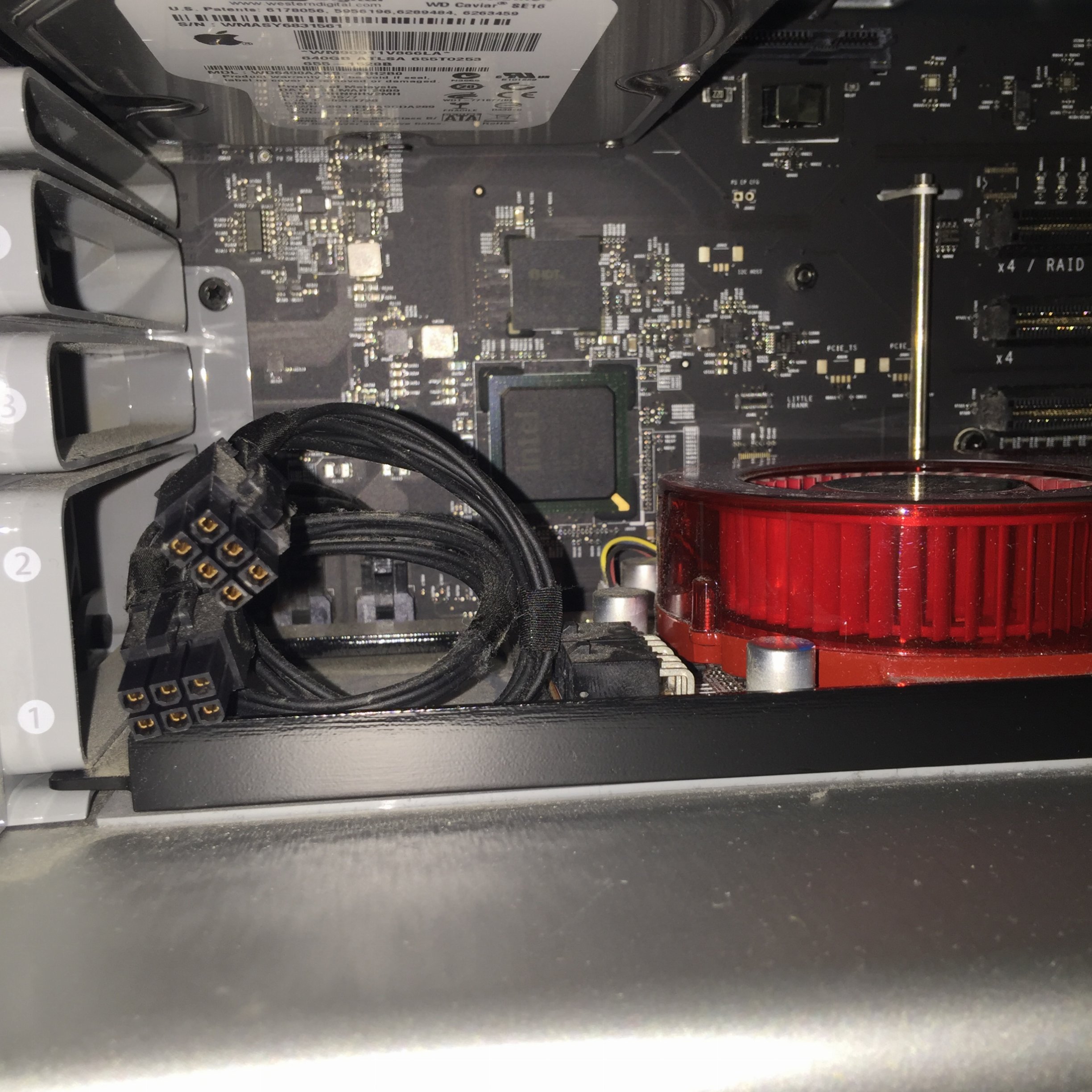

Okay so I opened up my mac pro, and I realized there's 2 of these 6 pin things. And I tried connecting it to the 960, and it fits. Am I missing something here? Do I still need those power cables?
Yes. Either of those cables will work. We didn't know your current video card had these.
