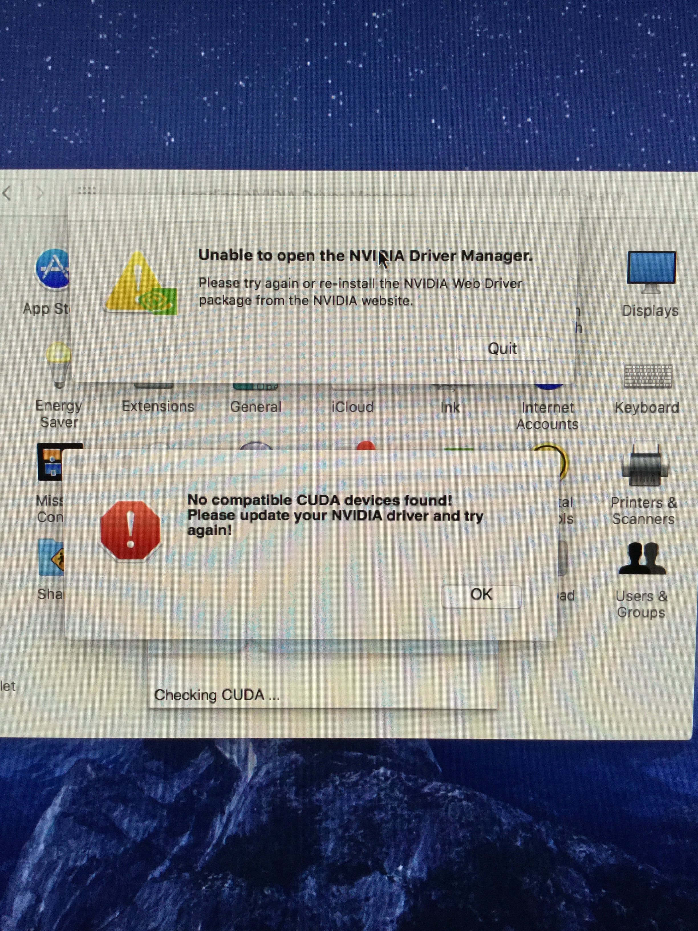

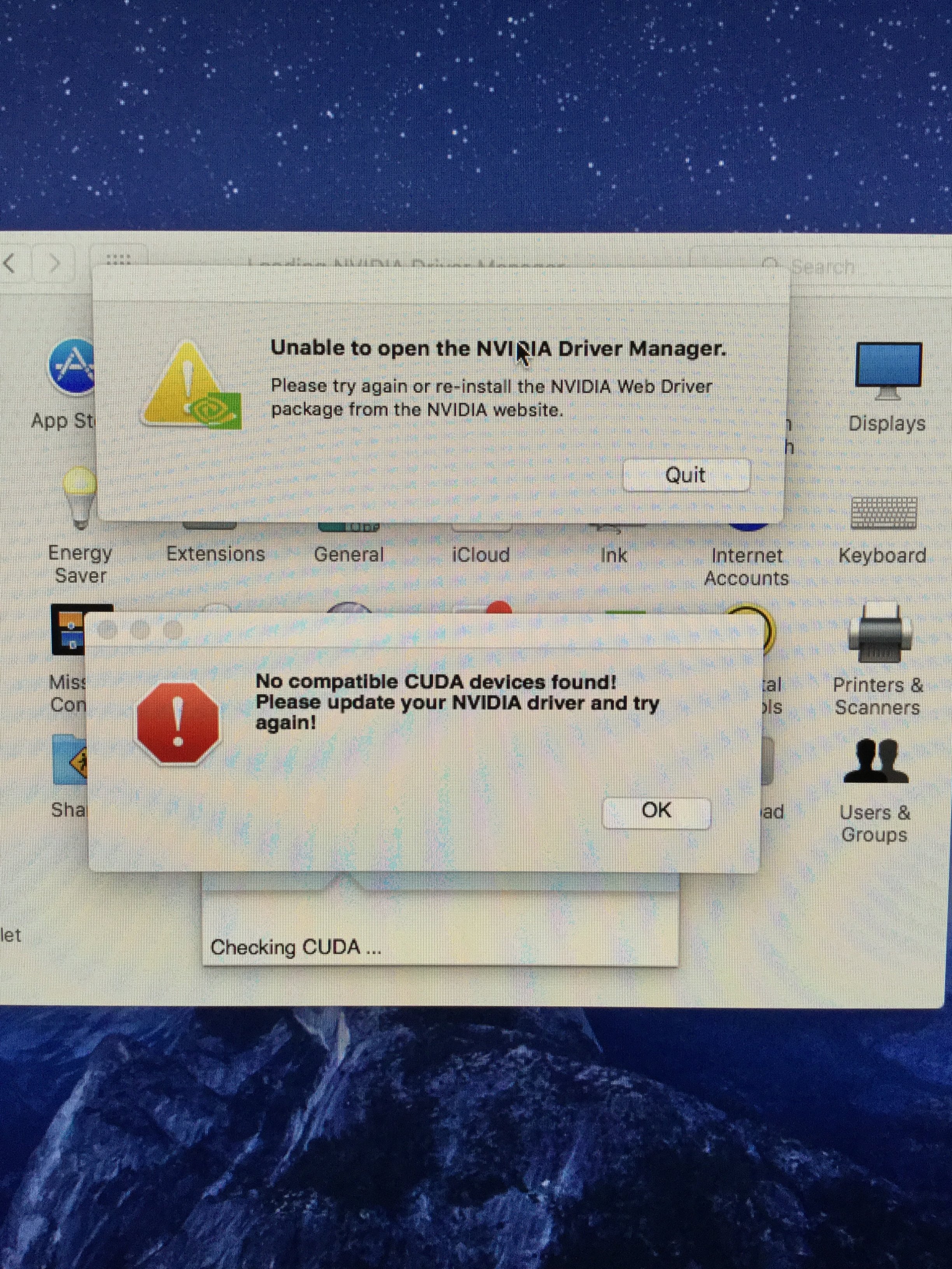

Because the Nvidia Driver Manager doesn't load properly sometimes in El Capitan, CUDA may not work either.

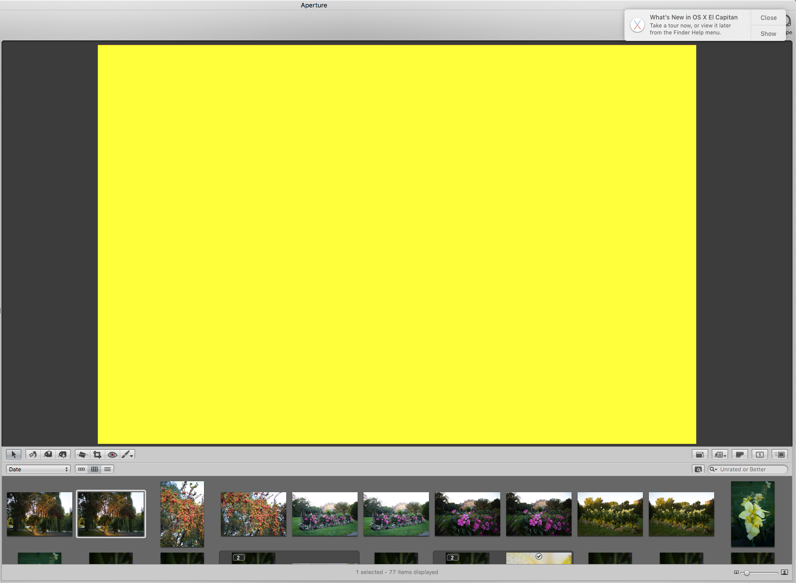

I am working a flashed Titan Black Super in Mac OS 10.11.1 While the Apple NVIDIA driver doesn't seem to be able to boot from it as I get a black screen with progress bar that goes half way and I waited a few mins to see if it will progress further but it doesn't seems to.
Using the NVIDIA Web driver for Mac OS 10.11.1 will enable regular boot completion. However I encounter a 'Yellow' picture when using Apple Aperture. This had also occurred with the last iteration of driver for Mac OS 10.11 El Capitan.
Prior to this, Yosemite (10.10.5) did not have this 'Yellow' picture issue in Apple Aperture. Anyone else here use Apple Aperture? On a side note (less serious issue), DxO Optics Pro 10 show artifacts rendering and when changing windows...
Any insights anyone?
[Screen Shot of 'Yellow' picture issue in Apple Aperture attached]

Same here
GM Candidate and Beta Driver fine
GM and Beta Driver fine
GM and both drivers yellow box
10.11.1 and current drivers yellow box
I have Pixalmator on my system and when I try their photos extension I get a yellow box too.
I tried hacking the beta driver to work on 10.11.1 with no success yet.

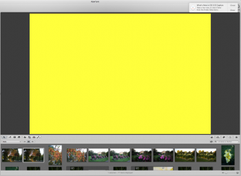

Yes, the yellow screen with Aperture has been widely reported, hopefully NVIDIA will deliver a fix for it soon.
I have submitted a Bug Report to NVIDIA since 10.11. Despite not having any feedback from them, I am hoping that there is ongoing work on a fix (soon too). I do suggest everyone affected to submit a Bug Report to NVIDIA as well.

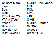

I'm experiencing unsolved problem trying to install a non-EFI GTX 980Ti in my 2009 Mac Pro with Yosemite 10.10.5
I of course installed the latest WebDriver 346.02.03f01.
All I get is a black screen.
I have tried several processes, thanx to all the info I got here :
- Uninstalled the previous Nvidia Driver and Cuda Driver
- Booted using a GT120
- Did the "nv_disable=1" trick described in point 24) of the first post of the thread
- Tried to uninstall and re-install the driver using a AMD card
- Reseted NVRAM
- Followed what was described in this thread by DMCDesign, using my AMD card
Well, after a whole day of trying different solutions, I still have the same result: black screen from the 980 Ti
(I have only connected my screen to the DVI port as I don't have any Displayport adaptator at the moment)
The 980Ti is plugged via two cables from the motherboard, one is a 6-Pin, one is a 6-to-8-Pin.
The card green letters lighting is working
In system info, the card appears as NVIDIA Chip Model with... 256 Mo of VRAM (!!)
In NVIDIA Driver MAnager, the slot where the card is says pci10de,fb0
(well actually it's very strange, as the GT120 is in slot 1 but presented in the manager as in slot 3, and same vice-versa with slot 3 where is the 980Ti)
Here is my setup :
Mac Pro 2009 4,1 upgraded to 5,1 / 12X3,46
OS X 10.10.5
Apple HD Displays 30" / 23"
EVGA Standard GTX 980Ti
I have an extra GT120, a GTX 480 from Macvidcards, and another Radeon, if that can help for a process..
I really don't know what to do now, if someone has encountered the same issue and found a way out, please let me know, thanx!
- Reseted NVRAM
Here is my setup :
OS X 10.10.5
Well after a new Clean install of Yosemite 10.10.5 and several test with different procedures, exactly same result: Black Screen from GTX 980Ti, and card doesn't seem to be recognized properly by the system. Could it be a card issue?
